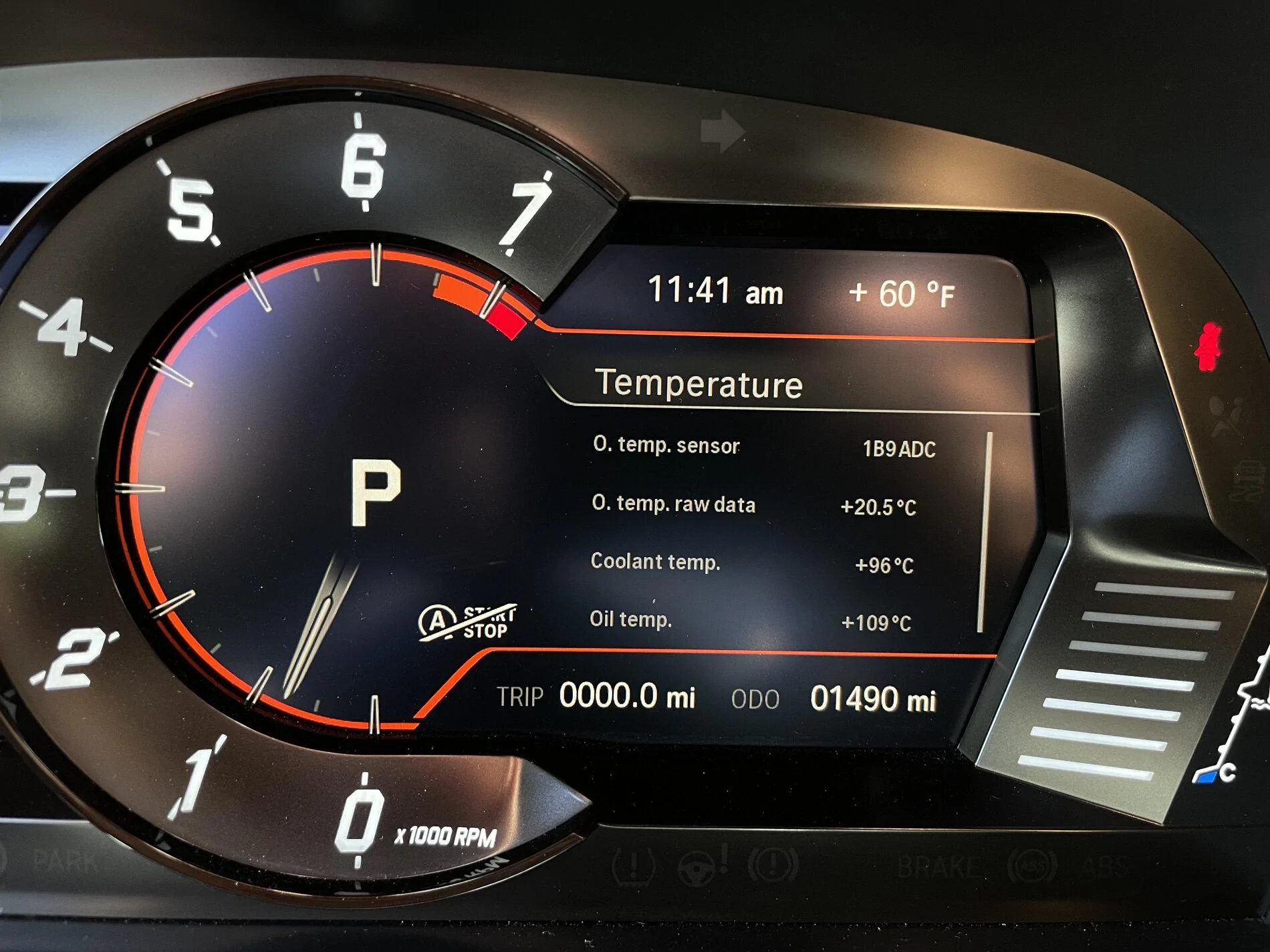

One thing I do wish car manufacturers would do is have all information for pressure and temps that technicians would use be available on the infotainment center. Cat does this with their VIMS and it works amazing. The hidden gauges are a joke at best for this car.
absolutely. like the temperature menu hidden on a performance car? come on. Some OEMs do it right but I'm seeing a particularly poor level of transparency from BMW.
