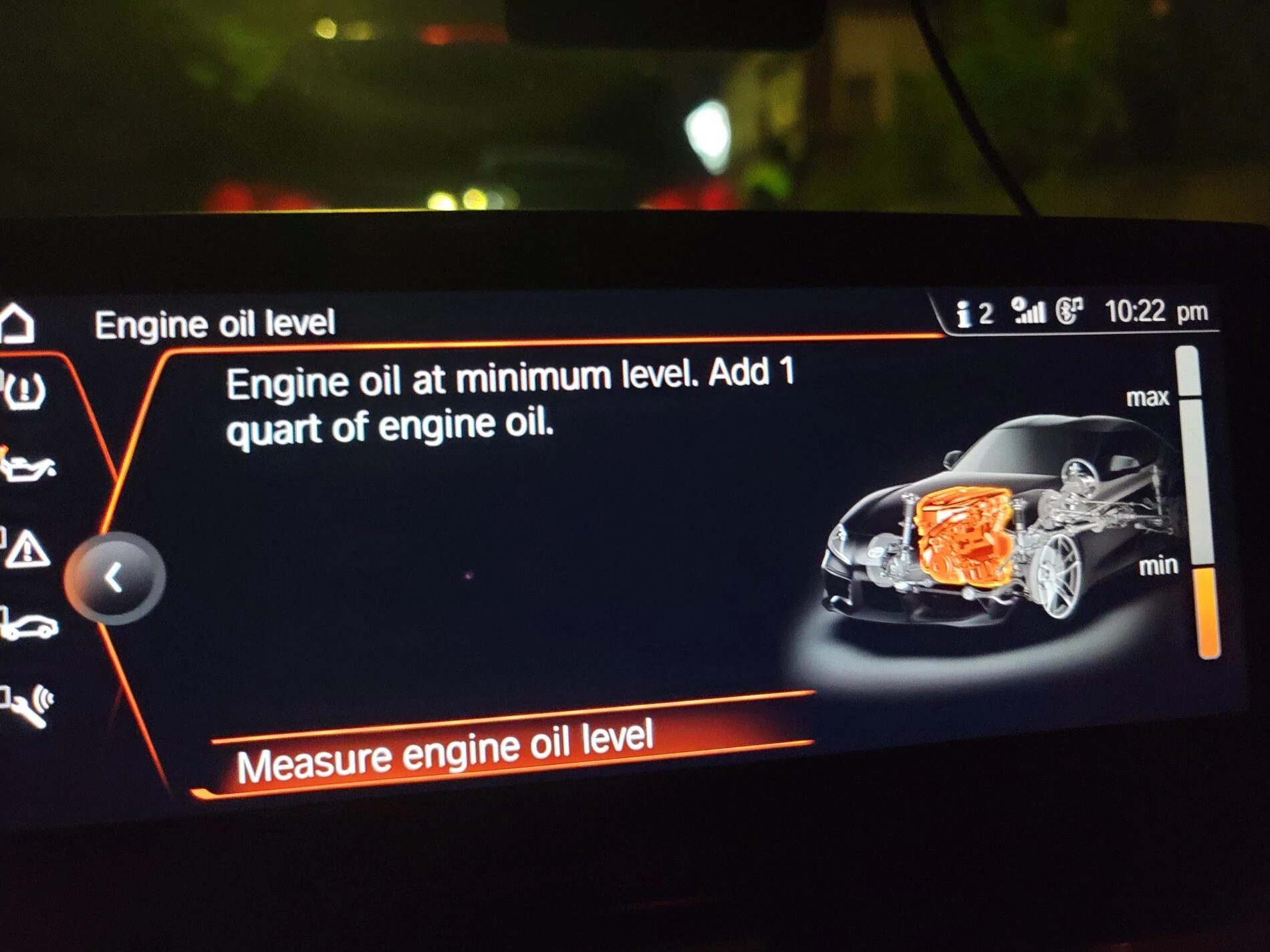

Got the supra in at the dealer today and they are checking into the oil consumption. They actually brought it up first because I brought it in at 5400 miles for an oil change and not at 10k, and the guy mentioned that there were some issues on some Supras that he was going to have the car checked out for.
For reference, I had to add a quart at 3600 miles, and a second quart at 5100. I decided to bring it in to the dealer for one of those 2 free oil changes, and have them check in on it while it was there. The car is stock other than an MST intake and inlet pipe but that was installed after the first low oil notification around 4300 miles.

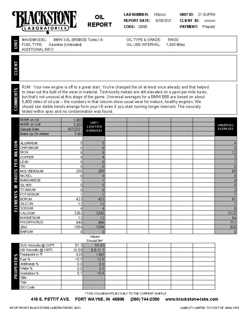

I recommend everyone do a Blackstone oil analysis at every oil change. For just $30 it can offer a wealth of data about your engine. The analysis can be used for early detection on catastrophic failure. Or just peace of mind that everything is OK.
Here is my report for 5w-30 oil after 1800 miles on a 91 octane tune. The oil sample was taken at 3000 total miles. No excessive oil consumption to date.
-RJM
+1 for UOA. I've been using Blackstone for a while but thinking of switching to SpeedDiagnostix. Blackstone is good to track UOA but they base it upon universal averages and not car specific applications.
https://lnengineering.com/products/speediagnostix-used-oil-analysis.html?limit=5&mode=list&p=2
Interesting - I thought I was a universal average for your engine type ("universal" across makes and models that use that engine) and not across all motor oil they analyze full stop.

I’m an unfortunate addition to this thread. My car was doing ok up until I added a big turbo set up at 1800 miles. Now 300 miles later I’m 1/4 away from the minimum mark. Going to add some more oil and keep monitoring as time goes on. Fortunately I don’t daily drive it and do plan on building the motor one day so it’s not the end of the world.
My car is an tuneable 2021
EDIT: my car is not burning oil. My tuner told me he added oil after he lost some out the ccv on dyno (before catch can put on) and that it was full when I left shop. Ever since I made this post my oil level has not dropped. That’s a few hundred miles and racing, it seems like more oil was never added, so disregard my post.

In my opinion I dont think the big turbo is the catalyst here. My consumption issues started at 25XX miles (stock), so your not far off mileage wise. Lets hope these motors are not oil guzzlers, only time will tell.
