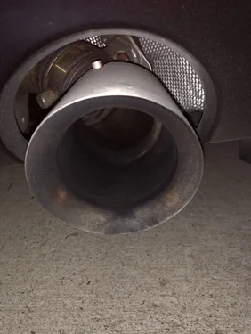

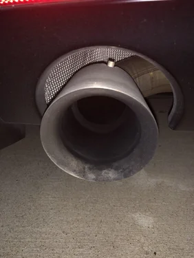

FWIW I’ve never cleaned my tail pipes in the last 2200 miles and they look like this. Just recently started seeing more black soot buildup. I assume this is normal? What do yours look like?

8,472
14,121
That seems pretty normal.
