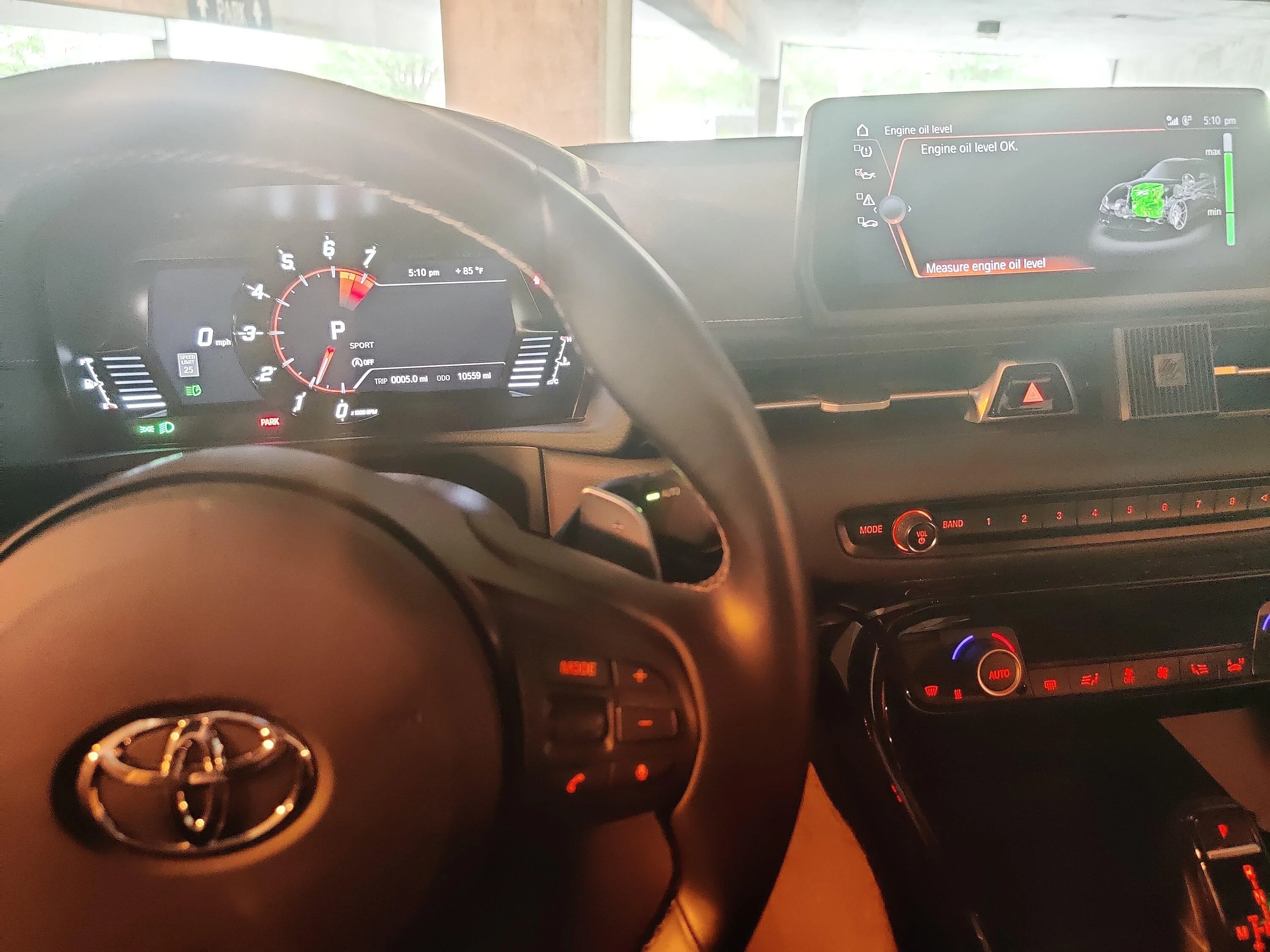

Update with my ‘22.
seems the sensor was at fault. Would get random readings .. would read full, then 3/4 full then 1/2 full all in about 30 min drive.
showed the Supra tech after he told me he can’t fill the oil when it is full.
he was surprised.
Toyota replaced the sensor and so far so good.

Many cases of oil use being the sensor. This is a non issue in the larger sense here in Europe. Its just not a big deal. Not enough for people to think the car is simply going to nuke itself at all.
Forums are full issues-- in reality there is NOT a large one. 2 cases on the forum equals the world is ending. Typical LOL.

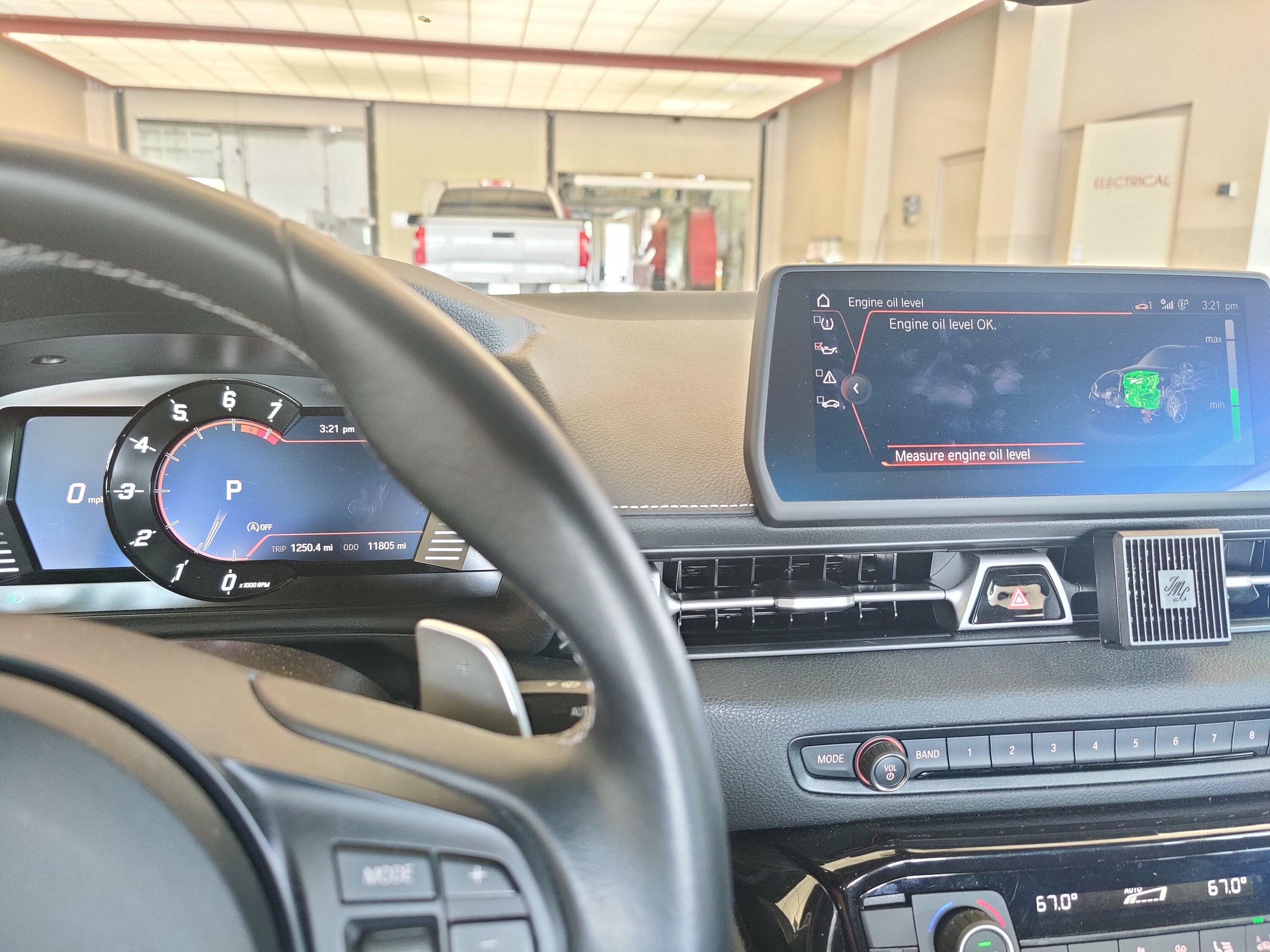

Hello folks , update for my situation,
Had low oil warning again at 11,500 miles , they said it was nothing again.
Had low oil warning again at 12,900 miles and this time I took it in (was going to go anyways for an oil change). They said when they went to do the oil change there was oil all under the car (?). They said they were gonna have a master tech look at it.
Today they called back and said that they put some oil with dye to try to find a leak, and it ended up being the transmission cooler (how does oil get there? Or is it just making things hot and oil is burning up?). Ordered part but have no say in when it will come in, and it’s under warranty.
has anyone heard of something like this?Just seemed odd to me cause I haven’t seen or heard of this being an issue
Alright, the final update on this, the dealer and manufacturer asked me to do an oil consumption test. After around 1250 miles, the oil level shown on the screen dropped from max to 1/4 topper than the min. The Toyota manufacturer said the consumption is reasonable, which sounds ridiculous to me - Adding oil every 2000 miles for a one-year car, which has not been used for autocross, racing, or drifting is normal? btw, for the daily drive, I did not go fierce at all.
I gonna trade this car anyhow. Extremely disappointed with Toyota, farewell JDM.
