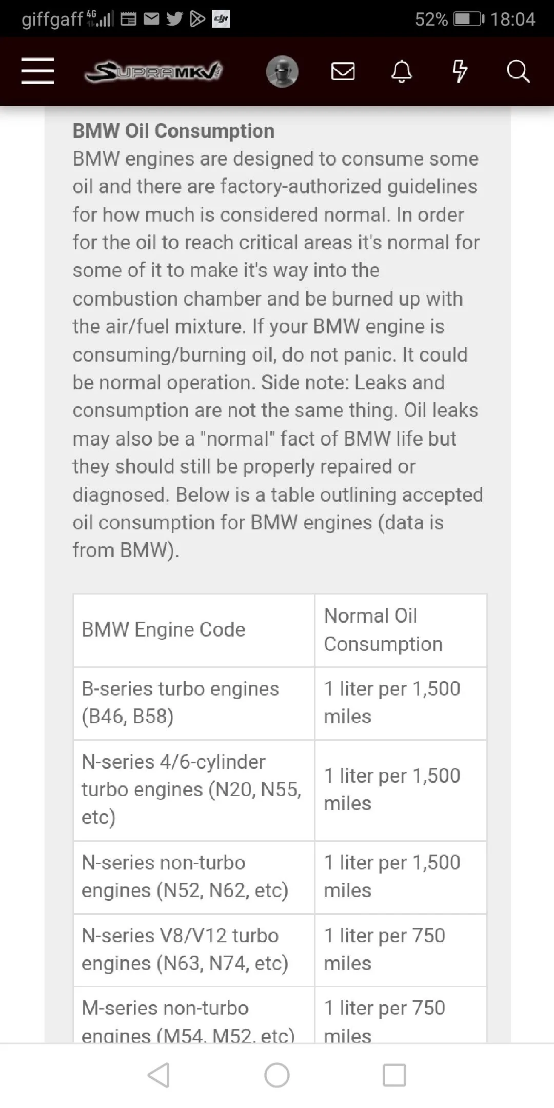

Hi Guys
My 2020 Supra as used half a quart in 2,500 miles..is that anything to worry about?
Thanks in advance.

Howdy mate
Seems like slightly too much IMO, if that was normal that would mean like over 1 litre of oil consumption in 6k/7k ish miles which is roughly a regular service interval, hence why I think it seems excessive perhaps.
Will let the more experienced b58 gurus here chime in - from what I read, 2021s seem to be the most likely to have excessive oil consumption shenanigans.
Is it stock? Any track use? I expect these questions might help get more reliable answers ?

Found this...put my mind at rest somewhat.
Howdy mate
Found this... that's put my mind at rest somewhat
Found this.. that's put my mind at rest somewhat ?

Hi Guys
Thanks in advance.
BMW states it's normal to need a top off after 1000-1200 miles, dependent on driving style, iirc. I've had oil consumption a couple of times, but I just top it off and move on. I'm going by the BMW manual where it's not this crazy scary broken pos thing, or w/e. BMW says it's normal to see it.
What I can't explain is why some do and some don't. I've seen theories, but nothing definitive, and I don't expect it.
Have they added anything to the new user manuals? I'd think after a couple of "lemons" (or wasted Supras) they would update the manuals or something.
