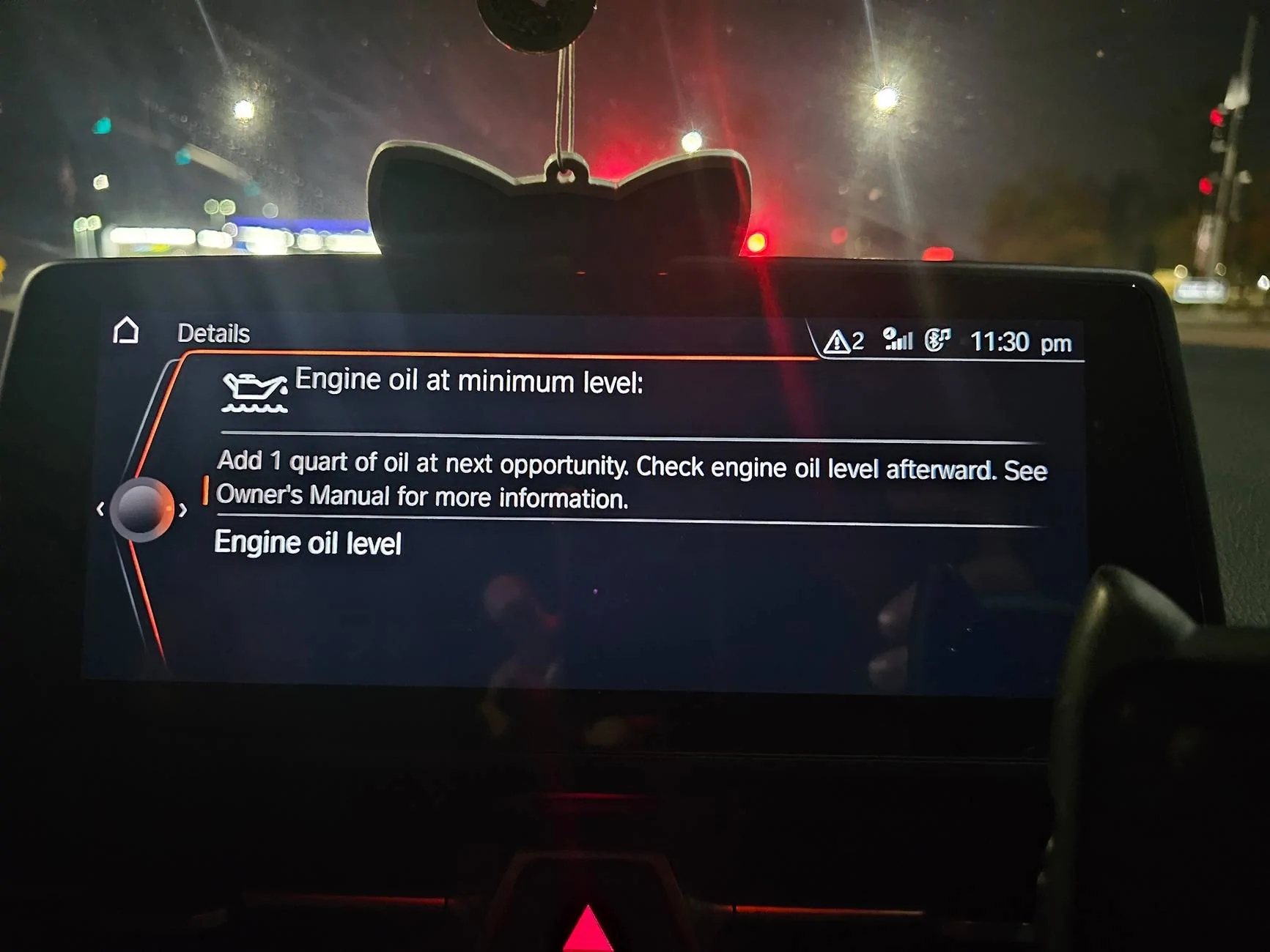

21' with about 48k miles, msi intake (installed at 40kish), with no other performance mods on stock oil.
Got a low oil warning at 38/39k miles (last service prior to that was at 30k miles around december 2023) and now I got another low oil warning again at 48k. I also had an issue with coolant being low in the last 20k miles (not sure if this is relevant). I don't track the car but do go for spirited drives sometimes and I have noticed a burnt oil smell recently when pushing hard. Should I be worried at all? I would be fine with adding a few quarts every 7 or 8k miles but I am worried that there's a bigger issue. Any suggestions would be cool.
ps - I wasn't able to measure the oil level but I'm guess that's because the oil temp was too high.

Lmao not sure if you're serious or not with your response but w/e. For those of you actually looking for info...
Had the oil control module (not sure of the exact name) changed a few months ago because the car was unable to measure oil for the consumption test (I guess they don't take all the oil out and do a measurement for whatever reason) so I brought the car back for a follow up consumption test and they were unable to measure the oil again. SO, it looks like they're going to replace the oil pump, pistons, and piston rings to resolve the issues they are seeing under warrant.
