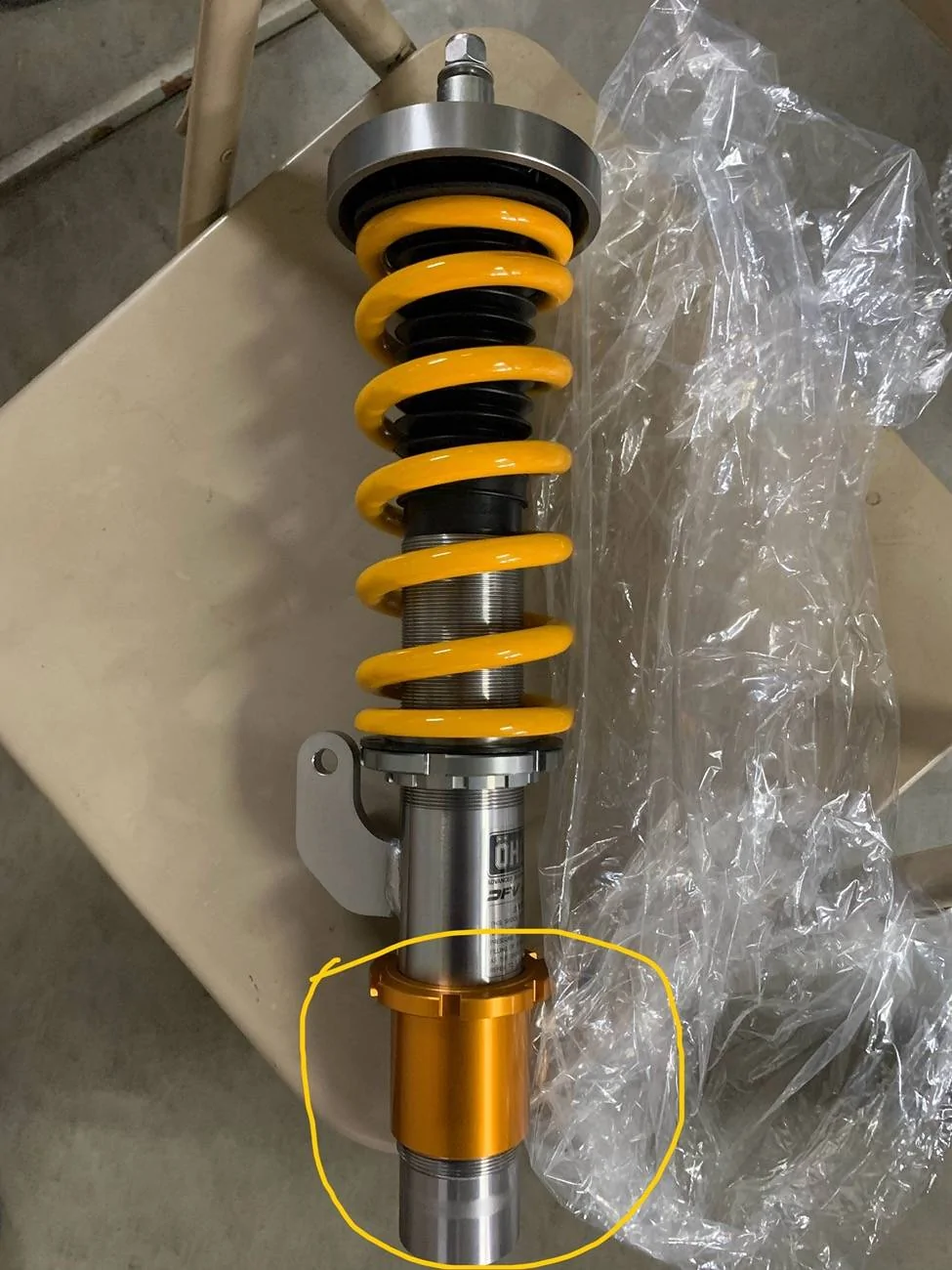

Hi Everyone! I finally made the decision to purchase a set of Öhlins. They look amazing and I’m excited to get these installed.
While I was reading the provided install instructions, I noticed that Ohlins provides measurements for their ideal ride height.
I was wondering what would happen if I installed the bottom height adjuster to the max as pictured? Does the car go lower than the recommended 15-20mm? Or does the sway bar endlinks prevent it from adjusting lower? For reference, I am going to use stock top hats and oem endlinks.
Thats how mine are installed as well as basically zero preload on the spring. But take that with a grain of salt since I am using the Verus top hats. Ride height may vary. My car is about 1/2" lower than stock with those settings.
Congrats ? and make sure you make adjustments according to tire rub (excessive wear), depending on your wheel, tire size & brand and how the car feels. My alignment & height were adjusted a few times along the way as I got more comfortable. The faster I went the greater wiggle room I needed. Sean’s advice has always been solid and would be a great place to start.
