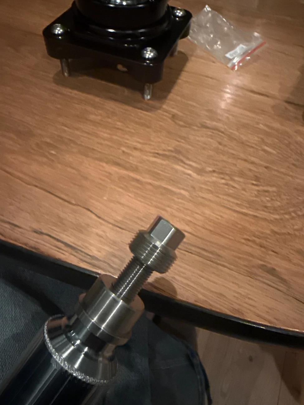

Were there any modifications needed other than the shorter steel bushing ? I’m trying to install my ohlins w the verus camber plates, but the bushing lock nut in the front doesn’t want to thread on.

Hm, interesting. The nut seen at the top of the threaded section in this photo will not thread on. Am I doing something wrong here?

Ya, spacer goes on top. Slide camber plate on then drop the spacer in it. I also dont remember using that nut. I just used a normal looking one.

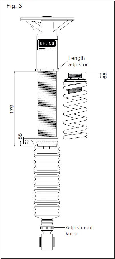

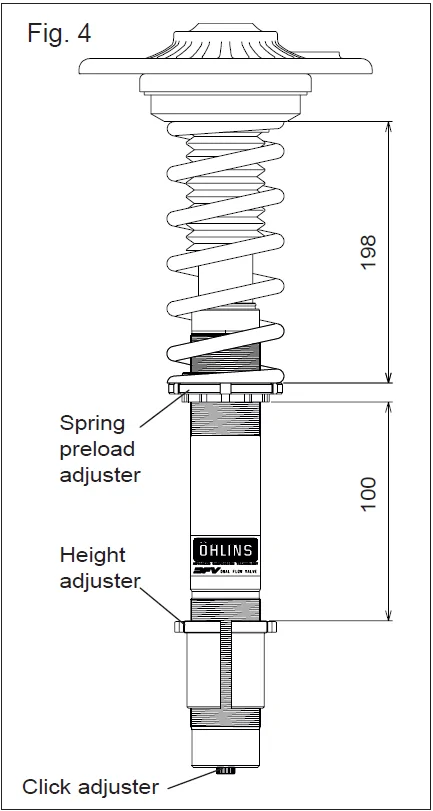

I am going to install the ohlins suspension with OEM top hats and want to keep the ride height as close to stock as possible. What adjustments do I need to make to the mounting instructions to land at the stock ride height front and rear.
