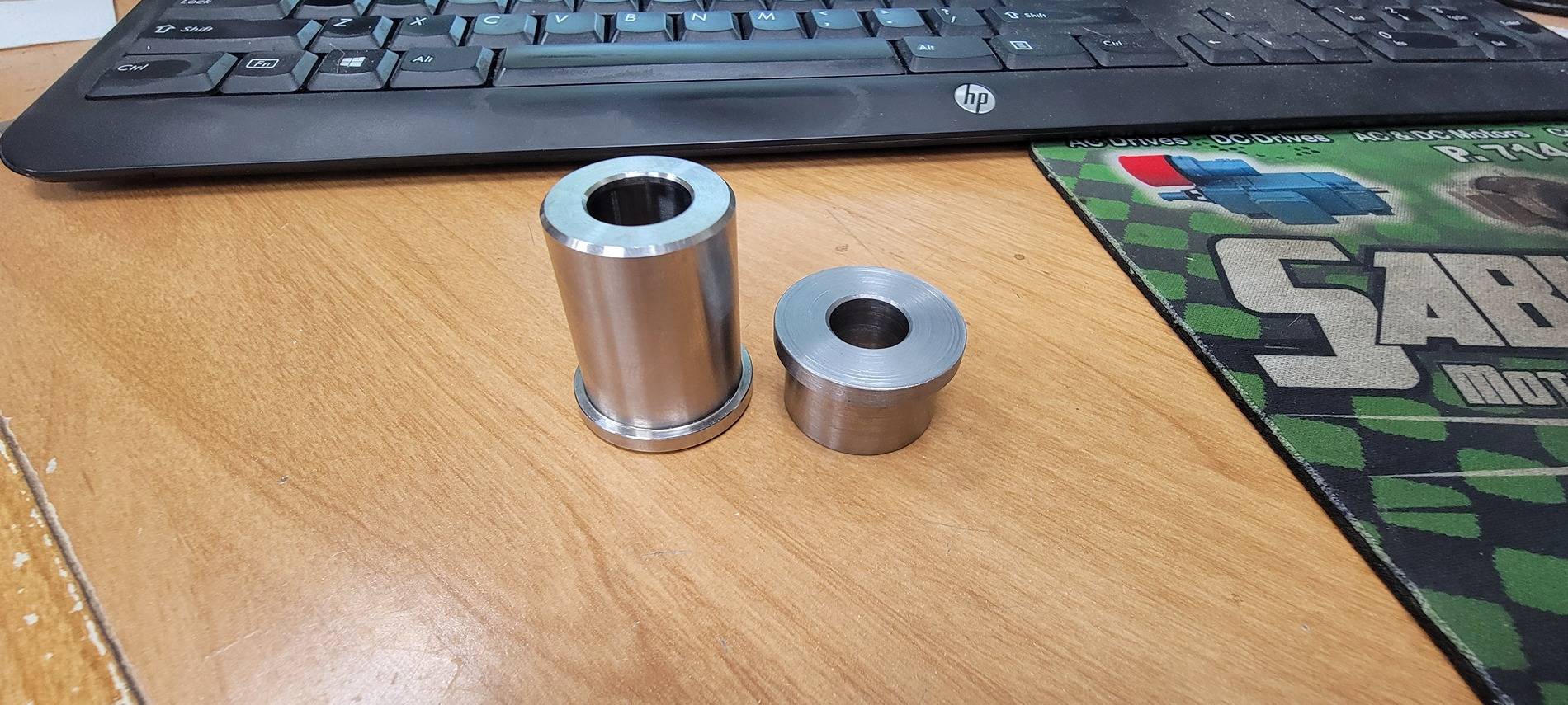

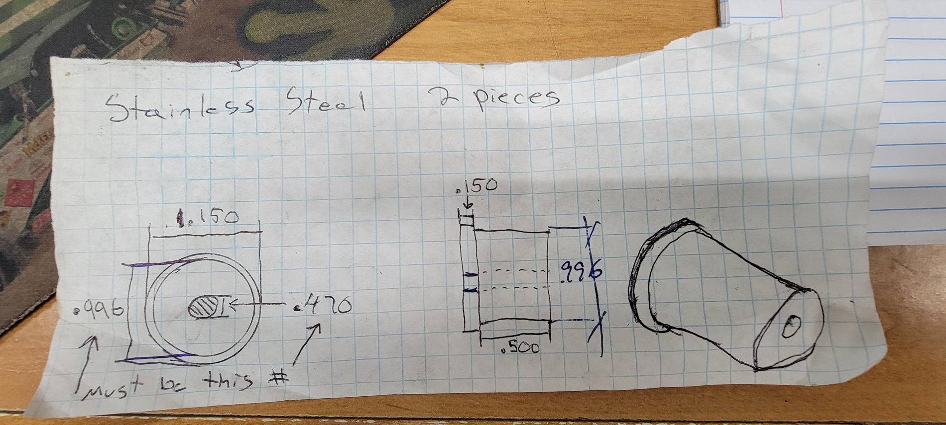

If only people knew how easy it is to make the Verus ones work....
Here you go peeps. Take this to your local machine shop and have them whip out a pair.
Old on left, new on right.
