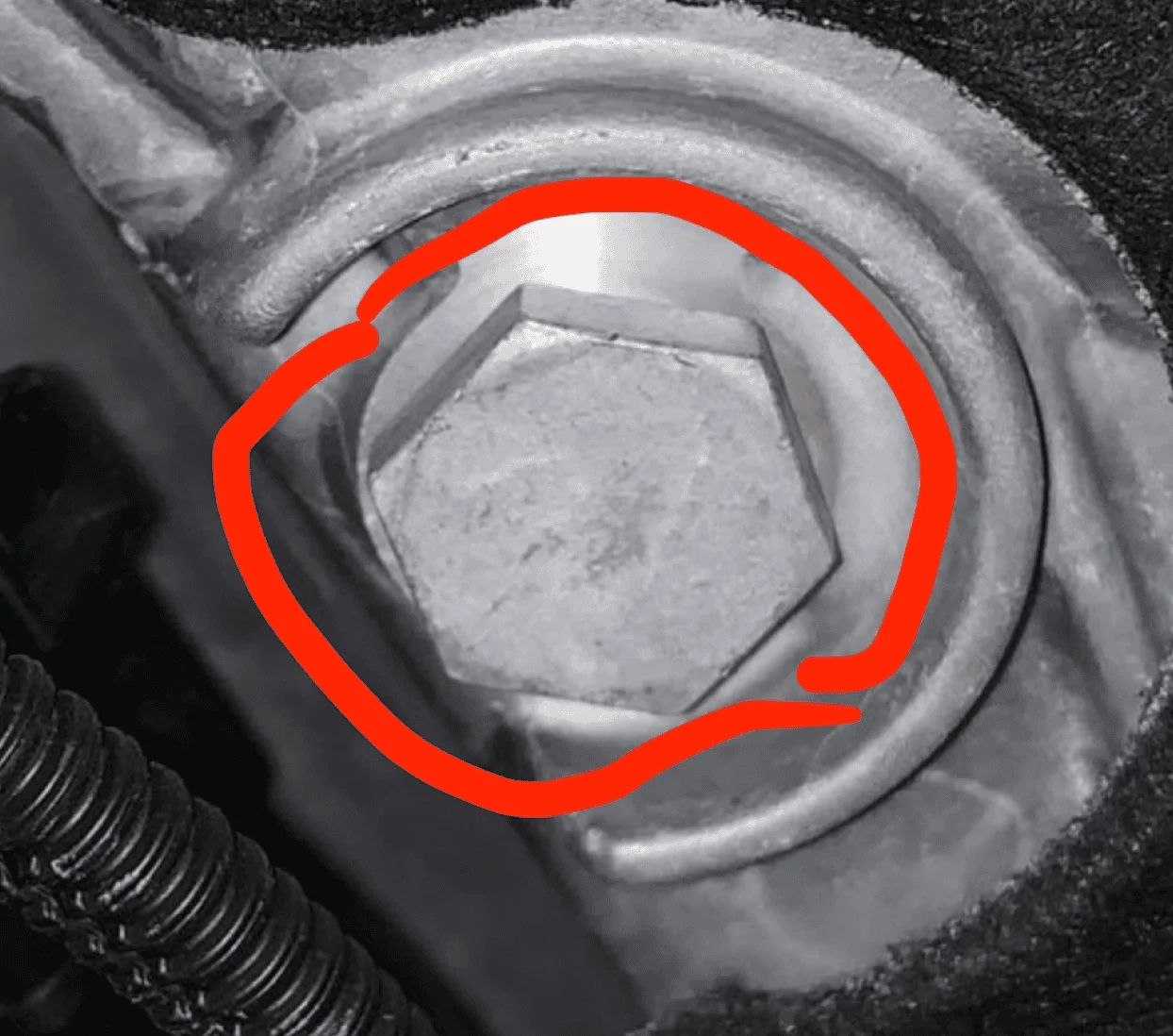

Does anyone know whether Fumoto offers a valve for the Supra? My WRX has a vertically mounted plug as well and it can become pretty messy when removing the plug. Since the Supra does not have a dipstick I cannot extract the oil from the top.. therefore, I'd like to install a Fumoto valve (as I do most of my cars) when I do the first oil change. TIA

I guess they do... but this red area is recessed, correct? Then the valve will not fit.
Need to take Fumoto's compatibility matrix with a grain of salt as it only looks at the thread diameter and pitch. I've had an issue on my other car (Ford Fiesta ST) where they said it fits, but did not because of the surrounding oil pan how it is shaped. But on that car the plug removes horizontally so less chance for splash.

Anyway, when I do the Supra's oil change next Spring, I'll do a reverse funnel thingie with masking tape to prevent oil spill/splash above the lower shroud before removing the plug.

You just Need the size and fumoto support will tell you what styles are available.
Be warned, it is going to stick straight down and you do not have that much room before you hit the plastic cover. The red area is not really recessed, rather, there is a lip that goes around. You can see how the red area and the area on the other side of the lip are kind of in line. The bolt head is pretty shallow.

Natek - Fumoto valve's open/close lever is on a 90 degree angle that sticks out pretty far; and how the drain hole is recessed inside the lip (the red circle I drew above) I don't think the Fumoto will even fit on the car. I mean it's only $25 so I can give it a shot and toss it in my parts bin if it doesn't fit, but better if there is another valve that is known to fit properly.
As for the Supra not having a dip stick, the more reason why I want to install the controlled drain on the bottom. Had it had a dip stick, I can just extract excess oil out through the dip stick tube. I've done that on my other cars for overfill and full oil service. I'd never have to remove anything from under the car in this case as the filter was accessible from the engine bay on this particular car.
Again, not that this is a big deal or anything.. just something to make our lives easier.

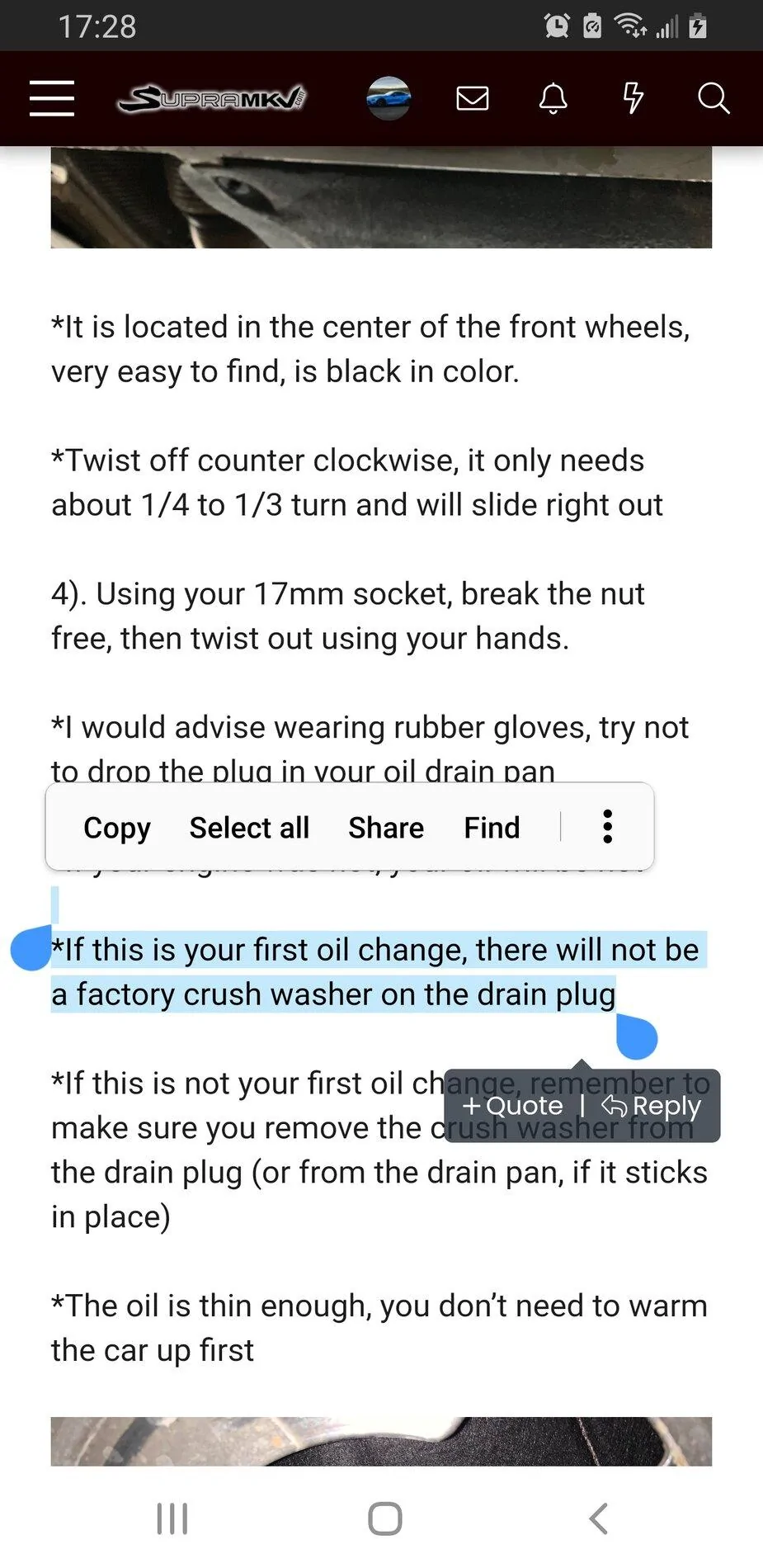

My LE car didn't come with the washer. Luckily replacement did.
