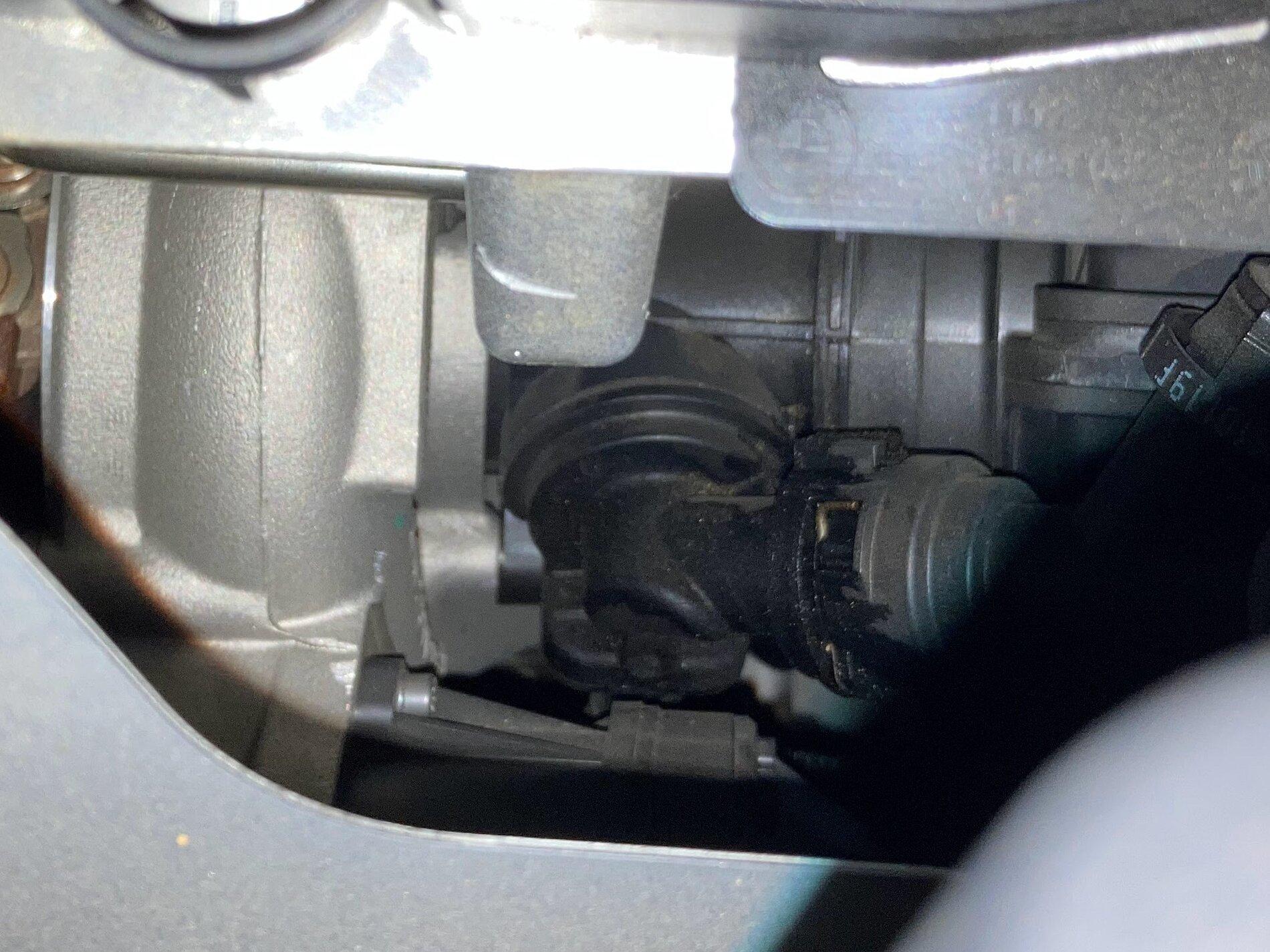

I opened the hood today and noticed that there were some oil seepage near the turbo unit, see the attached picture. Is that the PCV line? I understand this engine might burns a bit oil but seeing oil out of the PCV line is a bit surprising. The car is a 2020 3.0, no tune. Any suggestions?

PCV and CCV oil contamination is common in any car, but especially boosted GDi cars.

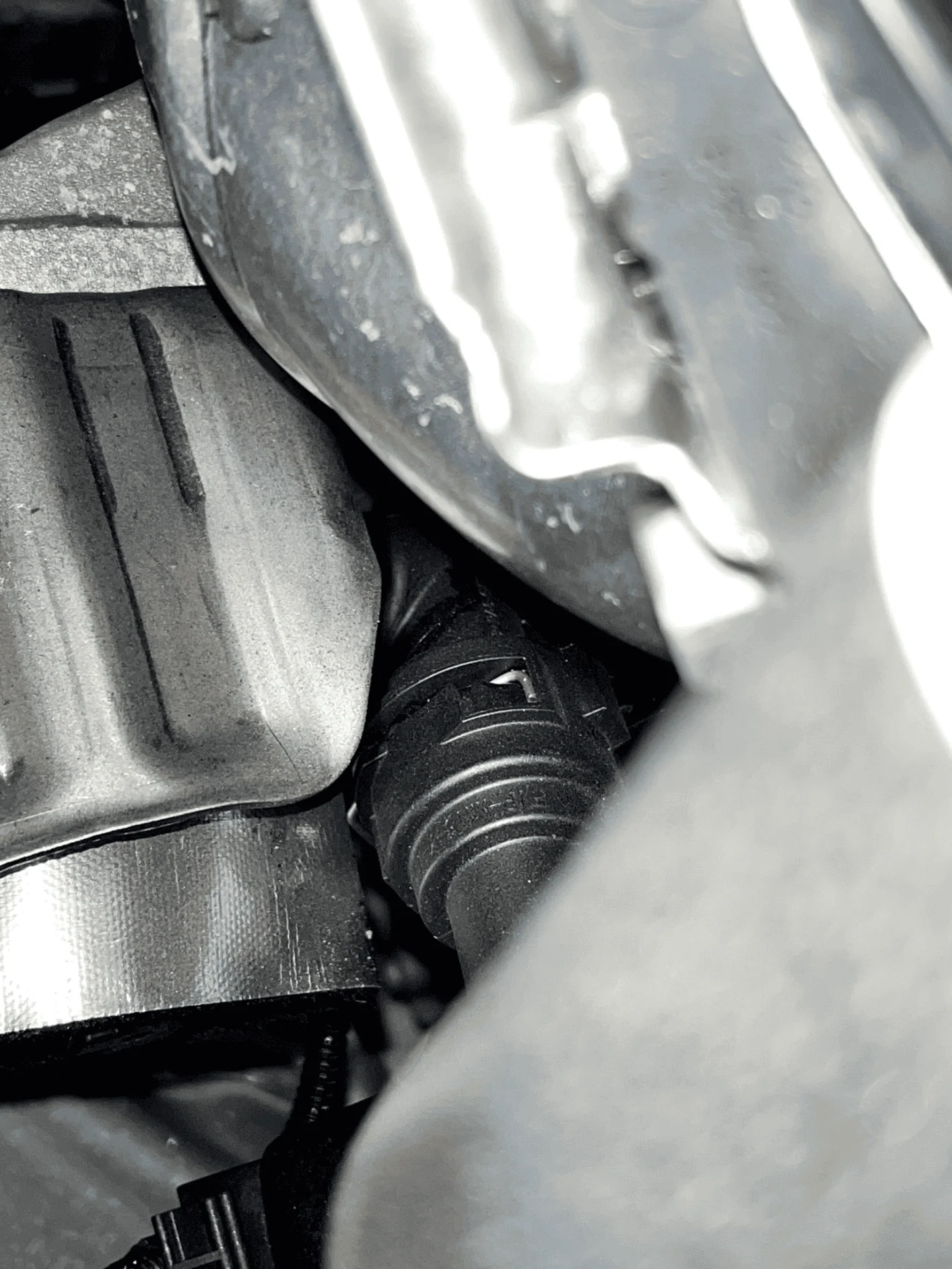

I have a 2021 and it looks like I have more crap in that area of the engine than you do (perhaps the different port design from the 2020), but I can visually tell you that mine has oil residue in a similar area to yours (about half the amount).
