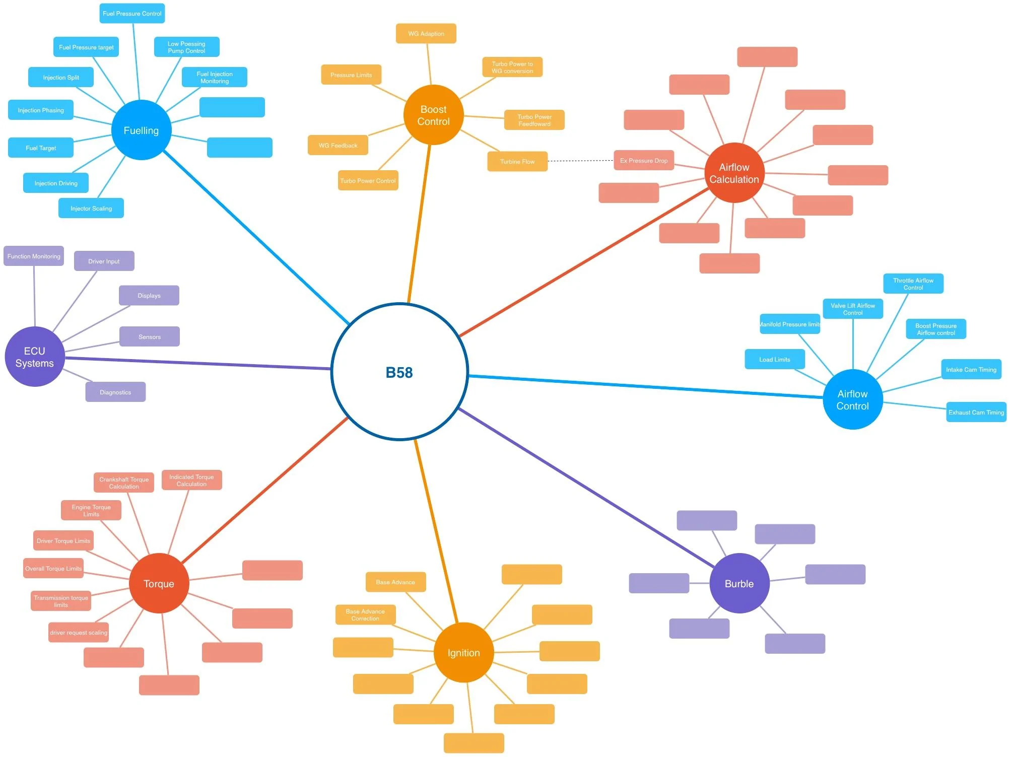

Ecutek is the way.
With all the good mods you're adding it will give you max tunability.
-RJM
FYI, That’s just a diagram of the ecu systems and controls. Not ecutek centric.
