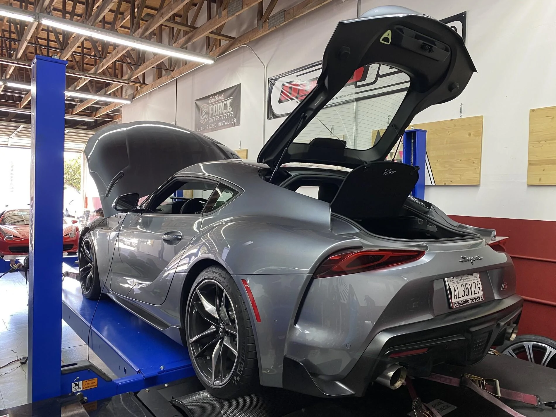

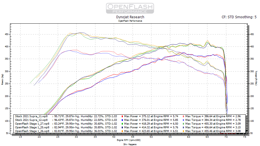

Greetings! We are close to wrapping up our Stage 1 calibration for the 2021 Supra. Our test car is 100% stock with the except of our ECU flash. Running on 91oct Shell gasoline. Purposely limiting torque to ~450lbft for the purpose of drivability. But this can be adjusted upwards easily if the customer wishes. Power delivery is nice and consistent. Partial throttle boost isn't jumpy or uneven. It just drives like a useable sports car that just happens to make nearly 425whp. All pulls done in 5th gear in dyno mode. I suspect we will be done with our Stage 1 gasoline tune in the next couple off weeks. Then we will be wrap up the E40 calibration and show the results
Stock tune vs OpenFlash Stage 1 (91oct)
