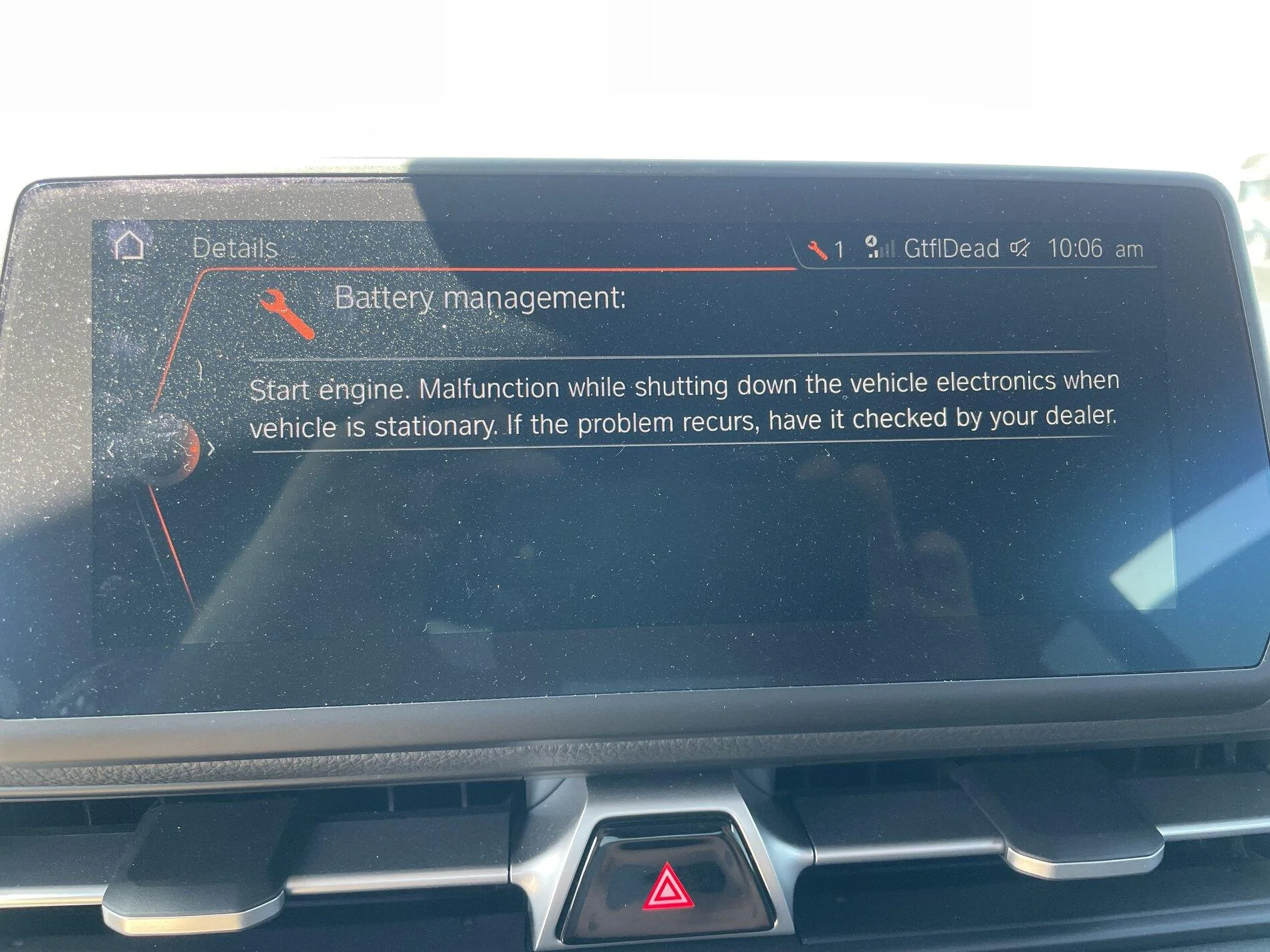

Mine still does it. I can replicate it easily. Mentioned it to the dealer last time the car was in. they ignored it. Really annoys me but the thought of dealing with Toyota on it annoys me more. It's definitely software. Every time it does it, the car does not remember my last climate control setting and reverts back to the ODO from MPG on the dash.

I’ve heard that from others with this issue. I’d buy that explanation if both wipers twitched but only the passenger side does on mine. Also, it’s not consistent. As well, i have been able to correlate the issue to the car not remembering certain settings at shut down (HVAC, radio, mpg/odo). Also, the duration and severity of the twitch varies along with the electronics error that I get on a regular basis.
This is definitely a software issue at least with my car. I’m going in this week to get my dealer to update my I-level to the latest 21-03-5xx version. From what I’ve read from others this should take care of the issue.
