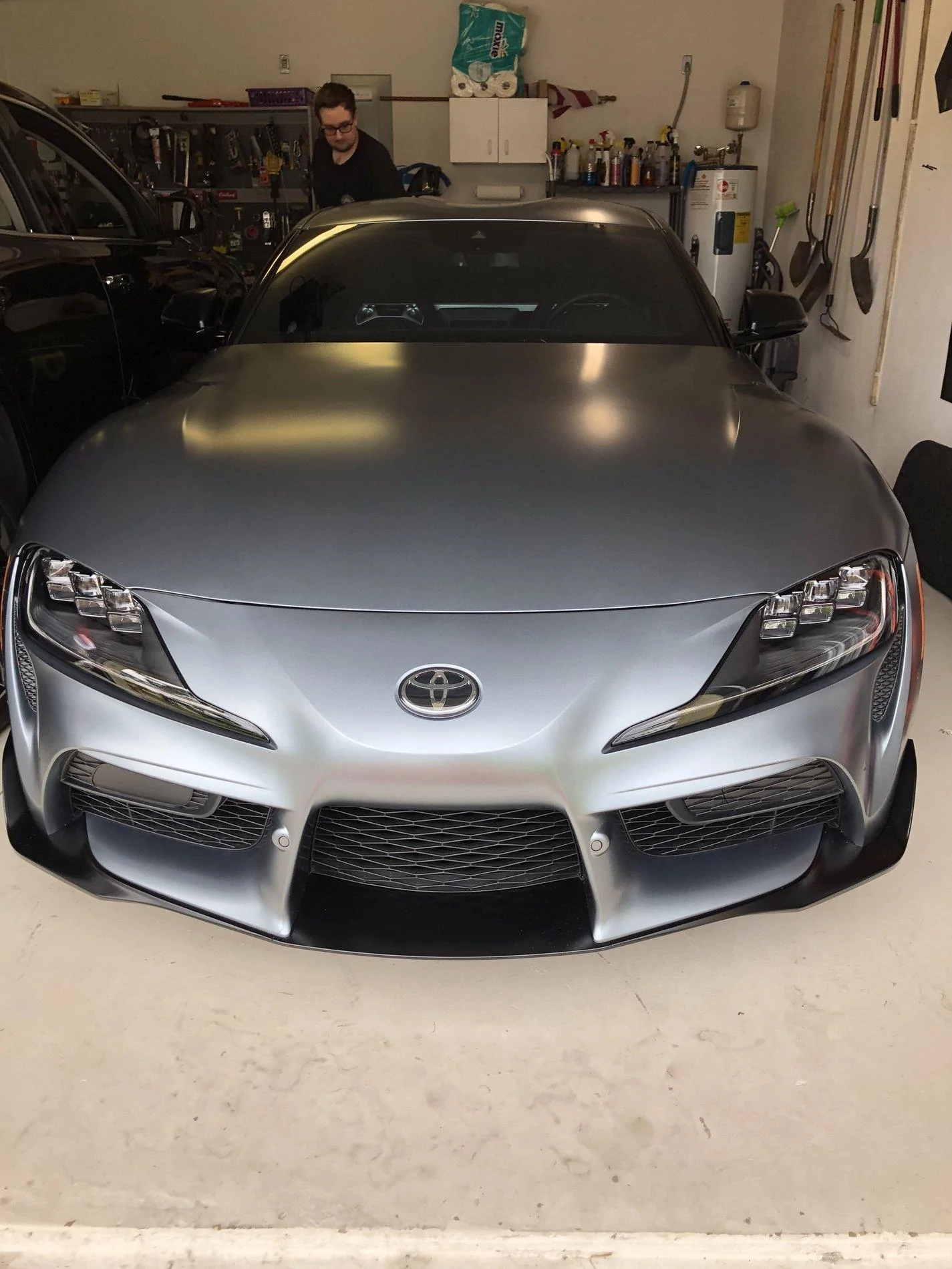

3 weeks old!!! Love it, but matte paint care is a bitch!!!
