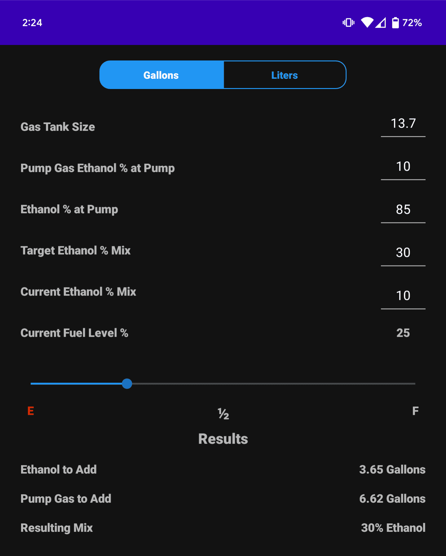

For example, let's say I'm trying to target E30 specifically.
  1. I know that 93 octane gas is always 10% ethanol.
  2. I know the e85 from my local gas pump is real 85% ethanol, because I've tested it.
  3. I know that my gas tank is 13.7 gallons.
  4. I know that I have 25% tank left, because the car tells me I do over OBD.
  5. I know that 25% tank is full 93, which means it's 10% ethanol.
  6. To reach 30% ethanol content, I need to pump 3.65 gallons of e85 and 6.62 gallons of 93 octane.

This is the same app I use. I pair this with the factory Supra app to tell me how many gallons I have left
