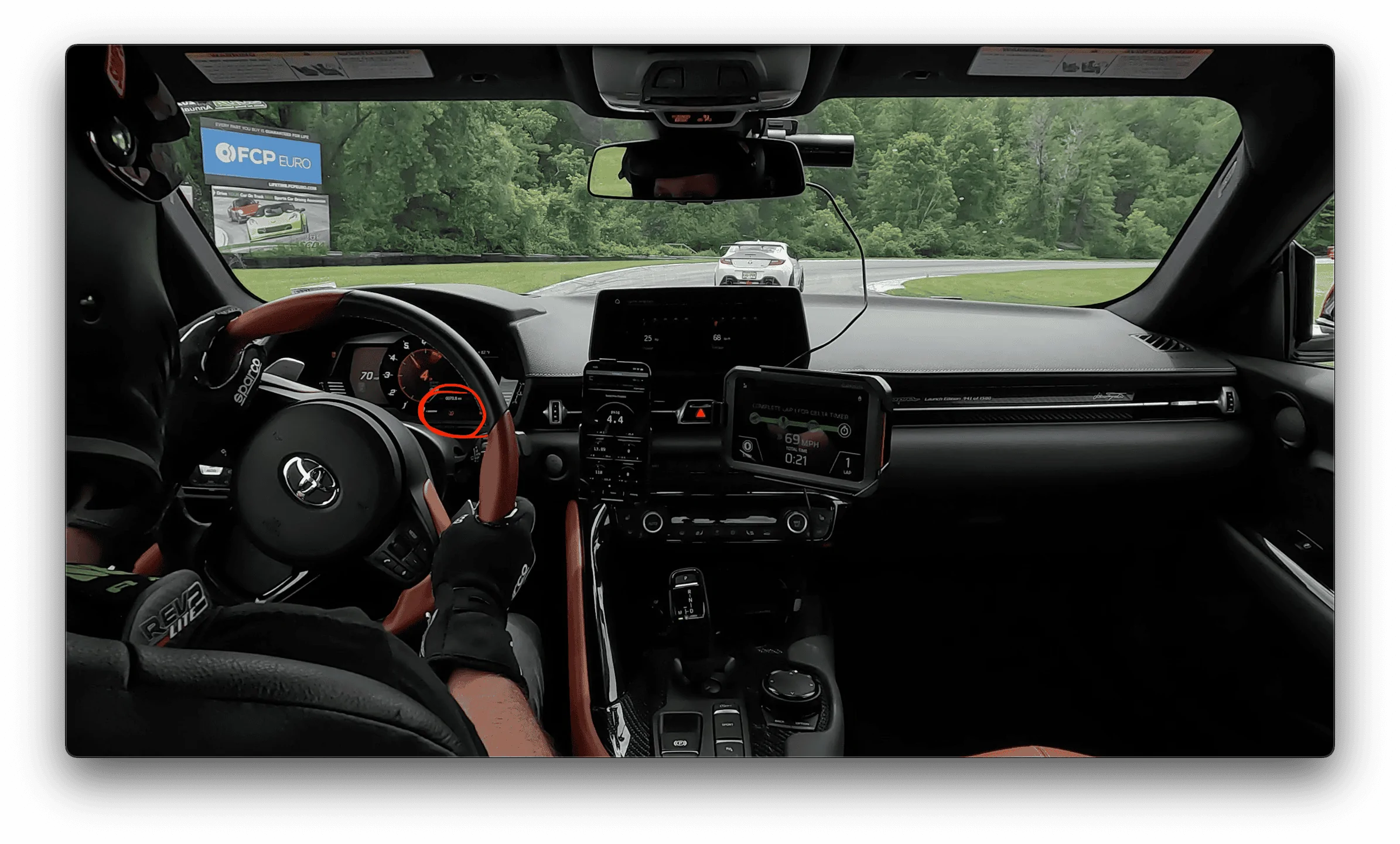

Track wheels, TPMS or not?
How does not having TPMS affect pressures lower than 24psi popping traction control back on?
Do I have to deal with car sounding the bmw gong and throw a message/caution because no TPMS?
8,828
17,320
I took mine out. One less thing to have to worry about while driving to grid.
You get a TPMS error but it doesn't affect anything.
As an aside, I have it on my list to figure out how to code out TPMS this winter.

no cel but that “gong” and the message like trunk is open kind of thing right?
8,828
17,320
No code, you just get the TPMS light on the gauge cluster and that annoying msg/gong on the entertainment unit.
TPMS light:
8,828
17,320
And you could go into limp mode if the car is unhappy enough.
Not following. What do you mean? I have had my TPMS out all this season, over 20 events. No limp mode.
