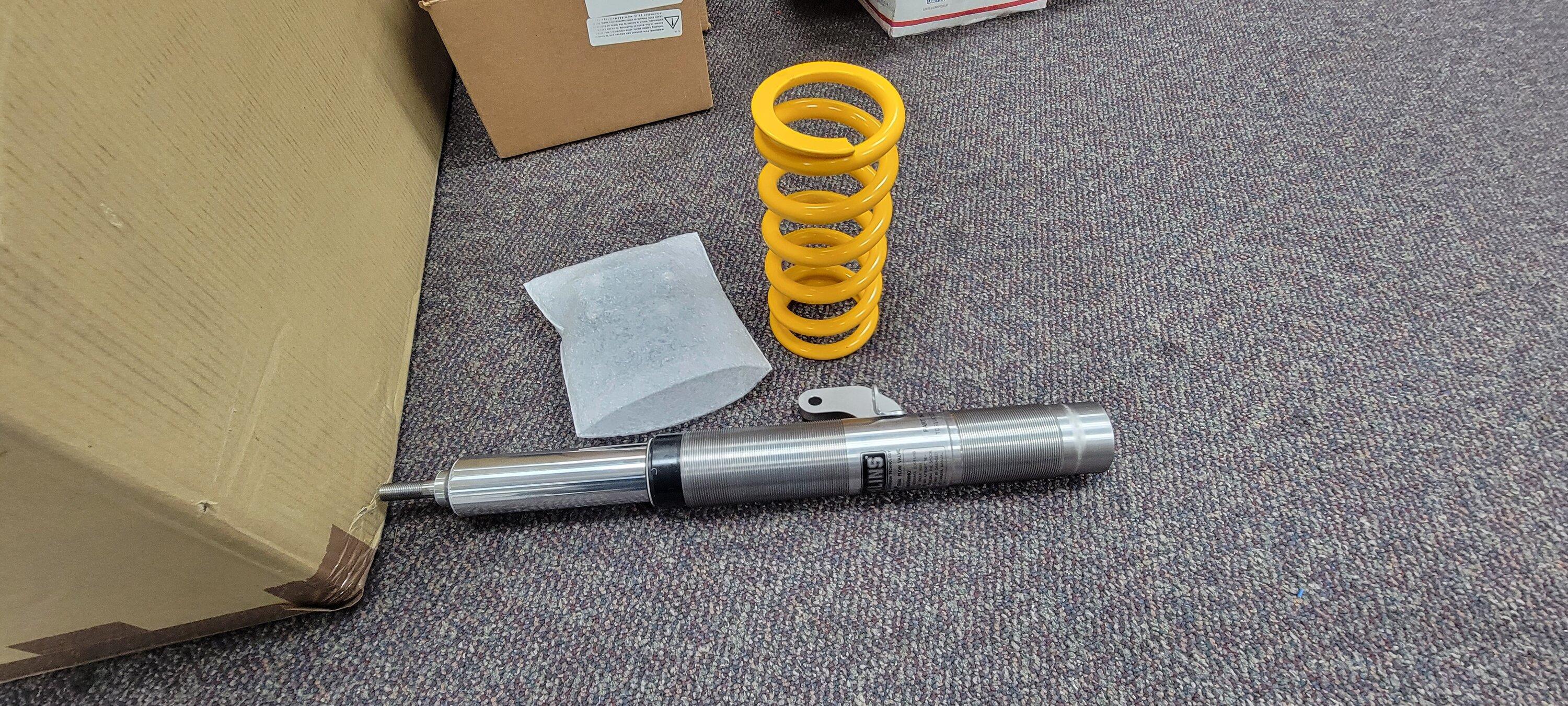

Good news for today is that my replacement set of Ohlins is due to arrive. Going to rob the one dampers out of the box that I need and head over to the body shop to drop it off. So got that and the remaining Verus parts to fix my top hat and they should start assembling my car finally! Might actually get it back before the year is over.

So the downside to Ohlins is that if you need individual parts, you are waiting a month for them to come in from Sweden. No one stocks them in the US. If you are on a time crunch like me, it forced me to buy a full set just for 2 parts....
Good news for you guys is that when the replacement parts come in to replace the ones I robbed, I will have a brand new set of Ohlins for sale for cheap! You just have to wait another 3 weeks or so...
What happened? :)
