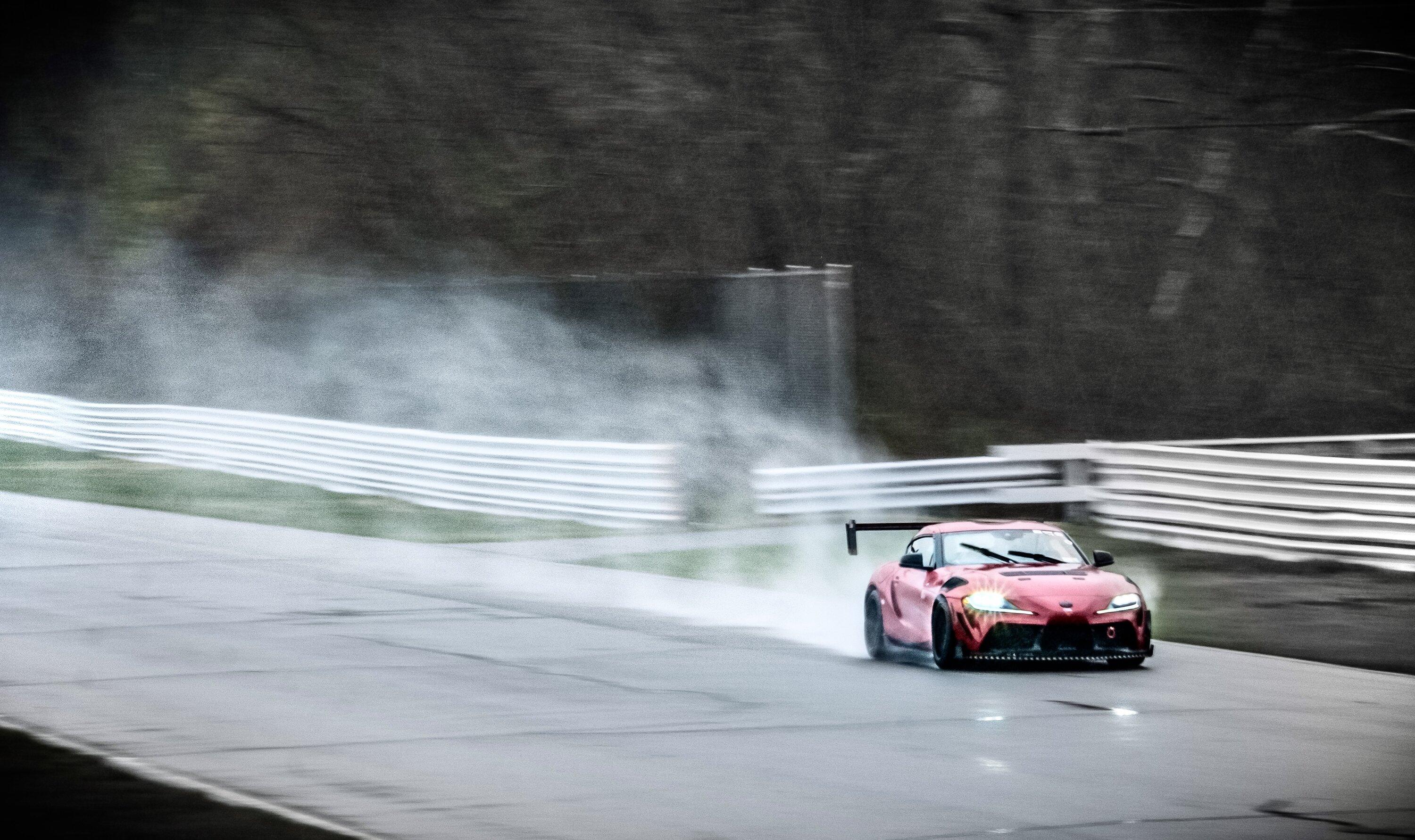

It's all relative. @garudathree drove RC-1's on track in pouring rain so...
Sounds like my kinda guy! Love those tires and driving in the rain (on track).
I don't drive the car on the street, but I assume it will be just as bad on course.
No fun in town, or to track destination when pouring. However, If you turn your lap timer off, drive like you just got your 1st social security check on track - you’ll get some incredible feedback at much slower safer speeds. Then when it’s finally dry again, it’ll feel like a breeze.
It’s either that or sit and watch your track weekend wash away when you live in the subtropics ?

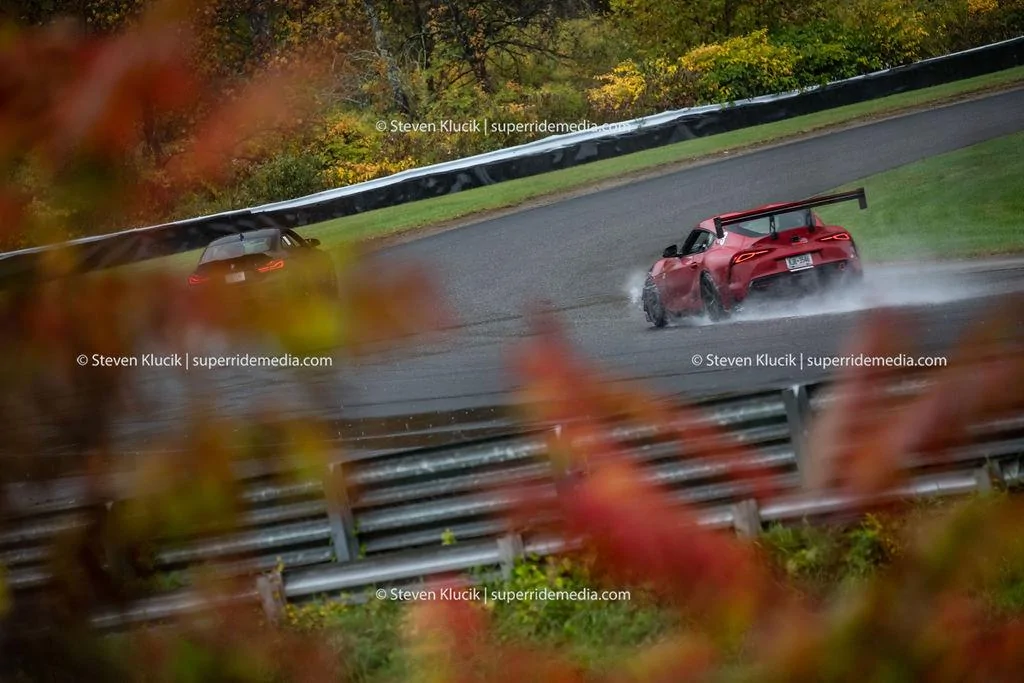

CRS in the rain on a small technical track... no way to connect to track. you can hear me super short shifting. Just no bite. No fun to ME. Lots of people brough all seasons. Lots of spin out and off tracks- not me. Gave more point bys than I have in 40 track days combined. Finished second to last in SCCA TT that day. LOL

Me and another guy are in a points chase. Taking it easy isn't an option.
garudathree
Jun 9, 2021
293
345
ny
none
two ways to run wet days:
Street tire at full tread, to evacuate water
Track tires at high temp, to evaporate water
A good aero setup can help with the former, on tires without much water sips. it also helps to run massive rear aero imbalance as well, to increase the static margin
RC-1
