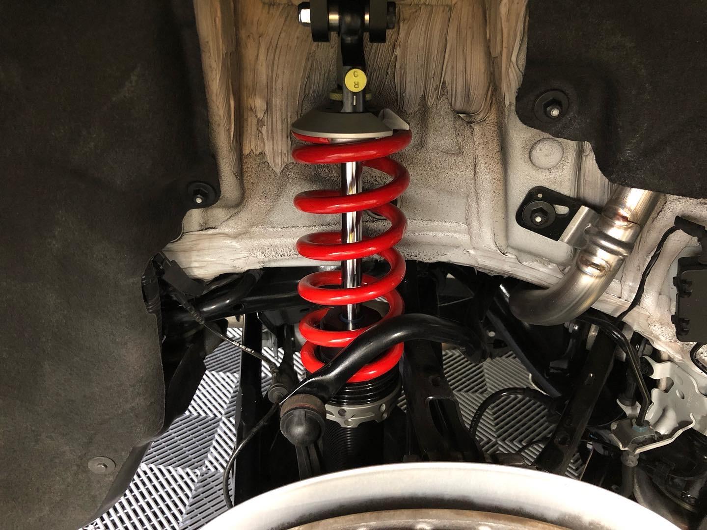

Is the spring anything to worry about? Was pretty sure it was out of the way and that it would hit the liners well before the spring.
I forget but is your spring mounted on the top or bottom of the coilover? Thought it was at the bottom.
That I do not have personal experience with. I do know people run 18x11's with true coilover rear but as you know, people never give the full picture. The wheel will fit, the tires are the true story.

Comparing your picture to mine, I would say that if the tires don't rub the coil at full droop, you are in the clear.

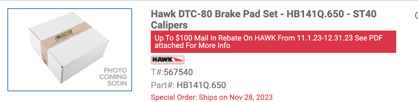

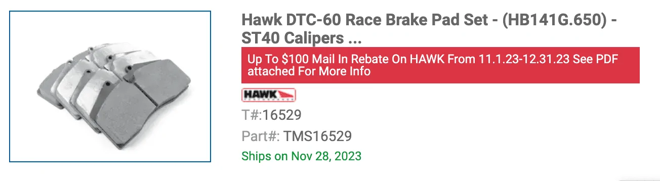

You links work now, those are for ST-40 calipers. Stoptech. Not OEM.
Thanks amigo. I realized after the fact that I picked Z4 30i instead of M40i. And I do think their link is possibly off for the Hawk email they sent. So I called them and you’re right. Still not available for the stock 3.0 premium calipers…. just yet. However, I did ask them another question.
