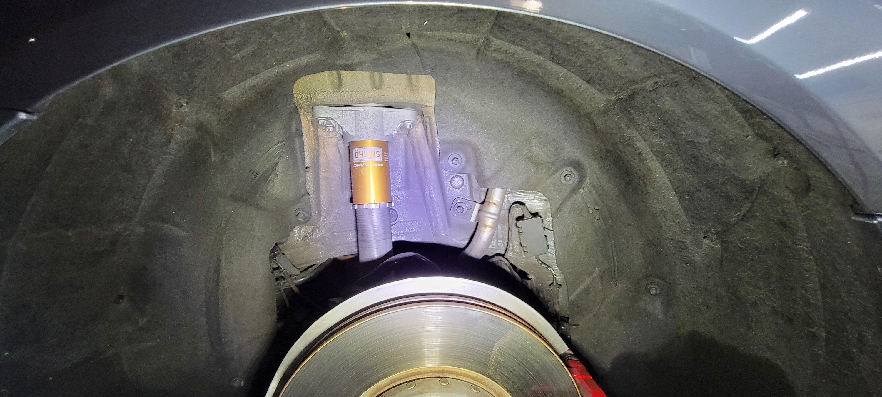

For those that went with the coilover rear (eg MCS), is there any clearance issue with 18x11s in back?
I’m hesitant to go the coilover rear for that reason.
18x11 work depending on offset and tire size.
Likely 295/30 on some ots Apex wheels which appear to be +40. I’ve been running that size on my other car for a while. But there’s always that creep of wanting to try more over time :)
I am interested in this as well as I thought fitment was only an issue on the front. Will probably go 275-310 on 18x11 apex wheels with a true coilover MCS 2 way.
You guys will have plenty of room between the tire and coilover. Its the fender liners that you have to worry about with a 315 or bigger tire. I am effectively at a 37 offset on 315s and still rub the inside liners. I think a 35 offset would be perfect for me but my car isnt that low and I run a decent amount of camber out back.
Thanks that’s paints a “good” picture. I’ll try to be happy with short 295s for a while.
You're missing a spring, which is what he was asking about.
Is the spring anything to worry about? Was pretty sure it was out of the way and that it would hit the liners well before the spring.
I forget but is your spring mounted on the top or bottom of the coilover? Thought it was at the bottom.
