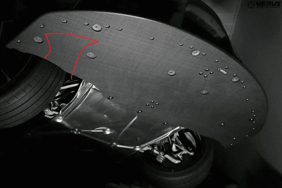

I molded my own tunnels for now, but am waiting to test a set from 777. Occam’s racer also has a set that I would like to test, but we have packaging issues due to side rads.
They have them on site or custom made for U?

Id like to add tunnels. Not sure where or at what angle to install without a template from a wind tested soln.
Probably somehting like this between those mounting bolts, or maybe cut the inner ones. A rough idea
