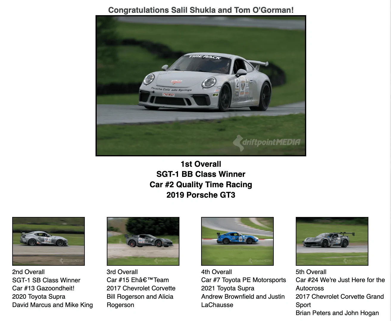

If you aren't spending money on coilovers, then your plan seems solid. HKS springs and rear wang.
Danny Kao did One Lap last year and was competitive with a basic setup and stock power (although he did have MCS coilovers)

tomfree
Tom
May 23, 2022
329
407
Gaithersburg, MD
'22 Supra 3.0 Premium
Actually, Danny did OLOA in the Supra in '22 (my first OLOA), and he and Brian Heikotter did indeed do very well against the other Supras (Toyota PE, Dave Marcus, etc.) considering the considerable power disadvantage. Danny is local to me, and has moved on to Porsche stuff.
This year Dave was 2nd overall, but I have no clue about his setup.
While my OLOA finishing position SUCKED this year (my fault, not the car's), I was VERY near stock. Verus camber plates, AFE Control sways (F&R), 18x10.5 wheels/275s, and CSG pads. No aero, and craptastic Conti ECS02 tires. Takeaway...the car doesn't suck on track with stock springs. It's a bit floaty and takes a moment to take a set, but it's not some penalty box that only handles well in a straight line.
8,788
17,250
That's what I said, last year was 2022. :)
This year, 2023, Supras did very well for sure!
