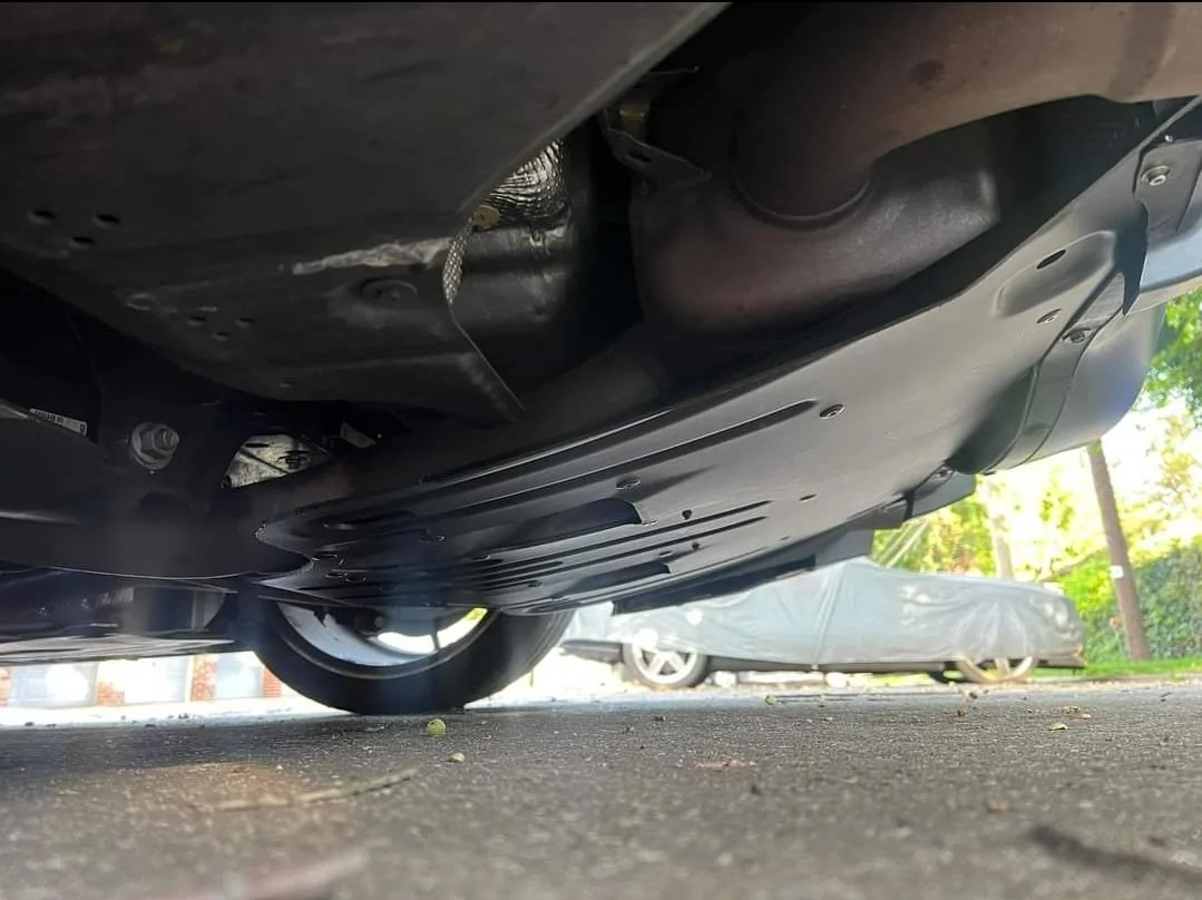

Here's a pic of it on the car. I imagine any sort of aluminum sheet would do just as well and cheaper. Seems like these go for around the $300 range.

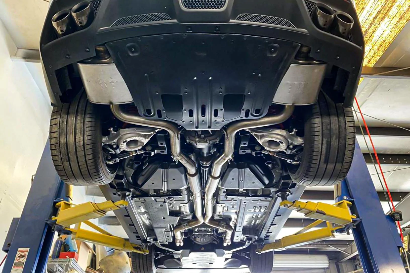

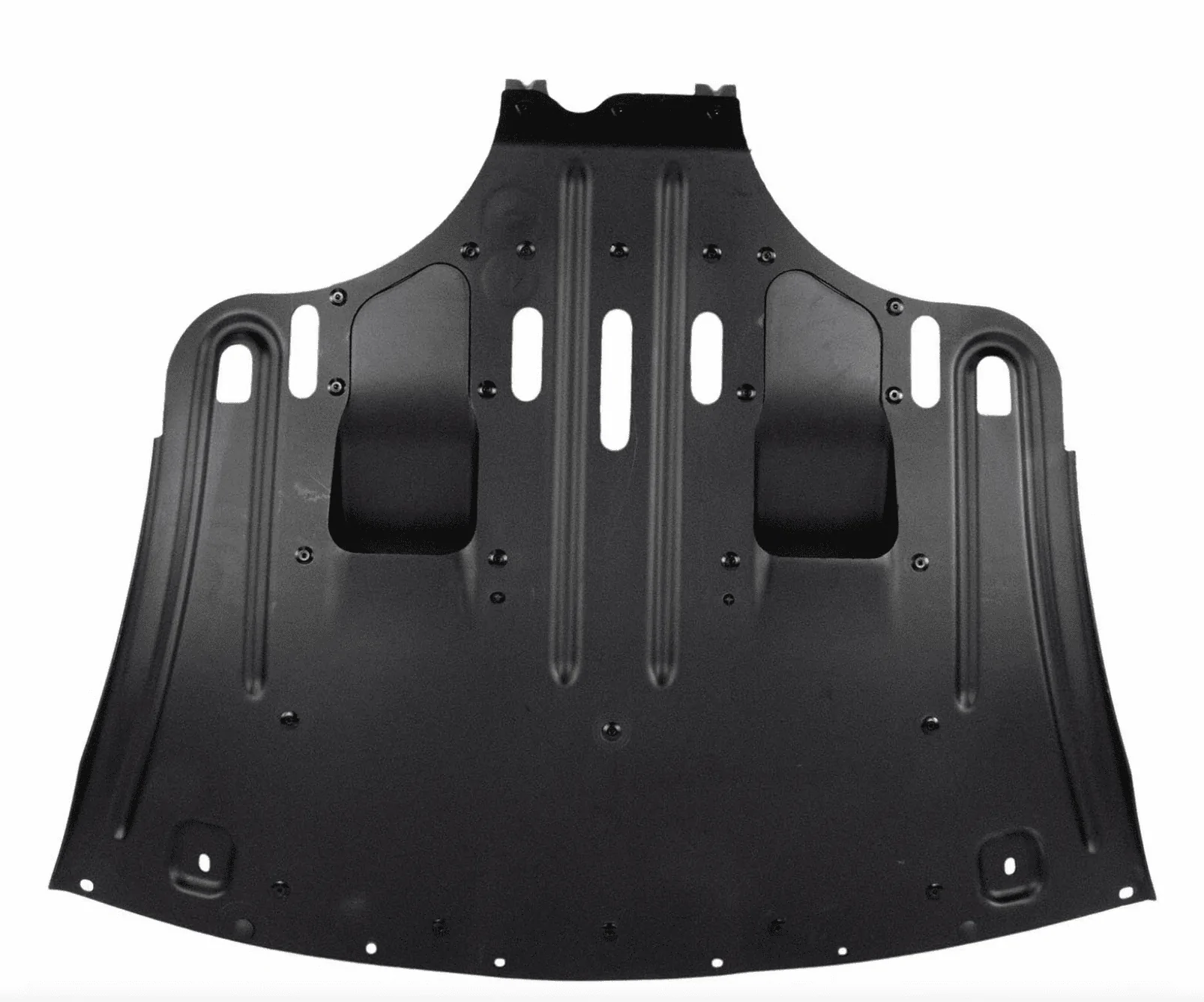

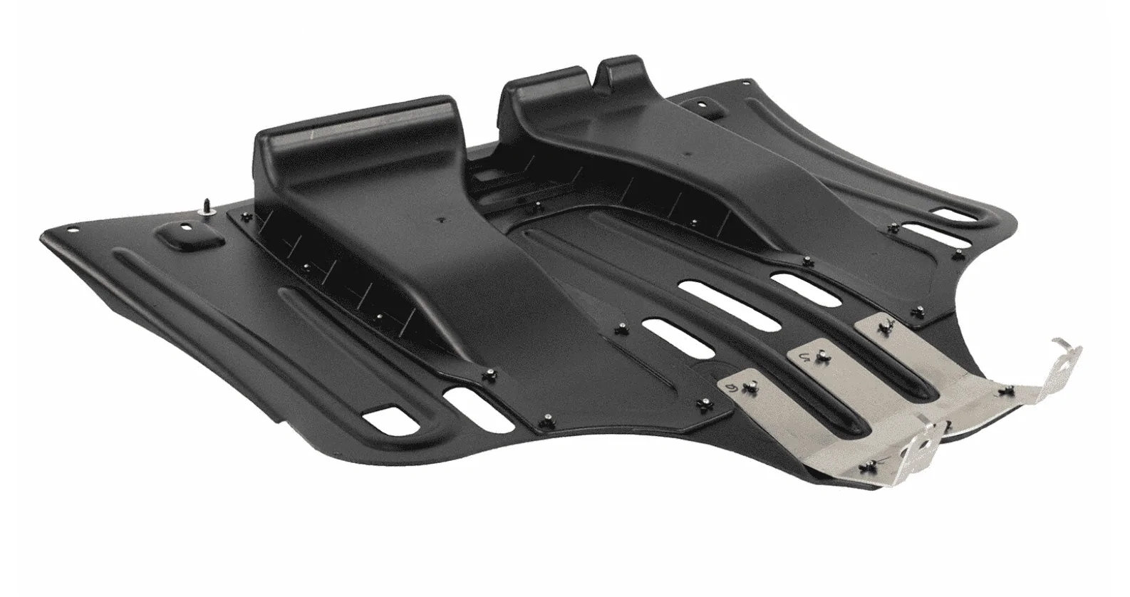

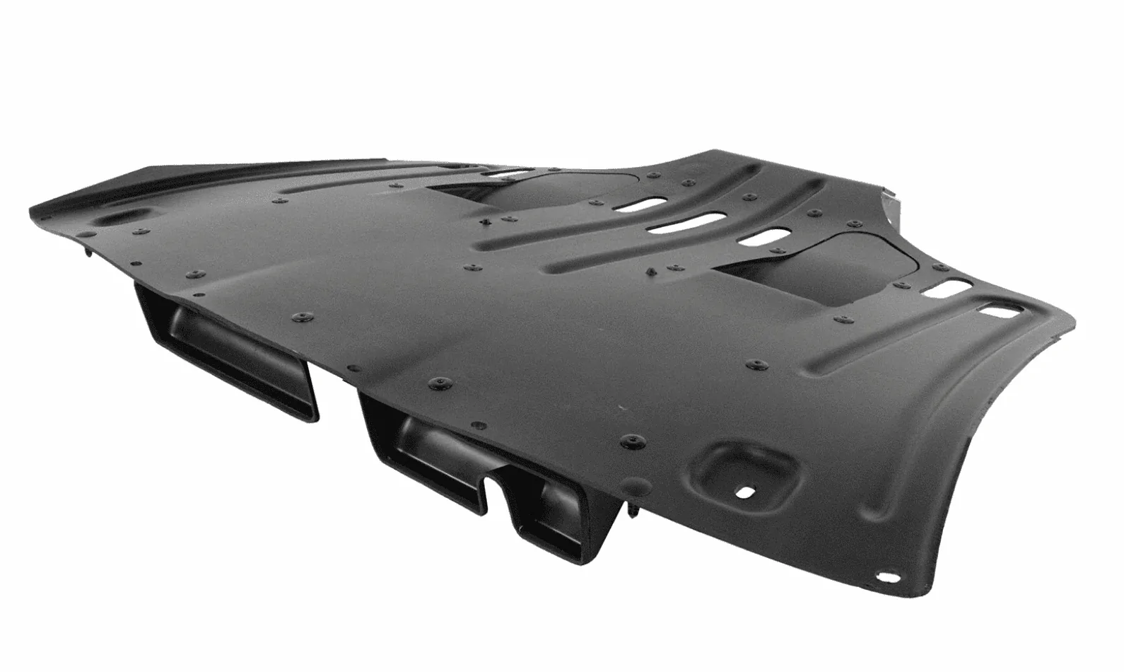

if i were to do it again, i'd adapt the panel from an modelS/ioniq5/6's underbody instead. part of adapting the mustang setup is so when 777 releases a mustang race diffuser, i know i can swap it onto the a90 platform with just a few bolts.
Ahhhh that's smart, I hadn't even considered just using one if their diffusers for the mustang chassis. I also haven't even considered an EV underbody panel lol
A flat panel cut to the proper dimensions to fit would be better. The diffusing portion of the mustang panel is exiting into the bumper and gets no venturi from the rear wing.
the diffusing portion doesn't go into the bumper at all, it's just keeping the exhaust cooled, terminating after it meets the muffler. flow vis showed full attachment to the bumper mount point
Ah, so you trimmed/removed the diffuser portion and kept the duct inlet for exhaust cooling.
