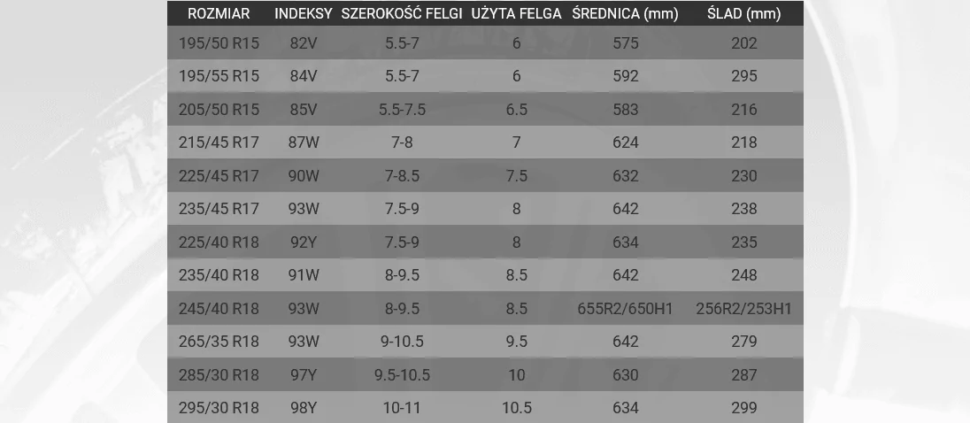

So U say Dunlop themselves are wrong recommending wheels size for their own tire? Coz its their idea + confirmed by biggest tire shop here in PL who sells tons of motorsport tires.
Im thinking between 265 vs 295 (so irl 279 vs 299)

You can see that from EVERY tire manufacture, just because it technically fits, doesn't mean it's optimal.

Sure, but those mid values are Dunlop recommended, confiremd with tire supplier.

sorry man, these aren’t recommendations for performance in any way
on a 10.5 a 275 and a 295 will run about the same pace. Feel is subjective but the 295s will tend to squirm… I personally would only put 275s on a 10.5
On an 11” rim, 295 is faster and feels okay but it’s less of a difference than you’d probably expect vs 275. Around 1 second at most tracks, but could be less.
on 9.5 both tires are too wide. You could run a 275 but narrower tires would have better sidewall support and better turn in and stability under breaking.
for reference, the fastest time attack guys that run 255 tires (due to rules) use 10.5” rims. Just some food for thought.

I know that, just saying what Dunlop says. So if 295 then prob 18x11 would be more optimal?
Just speculating on tire size alone here, wheel will be matched accordingly.
for 295, I think a 12” is optimal. Usually add 0.5” to the max width on those charts and that’s the fastest setup.
11” is the minimum for a 295 to see a performance benefit in my experience
