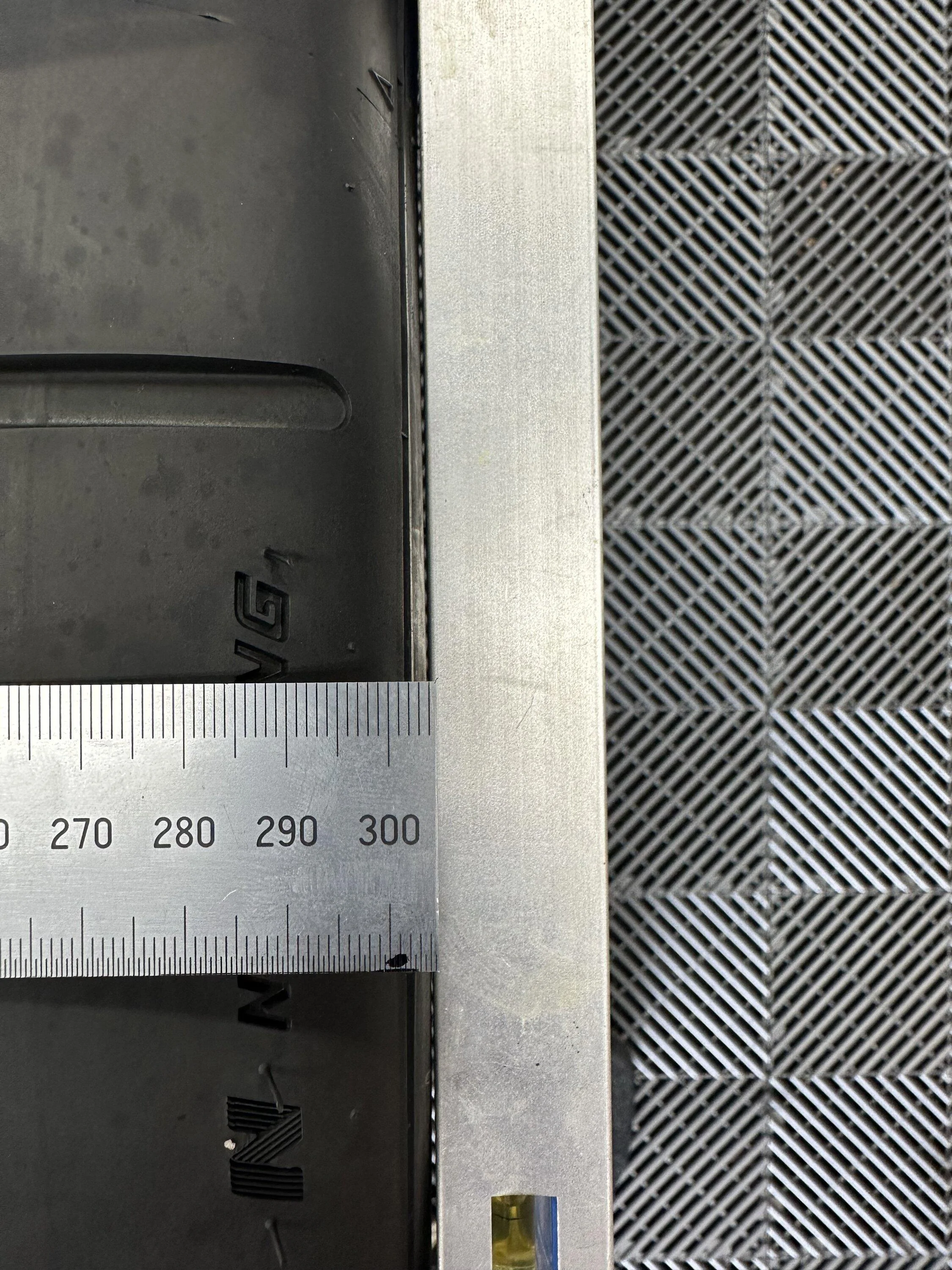

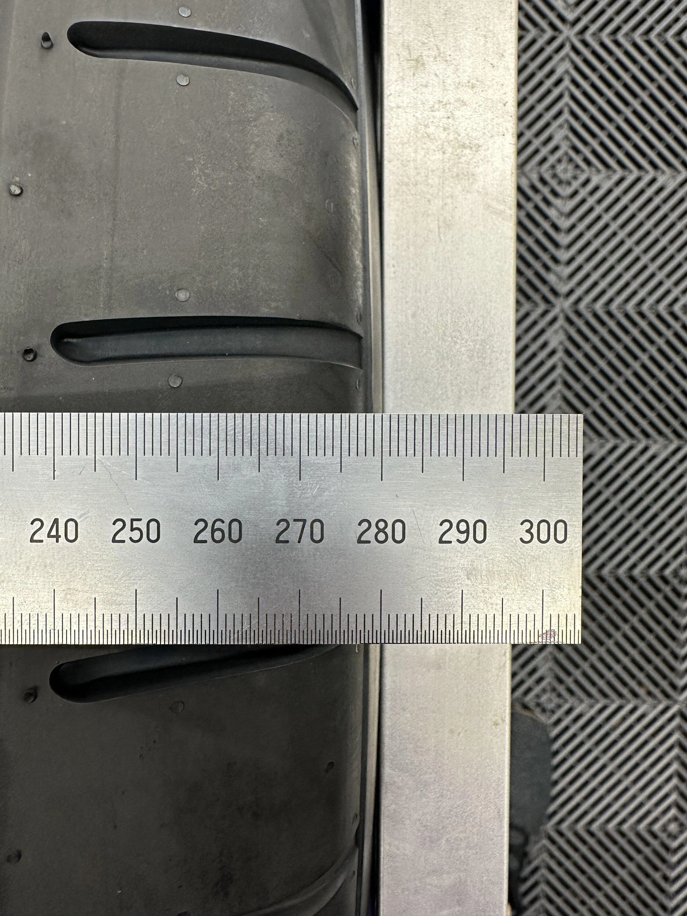

I've used both 275/40/18 CRS V2 and 295/35/18 CRS V2 although it's not really a fair comparison as the 295 CRS are wayyyy too wide for 18x10.5 wheels. I am solving that this year by going to 18x11.
Now, things that don't depend on the wheel width. I could feel the weight and drag difference for sure. My mph was down slightly in the straights. However, even with the tire feeling like crap because of the wheel width, it had very noticeable grip difference and I went faster. Looking forward to them on a proper 18x11.
Here are the measured width differences, both unmounted.
275/40/18
295/35/18
