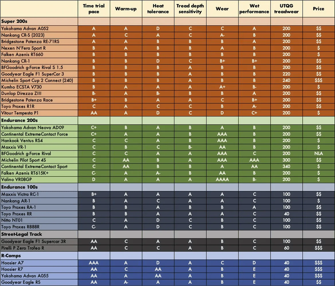

I thought V730s [B-] were more likely to kill you in the rain than any of the other Super 200s (B) (according to the chart)?
Also does RE71RS [A] really do better than ECFs (B) in wet performance?
8,615
16,896
I don't have personal experience with RE71RS in the rain so I will leave that to someone else.
The Nankang CRS will get you to/from the track at full tread or close to full tread even in a monsoon but from personal experience, I had to have a couple whiskeys on arrival to calm my nerves.
The V730 get faster as they wear, but they also turn into slicks, which don't get along well with rain.
I dunno how old this is or what compound direzza they used but there is ZERO chance Direzza Z03G is slower than CUP2 or RT660. Hell, many ppl around here switched do direzza, even from A052, because it was still bit faster and lived longer. Every winning car here up to 18" runs either slicks or direzza (which are not road legal everywhere btw). 19" CUP2R or a052, we dont have RE71RS around here. Also, it was faster than Trofeo R, tested back to back on the same car and guy is buying Dunlops now after trying them ;)
I had conti sport7 (european equivalent of Conti ECS in US) which is not THAT much slower than cup2 and its considered atm best UUHP tire in its segment beating Michelins4s easily in the tests. When i switched from conti7 to Direzza (same setup on the car, nothing changed), i cut 2 sec on ~1.1min lap and 4s on ~2min lap, the difference was huge.
As for question, for dual pupouse I'd search for something that takes beating well and its good in the rain, I would let go a bit of speed (so conti would probably be good enough). OR if cash is no object than A052 (and its good in the rain). But dedicated set of track wheels and tires + some neg camber imo is the way to go in the long run if U plan tracking more in the future.

That tire isn’t even on this list. Dunlop ZIII is a totally different tire than what you are referencing. It’s a old tech street tire.
We don’t get the tire you are referencing in the USA.
Ah ok, my mistake there. So info for EU bois for the future :)
