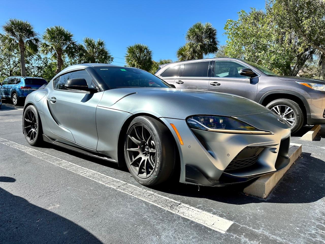

Personally I like 36 psi for a target hot pressure. Good to know I’m w/in limits ? running Maxxis RC-1 tires. If anyone else is interested ?
Discounted if a NASA member. If anyone else running a square 275/35-18 setup
https://nasaspeed.news/columns/nasa-news/maxxis-contingency-program-kicks-off-for-2024
(next to handicap parking - plenty of room ? )*
Those recommendations are for a much lighter vehicle. Tire contact patch is proportional to vehicle weight divided by tire pressure.
if your Supra is 18% heavier than the spec e30 (or whatever) the manufacture will, as a general rule, recommend tire pressures 18% higher to maintain the same tire shape and contact patch.
Yessa. I don’t think they recommend a square setup either. But there is a huge range there if peeps check it hot. A pro buddy prefers the psi even lower. I love these tIres on our Supra ?
