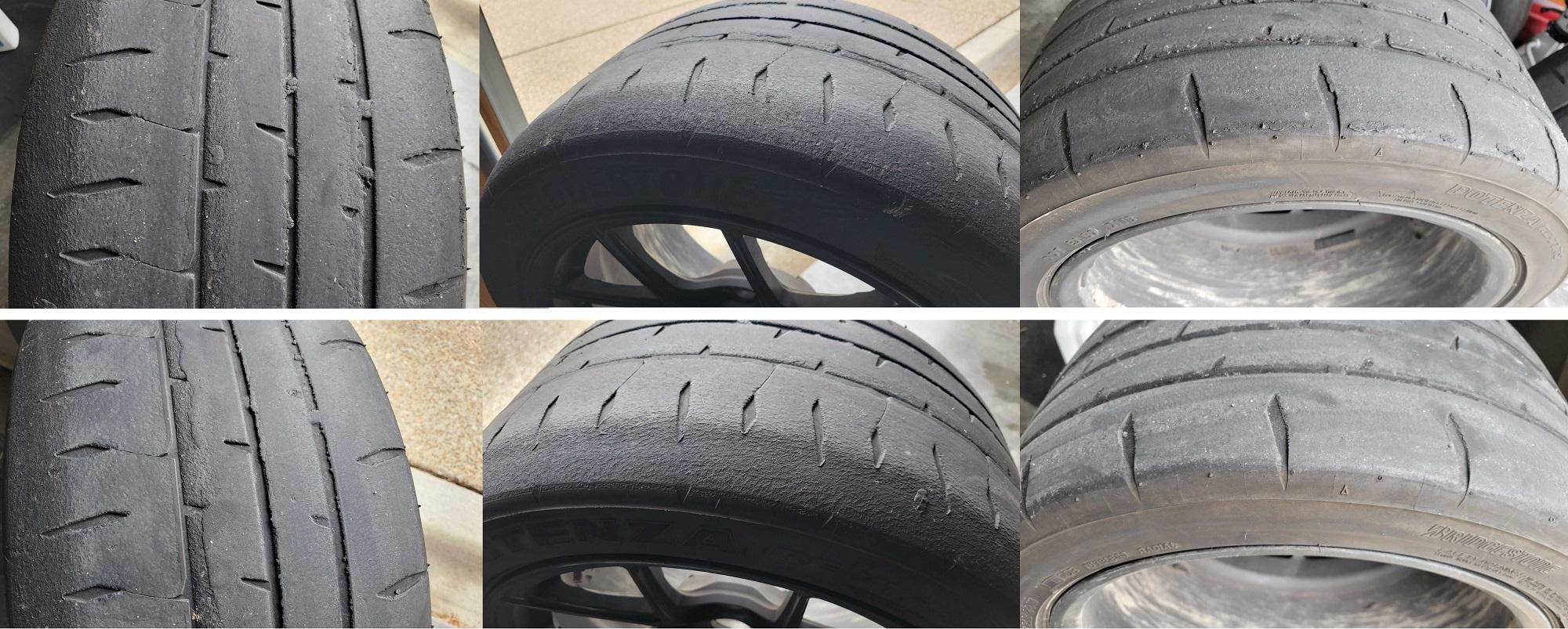

Two of these looks rolled a bit on the outer edge ( expect those are the fronts) so is getting close tread wise. I would have your next set ready and run them till they cord if they still are not sliding all over the place but I am cheap :). They may not make both days. So 9 days you already got your money out if them and if you already have the new set may just want to change them so you do not risk a track side change.
Think I can sneak another weekend out of these rears (RE71-RS)? I've got 9 days on them so far, approximately 35 20min sessions.
9 days… Wow ? Thanks for sharing! I’ve been meaning to take pics of my Nankangs. They look similar, with more prominent outer wear up front. I’ll rotate them to the back & use them one more regular weekend (2 days like you) ?
Driving 3 days this weekend. One is an all you can eat/drive buffet. Didn’t want to chance it. So I’m on my new set tires/wheels - the Maxxis RC1s. Will try and squeeze out two more days on the Nankangs in March and bring the Maxxis ones as backup. It’s nice being able to rotate and finally having a set of spare track wheels.
New PB. Fun being no. 27 at Sebring. It is only February and they run 350 hot days per year. That number will drop fast ? ?
What size are those and how much camber do you have. Honestly great wear and heat tolerance is crazy
