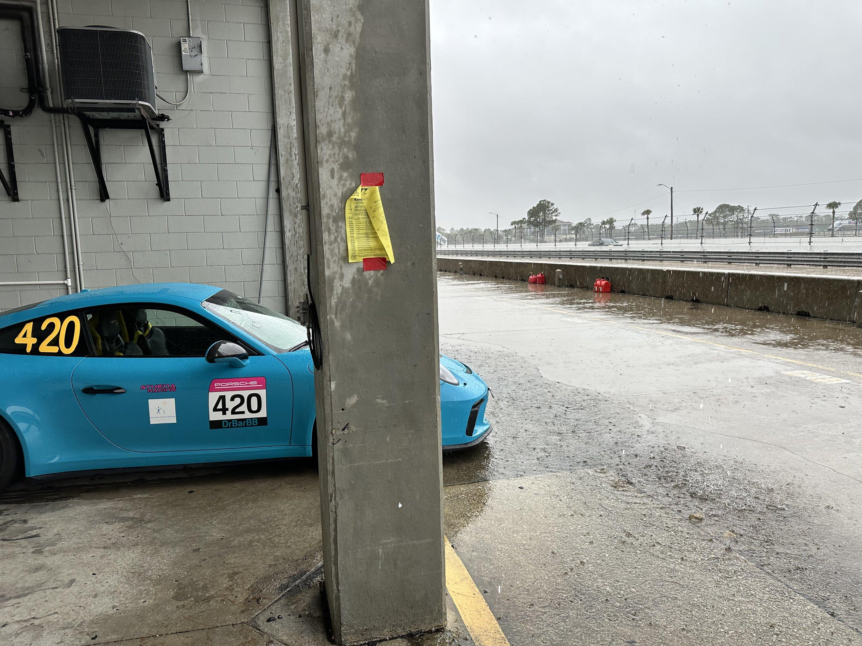

The last day it rained all day. Great car control clinic on the same tires. Proud of my wife. We both drove offline all day. Found different spots with grip. It was a best of both worlds weekend.
Stall next to me ☝

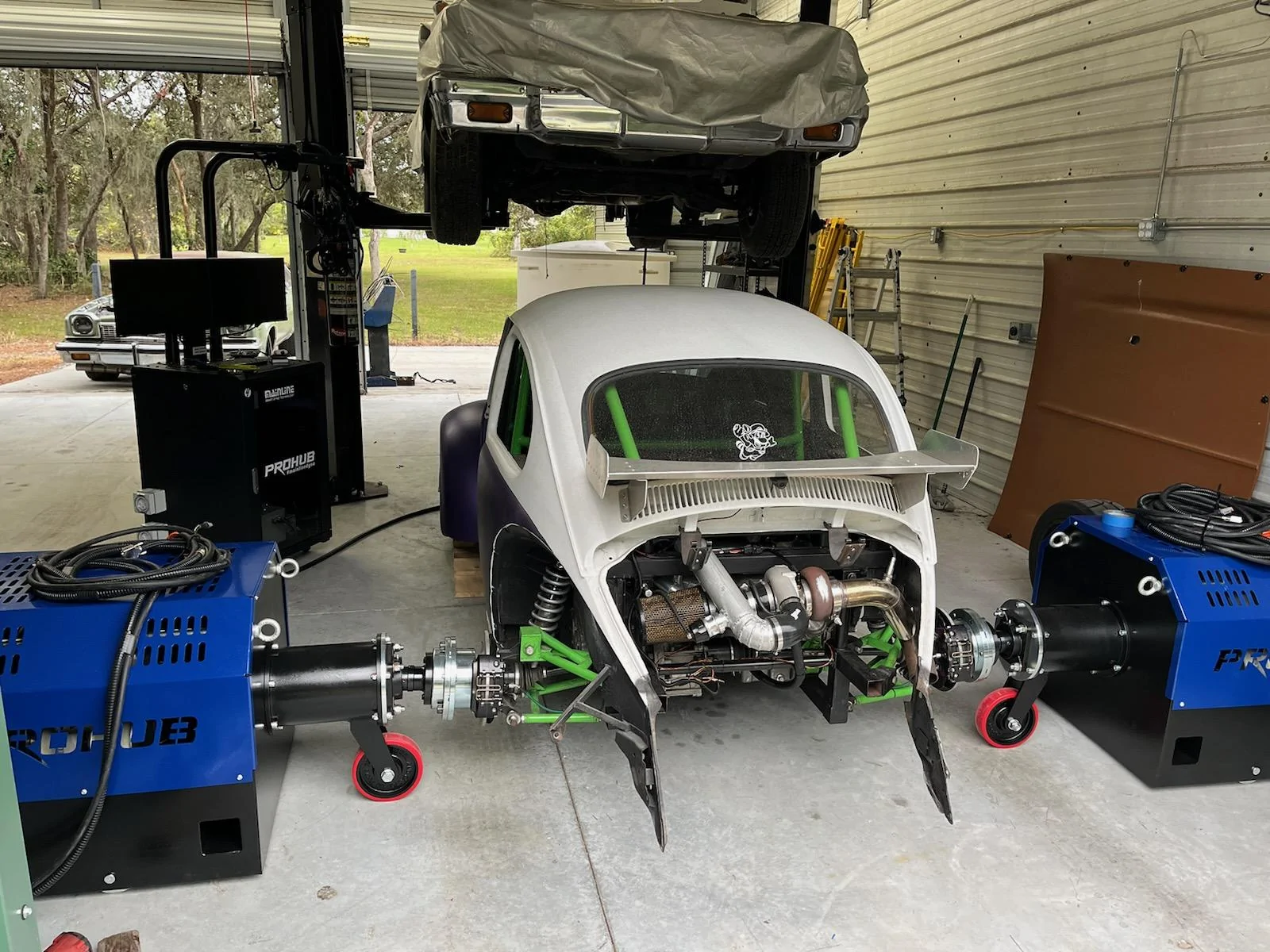

There is no random picture section on this forum so you guys get to deal with it here. Figured you guys might enjoy a picture of one of my last track cars I built. New owner just sent me this pic showing that he cut the rear end of the car off and added a turbo in place. Should see it on a racetrack in FL coming soon!
