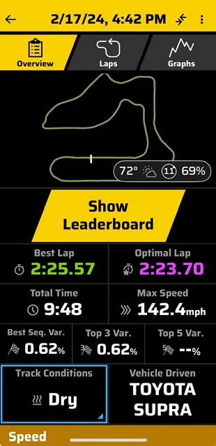

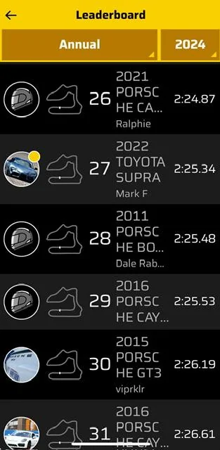

New PB. Fun being no. 27 at Sebring. It is only February and they run 350 hot days per year. That number will drop ? ?
Great job Mark. Strange your variance for your top three is low but your optimal is nearly 2sec faster. Im new to Garmin trying to figure that out, traffic?
