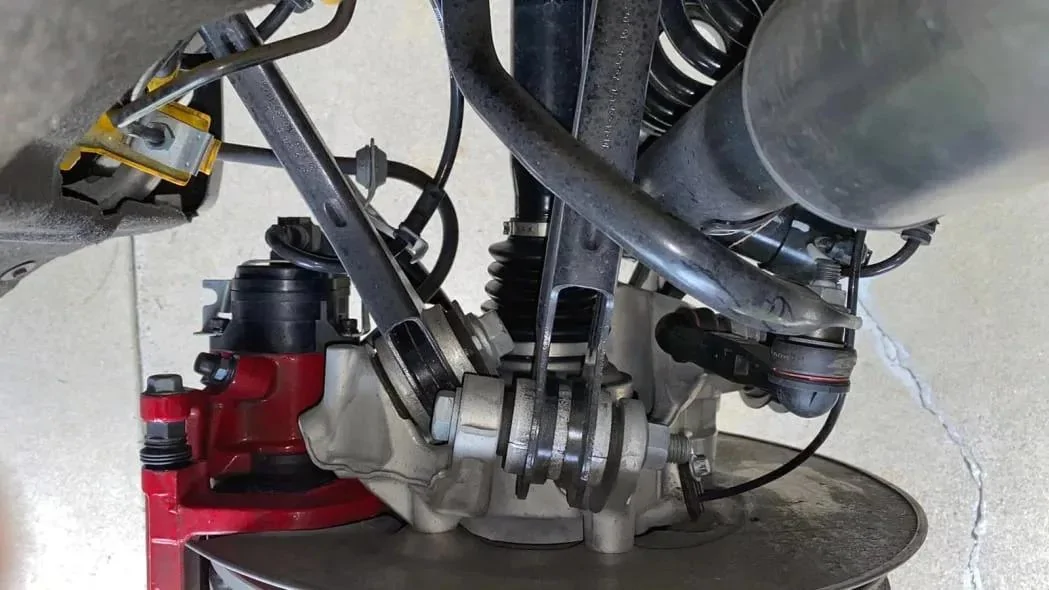

Found out the hard way. Survived my first ever track day a couple months ago at NJMP Thunderbolt. Picked up some wheels/tires off a forum member.. some track pads and fluid. Downpipe/tune are my only other mods. The day went perfectly, couldn't be happier with how the car performed other than me overdriving a bunch, a healthy amount of understeer. Hot brakes.
Anyways I was dealing with a pretty annoying clicking sound coming from all four corners depending on load. Did some research and apparently it's somewhat common with Apex forged wheels, took them off to remount them (fixed my clicking sound temporarily) and found this. My left rear must've self cleared on the track. Had no idea this was happening, bummed out. Will have them off the car again today to further inspect what the heck happened, what it ground on. Figured I'd report that the 19x11 et40 does not work on track ? stock suspension, no spacer.
HKS springs give you enough clearance. I'm running them with 18x11s and no issues so far.

he said the rear was running into clearance issues, though. hks perch only helps up front.
It adds a little bit in the rear too but very minimal. Makes me wonder how off the oem alignment might be. Same offset and width on my end but no issues.

huh, didn't think the rear shock dust cap would be hard enough to dig into the rim.
edit: Pic for reference
but if true, that poor bump stop was spinning like crazy :rofl:
Springs in the rear change absolutely nothing about the wheel to strut clearance. 19x11 +40 should not even come close to touching the rear strut. I'm running rear true coilovers with the spring on the strut which basically has a little less clearance than stock and I run 18x11 +40 with zero issue.
Also, if you look at the photo his tire sticks our further than the wheel yet has no damage. The story is not complete on this.
Touche... I was only thinking of the slightly tighter spring and my brain completely forgot the strut
