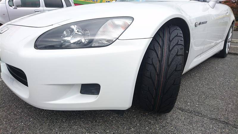

Evasive has the front PMU Club Racers in stock. I ordered a set last week and they came in a few days. I'll probably run them with stock rears.
Yep I just checked with them and said they have front and rear in stock so i snagged a set.

That's a weird looking Viper.
Hey, just trying to illustrate how they look on another car that has a very snake-like face, soooo
