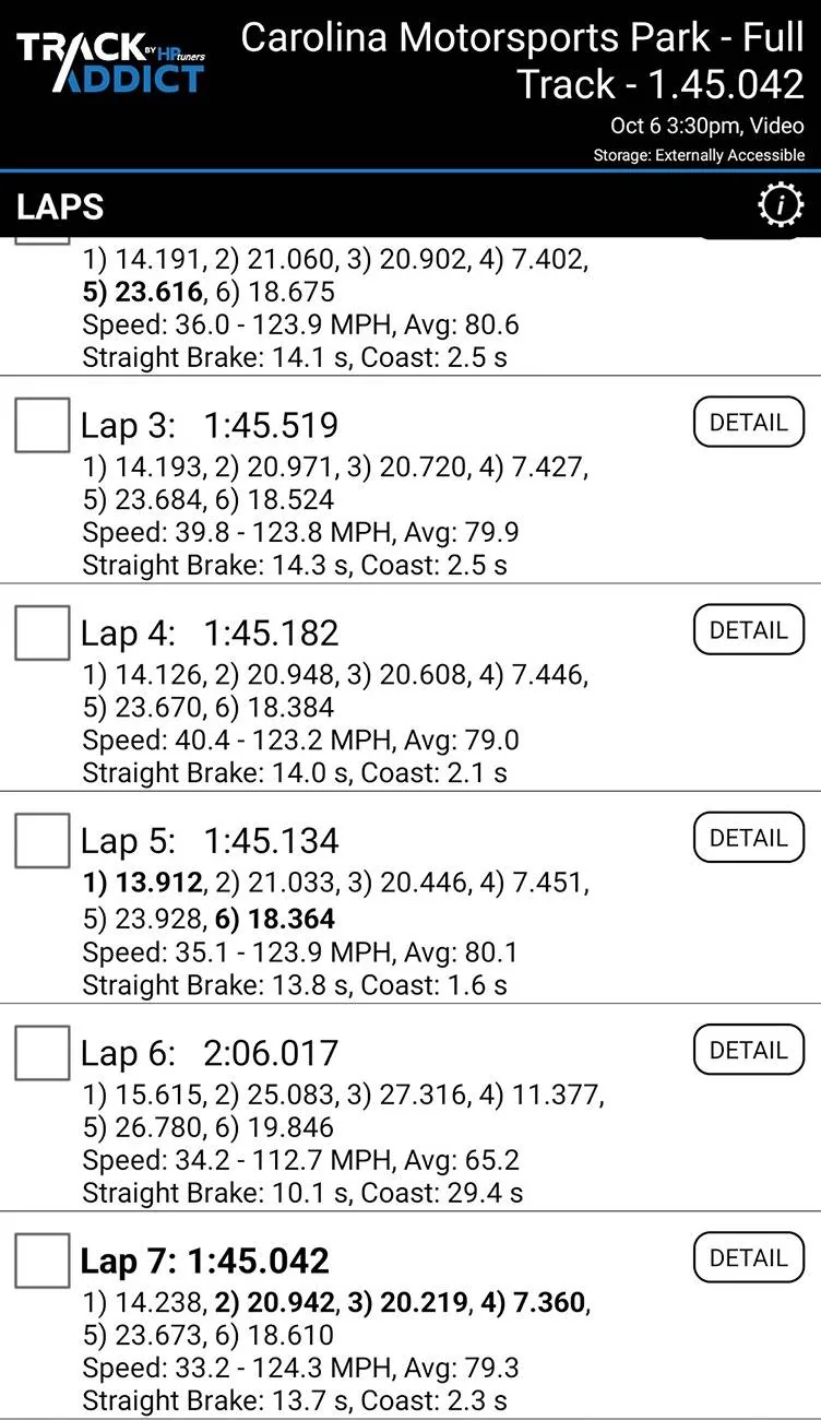

Speaking of torture test.. I was really itching to run the car on the SC3 but our run groups were stacked back to back. Sunday afternoon my wife ran 15 or her 20 min session, pulled in and I went straight out. Essentially zero cool down, tires were 37psi and 170° to start... ?
It's still incredibly consistent even in mid 80°s! I did a cool down lap to see if I could pull off a 44 but couldn't make it happen. Later in the day after the car cooled I dropped tire pressure and went out for a 44 but couldn't get a clean lap without traffic.
Here's the 1:45.0 lap:
I was wondering what you ran when you went out in the car, as I ran into your wife in the paddock after you drove by. Vincent ran a 1:45 something in my car on Saturday and I ran a 1:48.0, but we were both slower on Sunday. Track conditions were obviously better on Saturday, so pulling a bunch of low 1:45's on Sunday afternoon is quick, especially considering my car is a little more modded than your blue car. I'd say, other than you being quicker than me :cool: , the Supercars were probably a better choice of tire for Sunday vs my RE-71RS.
