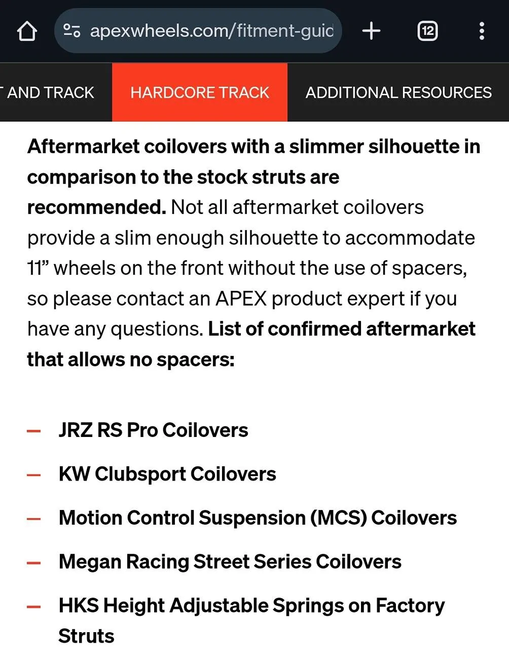

you need a 23mm spacer or something wacky like that with oem suspension. Having said that… just get some coilovers.
wow a 23mm spacer????!!! I feel like that can't be good for the suspension

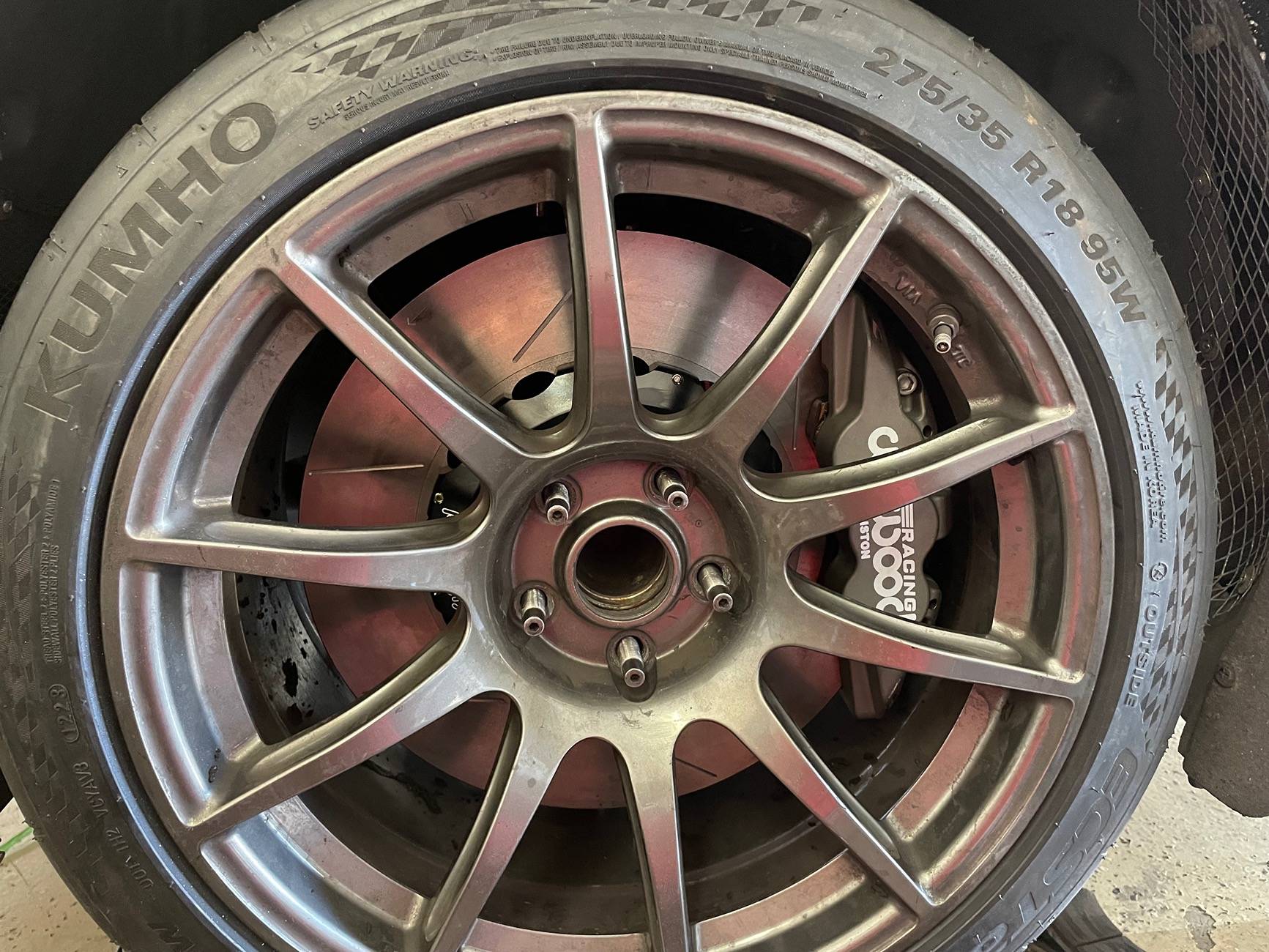

I ran apex on stock set up for over a year with camber up to around -3. With a sport spring camber plates and all the adjustable control arms. No rubbing and no spacers. 275/35/18 tires. Yes the bigger stock/sport springs are closer on clearance and a 285 tire may rub if you have a lot of camber so would stick to the 275.
My Ohlins work but I’m only running 275s with 10mm spacers all around. One thing to consider with coilovers, are where and how easy they are to service. It’s good you’re checking all this out ahead of time ?

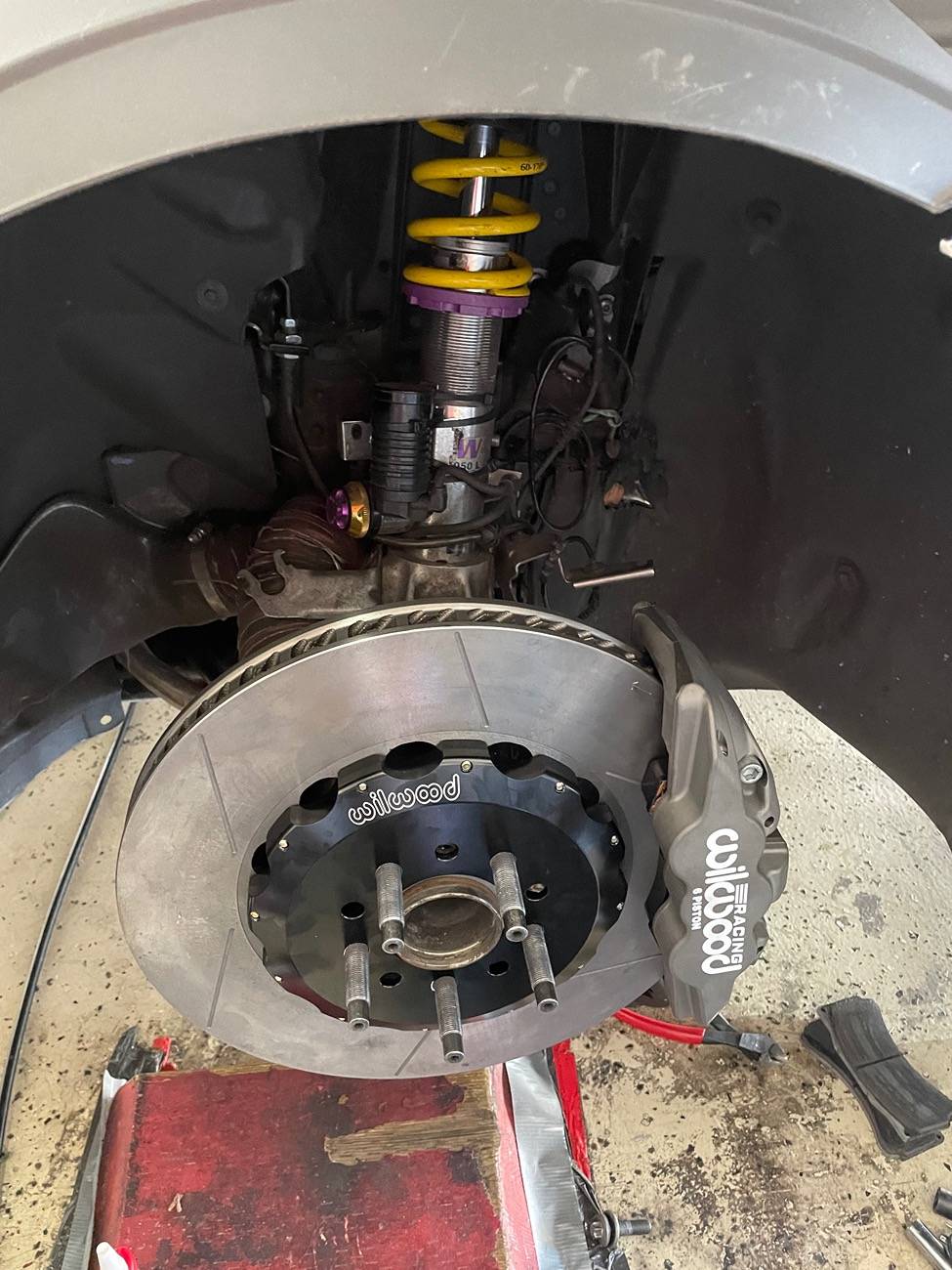

Lol at wilwoods. I like how the pad is only using maybe 3/4 of the rotor surface.
Ouch…. I never noticed that ?

when I run my 11” setup (Apex), I have to run 3mm spacers or they will rub front and back. That was on 315 tires though. We will see if I need spacers with my 295s if they ever come in.

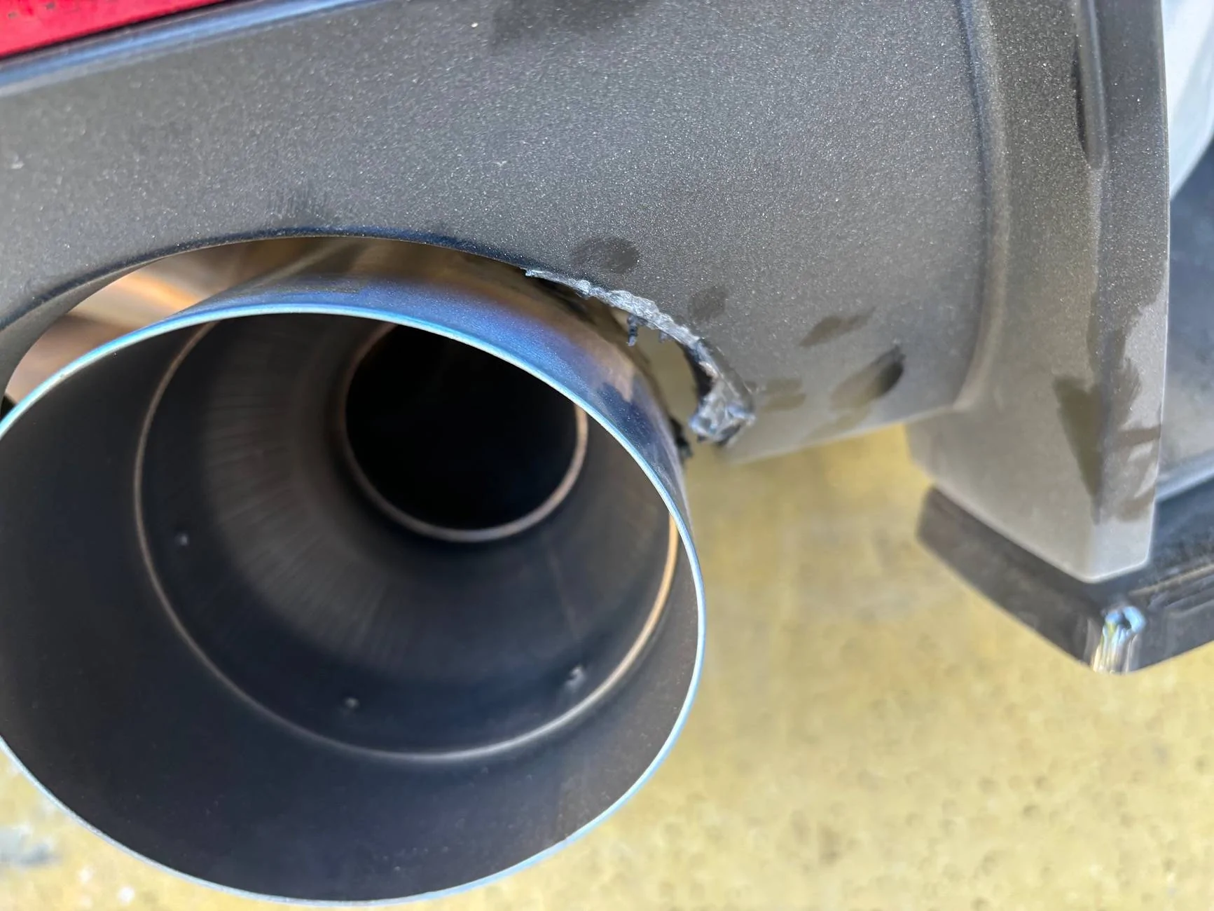

Noticed the plastic around my hks tips melted on one side due to a long high speed left hander. Has anyone put any sort of heat shielding or material around the plastic to prevent this?
Hangers seem good. I can’t really move the exhaust by hand.
