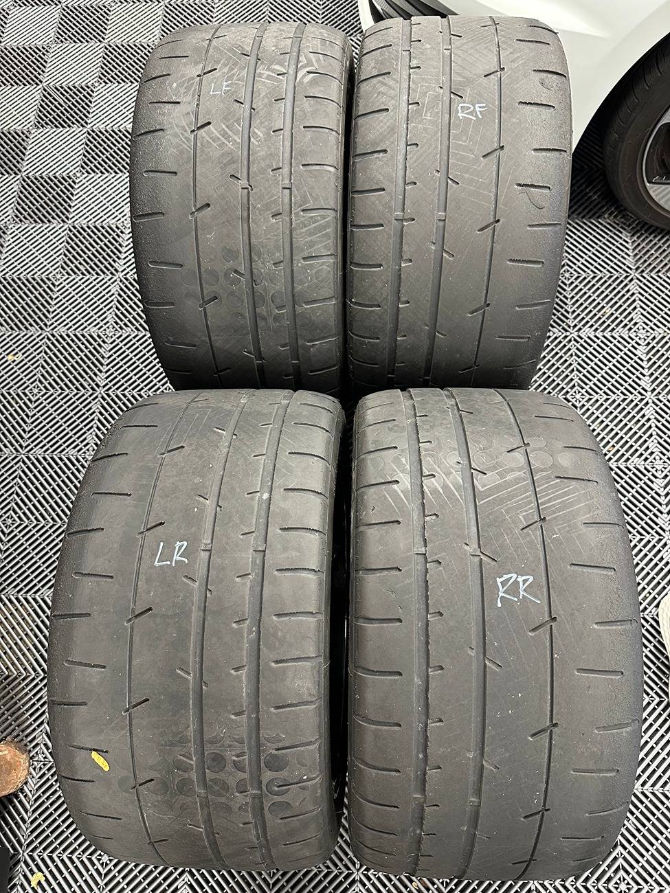

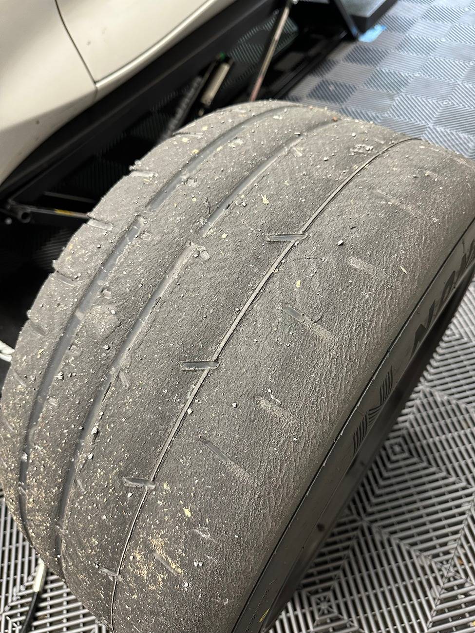

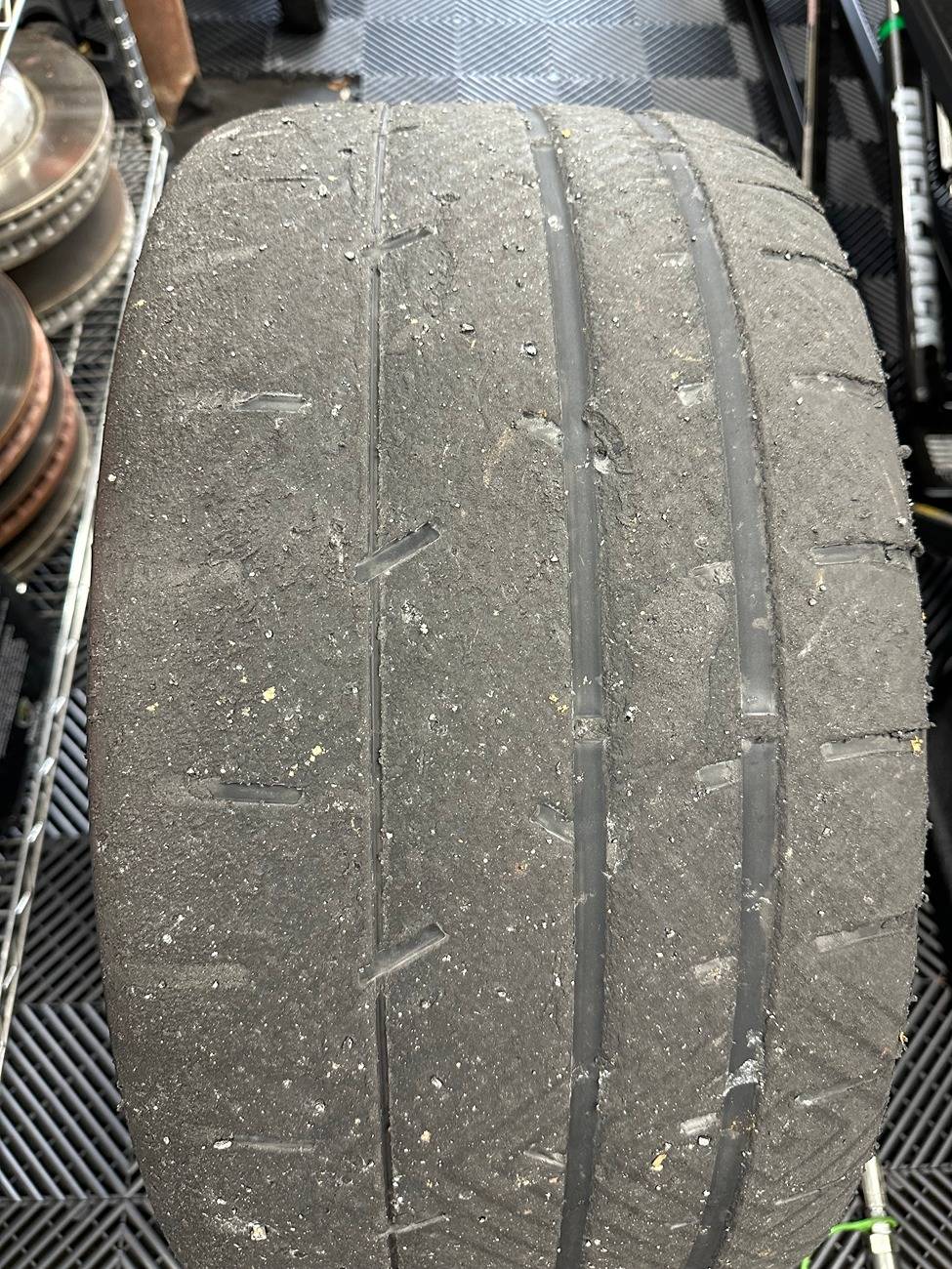

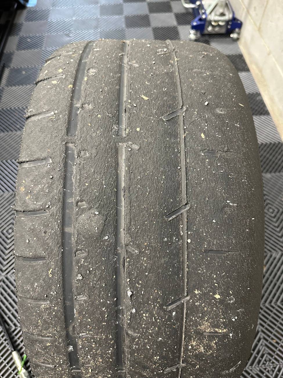

Alignment, alignment, alignment, alignment. Of course, this takes into account all your bushings and such are in good condition as well.
We've already been discussing this with @Rensuhlo in another setting but I figured I would make this post for informative and discussion reasons here.
Here are some samples of tire wear from my personal supra that is tracked 95% of it's working time and is driven to/from the track. The other 5% is street driving for fun or data logging purposes.
Alignment and relevant modifications:
Front
-3.9 camber
0 toe
Turner caster spherical bushings in OEM caster arms
Verkline LCA
SPL tie rod ends
SPL endlinks
Vorshit camber plates
MCS 2WNR 650lb springs
Rear
-2.5 camber
3mm total toe in
SPL toe arms
SPL traction arms
MCS 2WNR 600lb springs (true coilover)
Tire wear examples
Nankang CRS v2
295/35/18
18x10.5 (I don't suggest this width as this tire and size need at least 11" wide to work well)
Service time: 2 track days, approx 1,000 street miles after 2nd track day, which is why they look so smooth and clean.
Nankand CRS v2
275/40/18
18x10.5
Service time: 5 track days, to/from track street miles

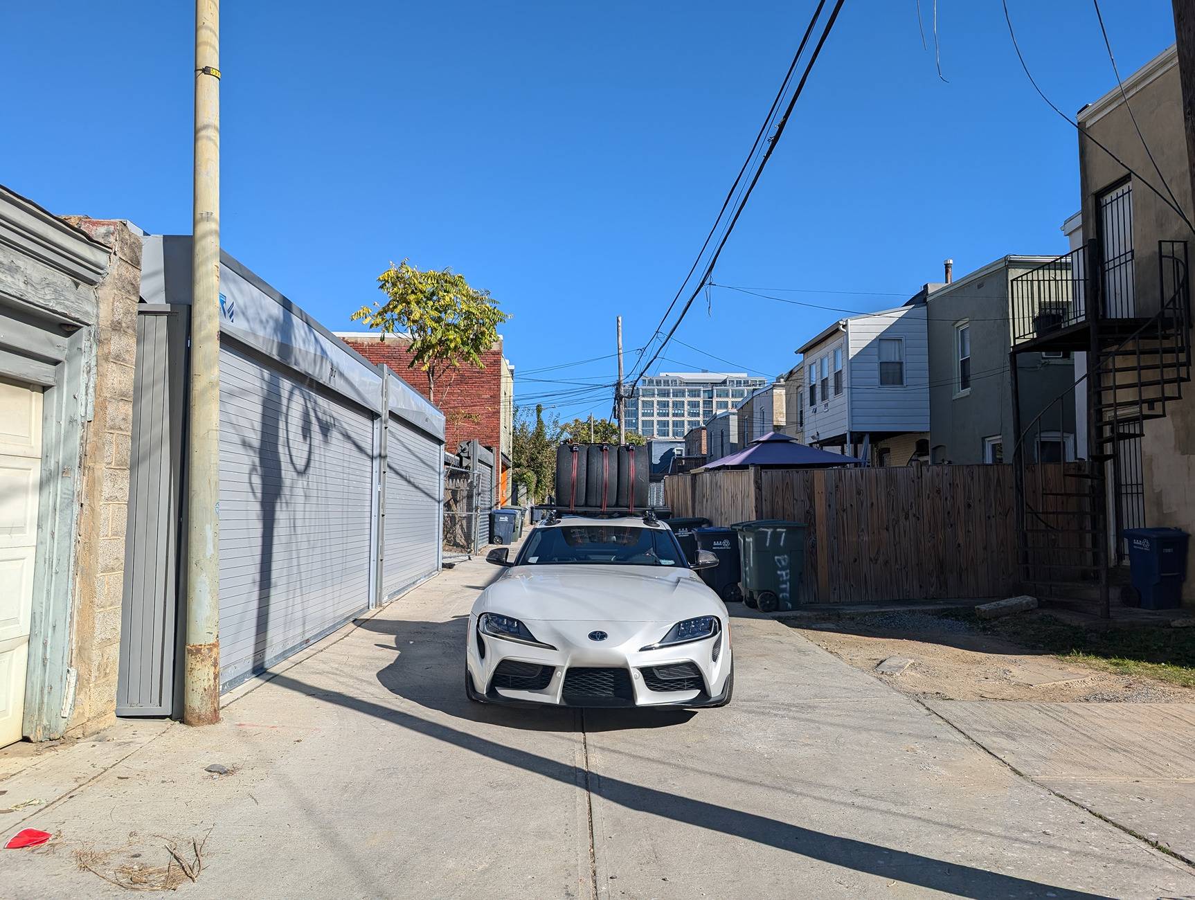

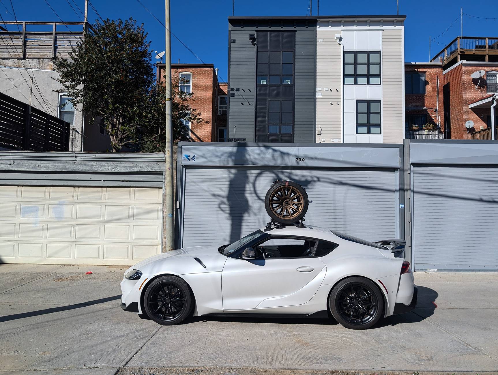

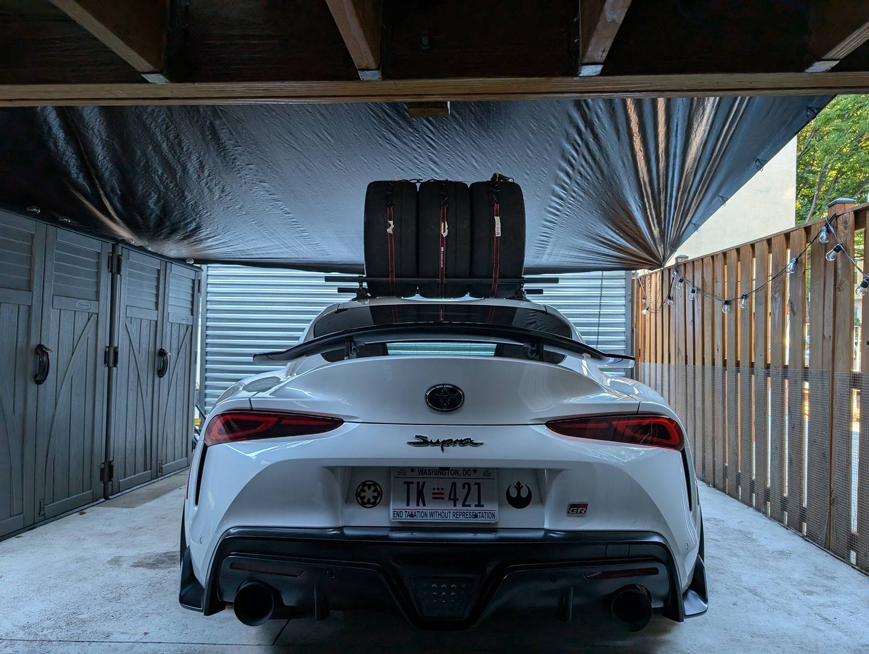

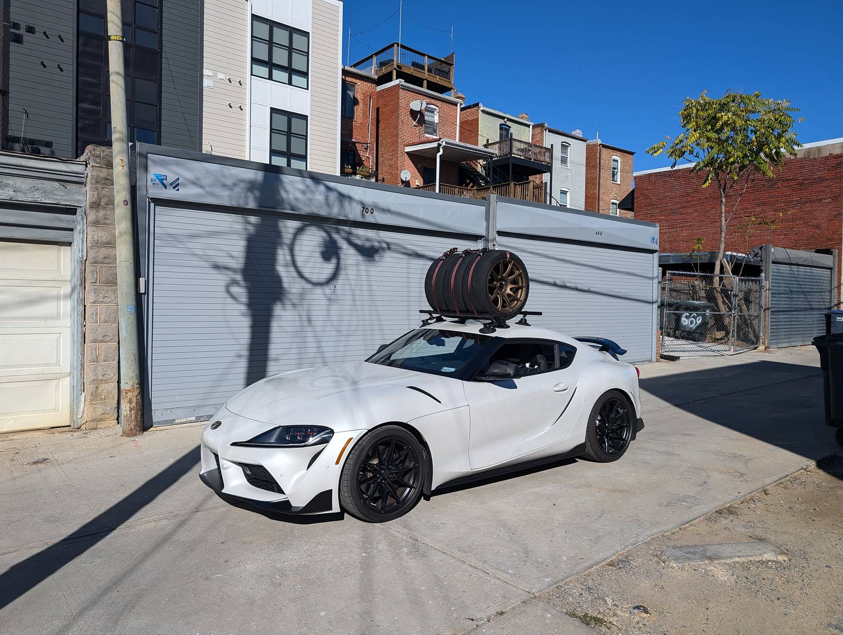

Did some test fitting and driving of my tire transport solution in advance of a trip to VIR. So far so good.... 4th wheel will go in the passenger seat.
I love it!!! That’s a great idea. When you going to VIR? I’ll be there also 11/15 weekend HPDE.
Thanks! I'll provide an update on how it holds up over a long drive. Hopefully there will be nothing of substance to report :) I'll be at VIR 11/22-24, I guess I'll just miss you.
