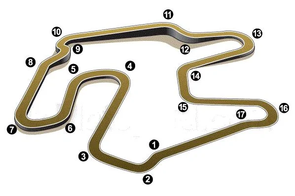

tldr; I'm a novice driver struggling with very abrupt/unpredictable oversteer
Hey guys, I wanted some of you more experienced folks' input here. Earlier in the week, I was at Chuckwalla trying to get a feel for the car after some upgrades/changes I've done over the past few months.
I had a pretty difficult time keeping the Supra composed during medium/high speed corners. The car seems to oversteer way too quickly/abruptly -- I like oversteer, but it feels like the car is on a razors edge once I feel it slip even slightly. I decreased the dampening/rebound a little bit in the rear coilovers to hopefully promote slightly more understeer to balance it out a bit, but it still felt way too unpredictable and twitchy when it'd start to oversteer. I've considered removing my Cusco sway bars and perhaps changing spring rates on my coilovers, but before doing anything too drastic and wasting time, I'd like your input.
Edit: I will absolutely not dismiss the notion or idea that I just don't know how to drive the car with the changes made, driver mod and all that. I have one more track day this year at Buttonwillow and I'm leaning towards keeping the car as is just to get more time with the car and it's setup and make micro adjustments early next year when I'm able to go to the track again.
Mods:
HKS Hipermax R Coilovers
Spring rate N/mm(kgf/mm): Front 137 ( 14.0 ), Rear 196 ( 20.0 )
Dampening/Rebound: Front 22 clicks (30 stiffest/max), rear 15 clicks (30 stiffest/max)
Cusco Front & Rear sway bars
Front: 28mm OD hollow
Rear: 22mm OD hollow
Tires: Yokohama ADVAN AD09 (Square)
295 35 18R
Alignment
Front
-3 Camber
0 toe
Rear
-2 Camber
.22 toe
Just for reference, here's the track. It's a free-flowy track and I feel like shit that I'm struggling so much with the car here.

I don't really ave great answers for you, but that's one of the reasons I try to go slow on the upgrades and test between each and everyone of them.

That is a lot of spring and a lot of comp/rebound. What are your tire pressures?

Had the alignment checked recently?
I don’t know that particular track but you can try going softer on your dampening. It’s possible to be loosing some contact patch if set too stiff. Bleeding your tire pressures down as the day goes on is something to consider as well.
