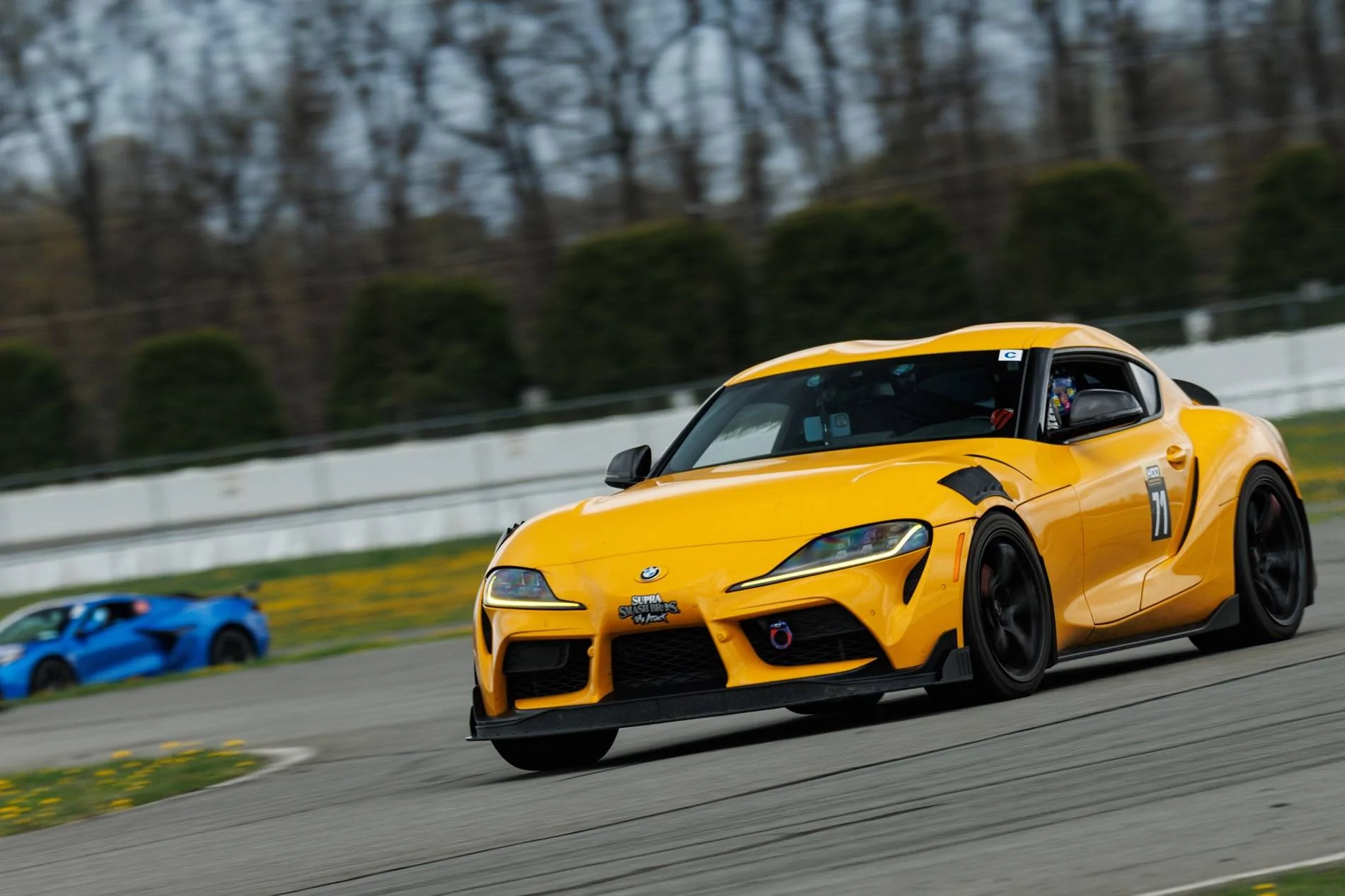

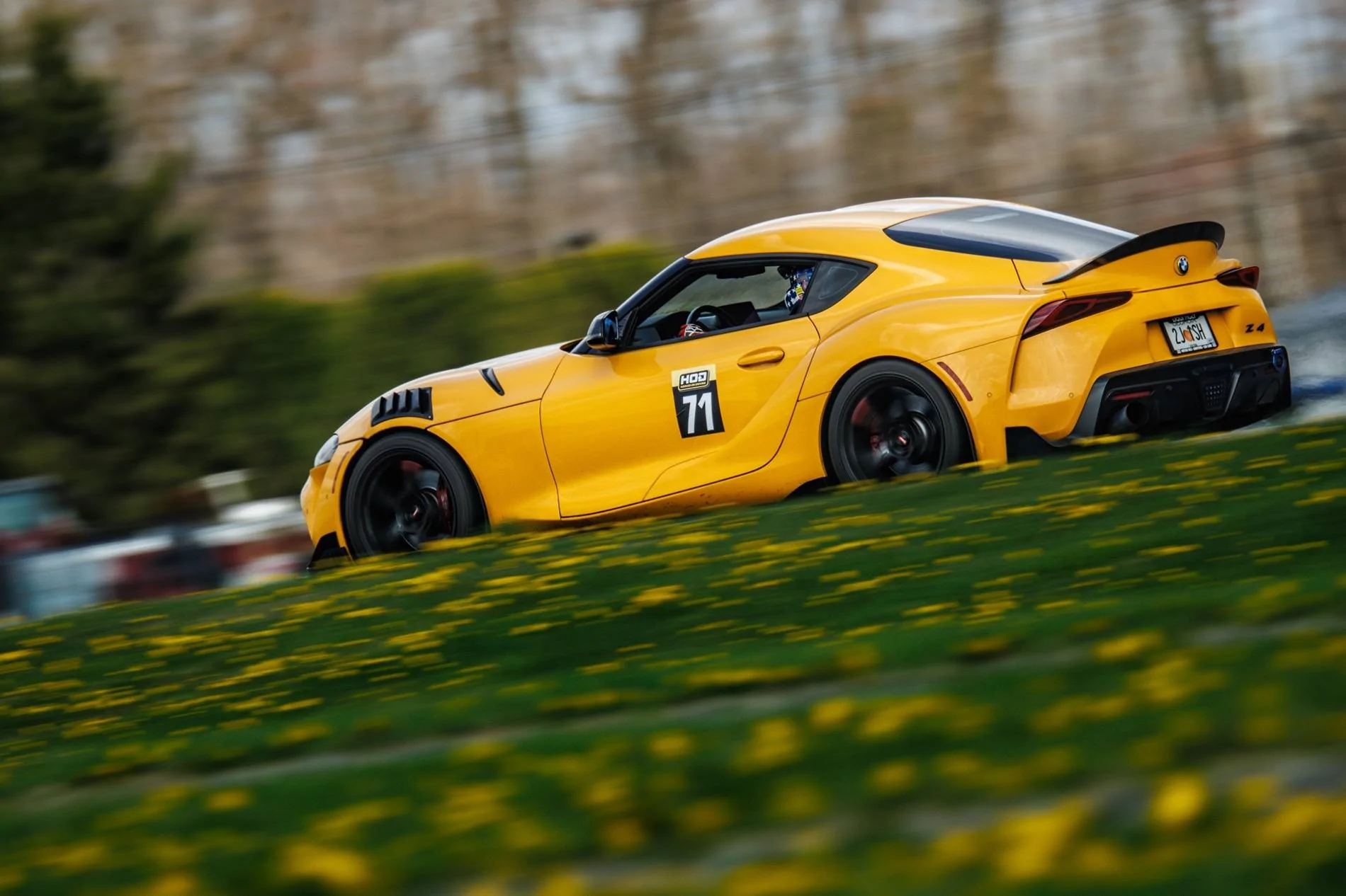

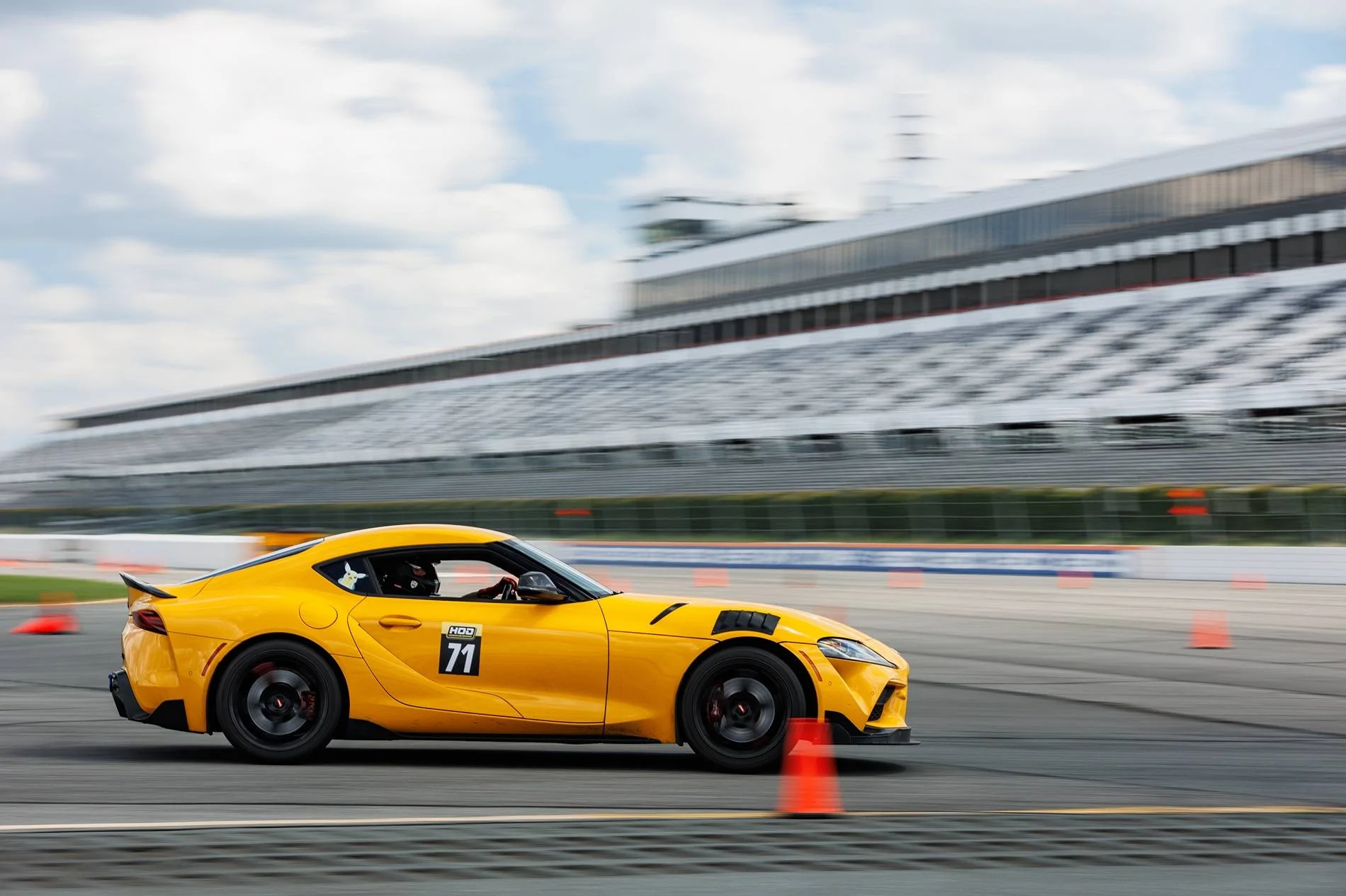

Received my photos from my Poconos Raceway track day. Hooked on Driving NE offered me the chance to do Megacourse totally for free, so that I have a baseline of what the experience should feel like (I'm assisting with the development of a HoD Mid-Atlantic chapter).
I was blown away by the level of professionalism and fun environment they provided. Check them out if you're in the area!
Videos are on my YouTube but honestly nothing exciting to share as I was focused on the experience, not times.

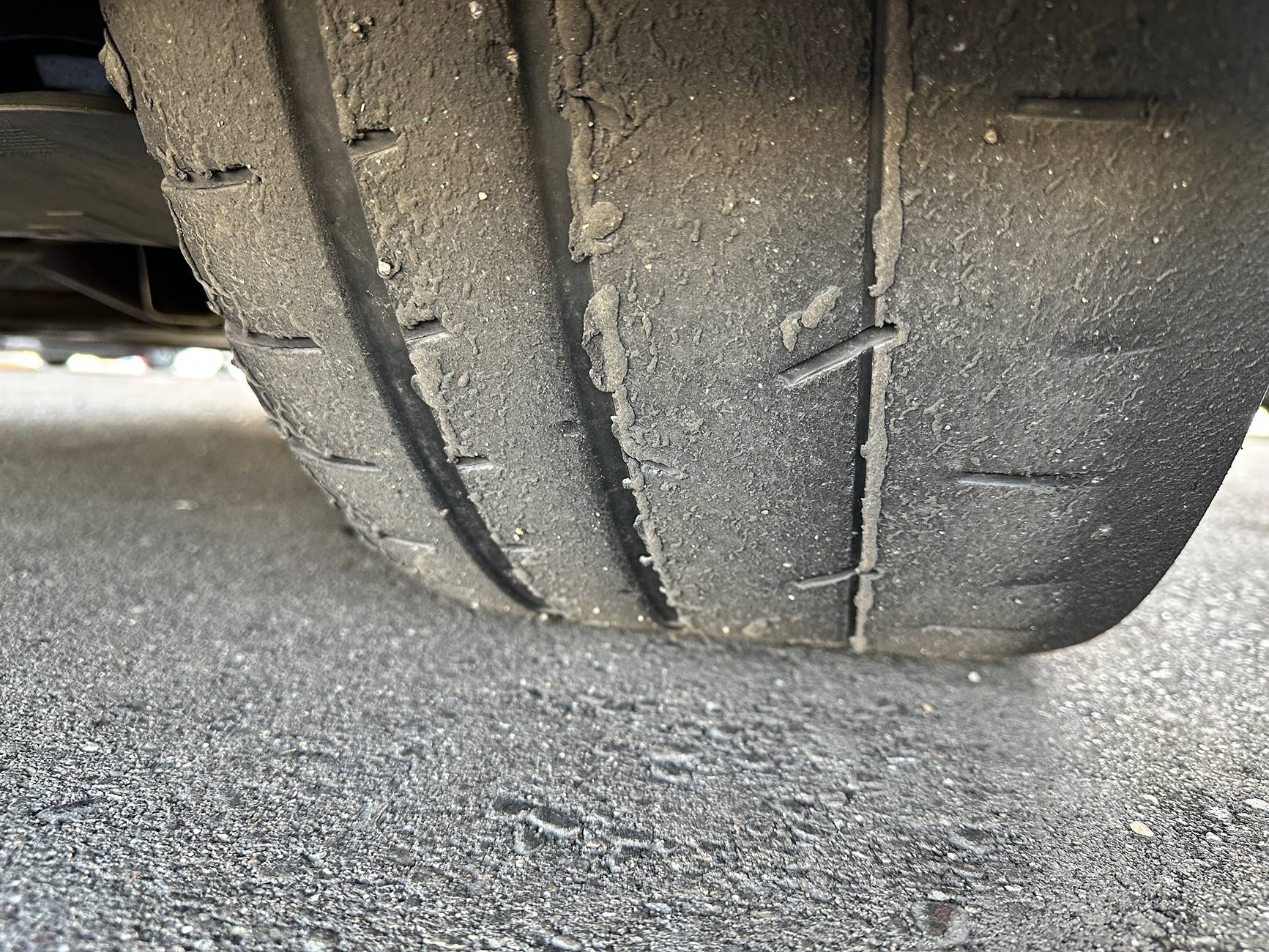

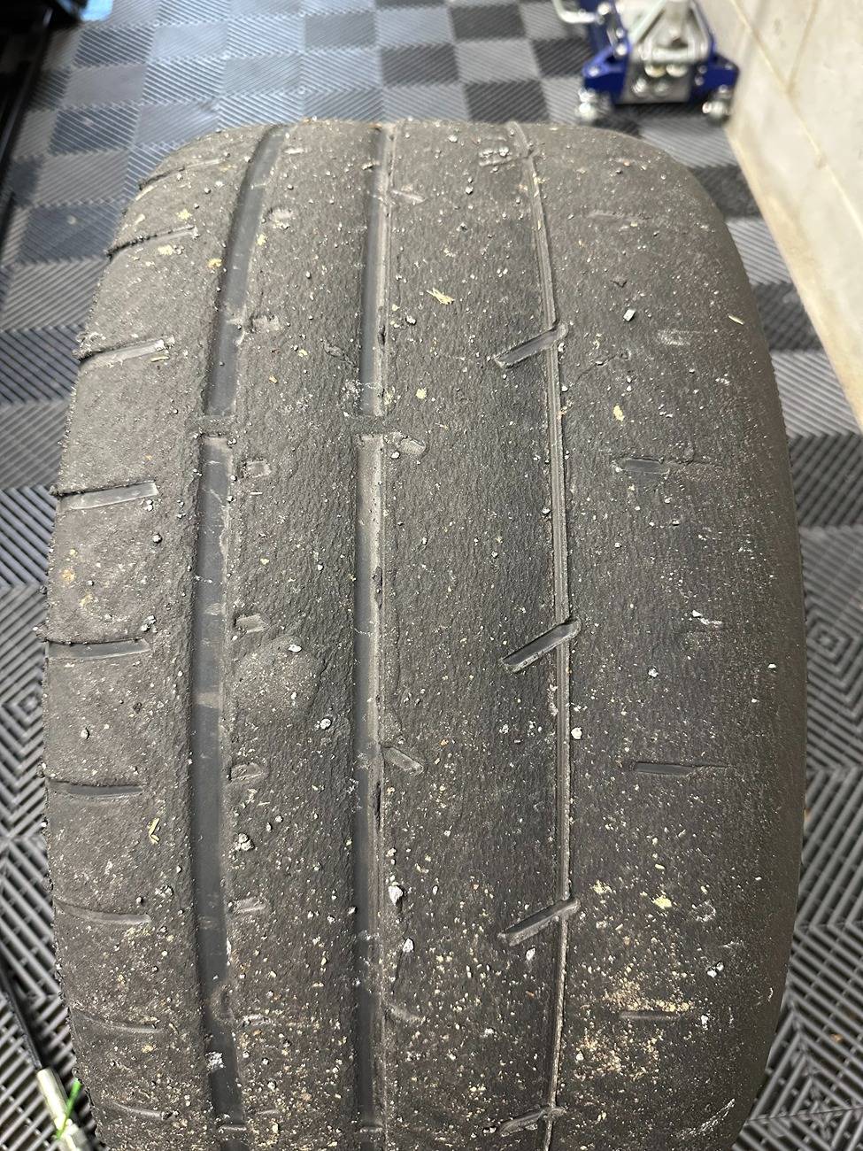

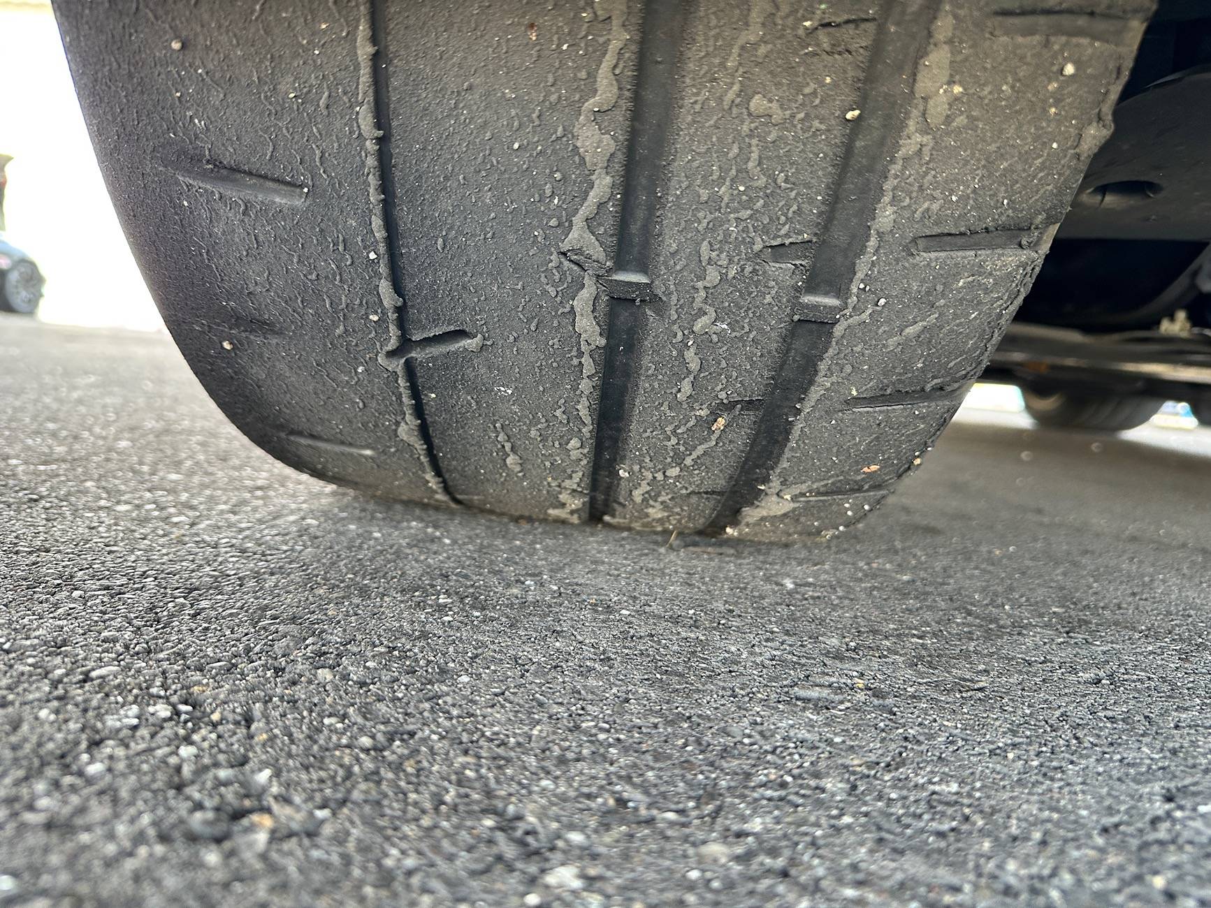

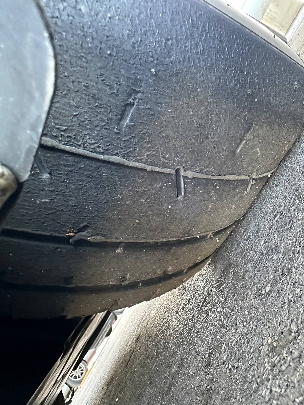

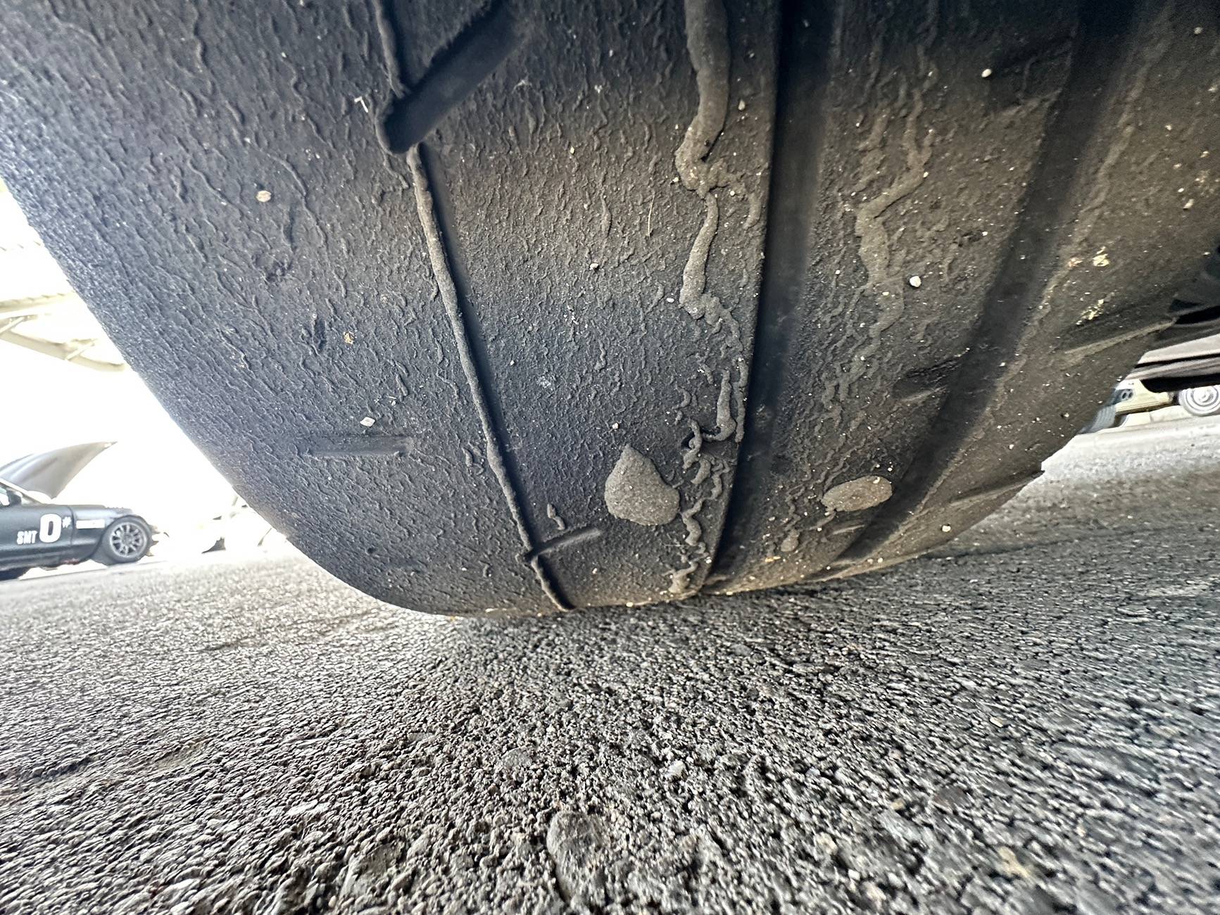

Can I get some advice on my tire wear?
Nankang CR-S 275/40/18 squared
At the track already, but think they’ll last another 8x20m sessions? Otherwise I’ll need to buy some cup 2s here and they’re expensive af

Look fine. Although you could use some more negative camber.
Flip them on the rim. Need more neg camber and possibly more pressure (consult pyrometer)

I've run countless sets of CRS. that is pretty normal in how they wear, but more negative camber wouldn't hurt. What are you at currently @Mori ?
The CRS will heat cycle out before even thinking you have to flip the tire on the wheel. Waste of money to do that with CRS, just put the mounting cost to a new set.

Like mentioned, people will usually put as much negative camber as your setup will allow w/out rubbing (compressed during a hairpin turn) up front. Those tires should make it another day or two, depending on how hard you push it.
