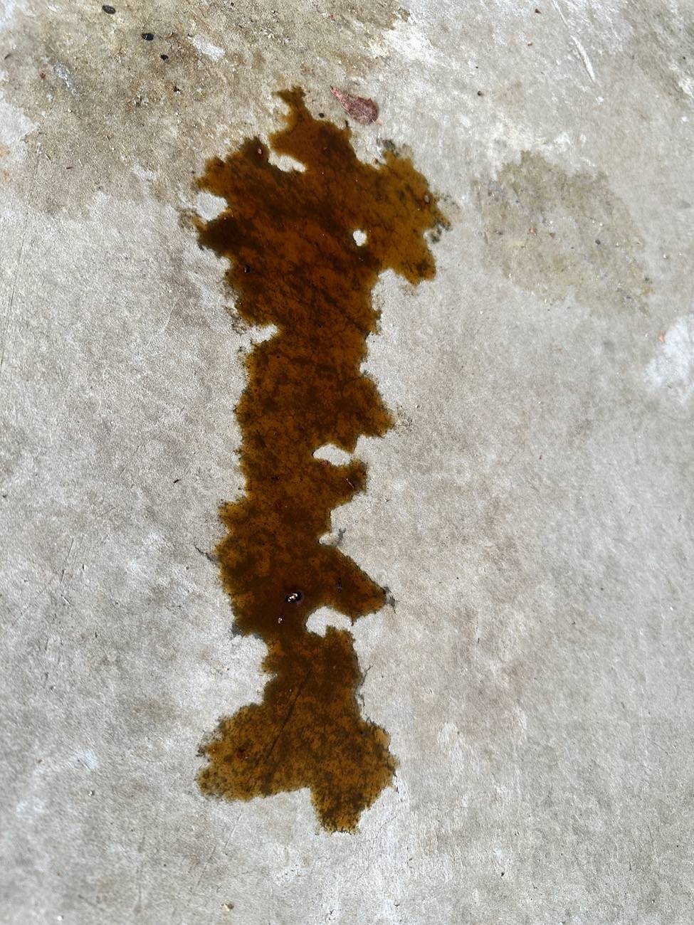

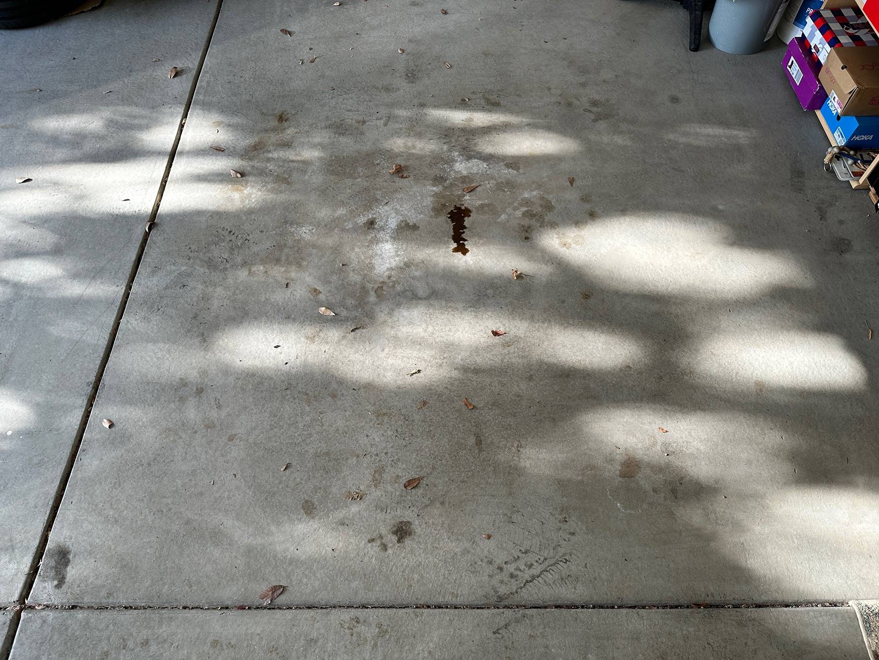

seems like I’ve got a small oil leak after a weekend of tracking (2x 5x20m)
location seems to be right where the oil pan is, though the engine level measurement says oil level is fine.
Happen to anyone else? stock, only mods are suspension and catted DP
