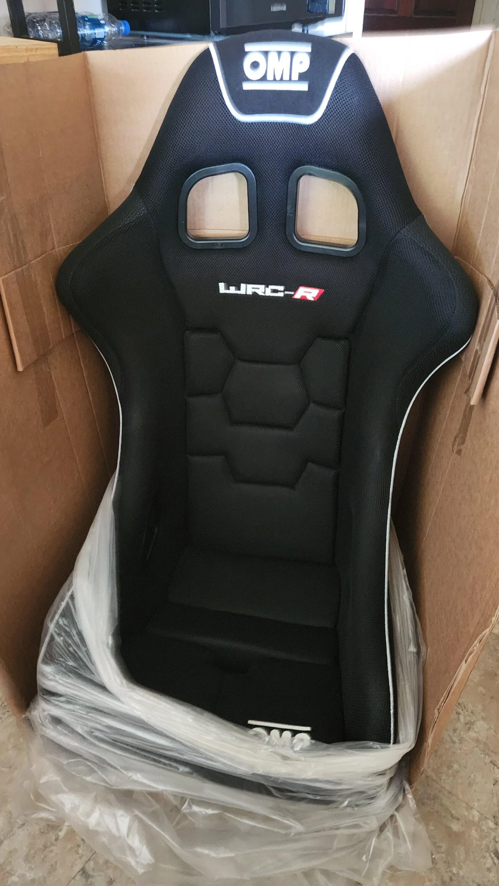

As we've all discussed before: Tracking a completely stock Supra S U C K S because of the seat. I can't possibly brace myself in the car enough, with my knees and the dead pedal, to NOT have to hold onto the wheel to keep from moving around in the car. My entire core is sore for three days after LOL. My lap times are telling me I should have done this long ago.
So... I got this. It holds me so well, I theoretically wouldn't even need a belt. Perfect fit, especially compared to the seat I had in my last car (it was honestly just a bit too big).
This is gonna help so much more than any power mod I could have added.

The WRC-R's are awesome. At some point I plan on replacing my cheap ass sparco bucket with one of these.

My last seat was a Sparco Evo US and I liked it, but it was a bit loose fitting, seeing how it's for American chubbies LOL. I tested this seat at Wine Country and I was like "aaaahhhh". LOL. It fits PERFECTLY and I think I could easily drive 3hrs to a track day in it. It was TOUGH not to go with a Sprint or something for half the price.. but I JUST drove from Fresno to Sonoma, so the trip was fresh in my head. I knew I'd want something better. I'm sure you have a better model than a Sprint, so it's no quite so barbaric. ?

I have been happy w my Sparco. Have an old Sparco sprint shell I am going to install in the right space now. Get too many requests for rides not to have a passenger seat. Trying to figure a quick way to take in and out but the belts will make that hard

It's at Sonoma Raceway, but only average price LOL. Fault codes are programmed out, so no worries there. I just can't drive the car comfortably with the OEM seat and a helmet. I give up. ?
