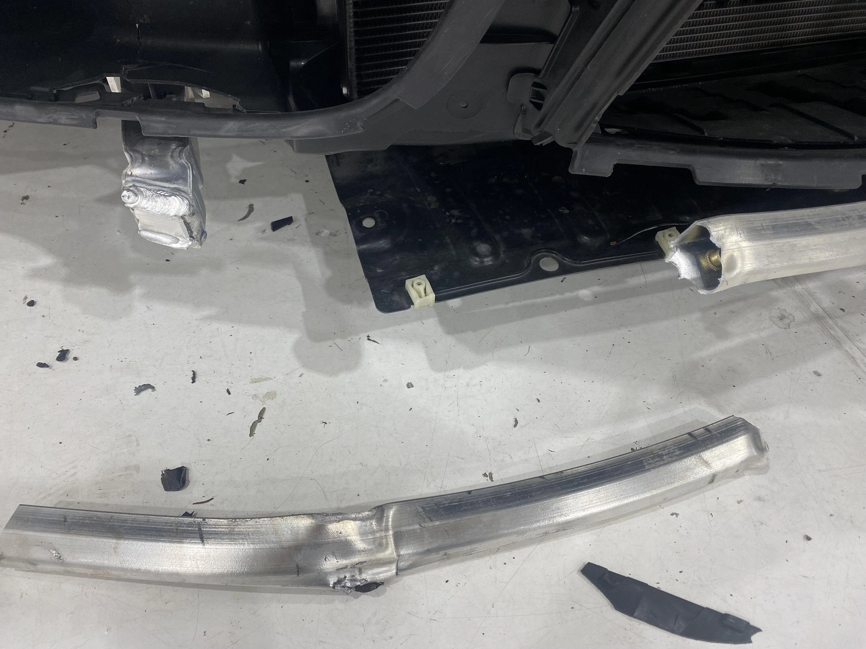

I think the frame will bend before the Verus splitter gets damaged. That thing could probably take a direct hit from a ballistic missile.
For the record, the splitter attaches to an aluminum crash bar that weights about 1lb. It not that strong and it will bend, and the splitter does brake as well.
The crash bar is only a couple hundred $ to replace, the splitter of course is more expensive.

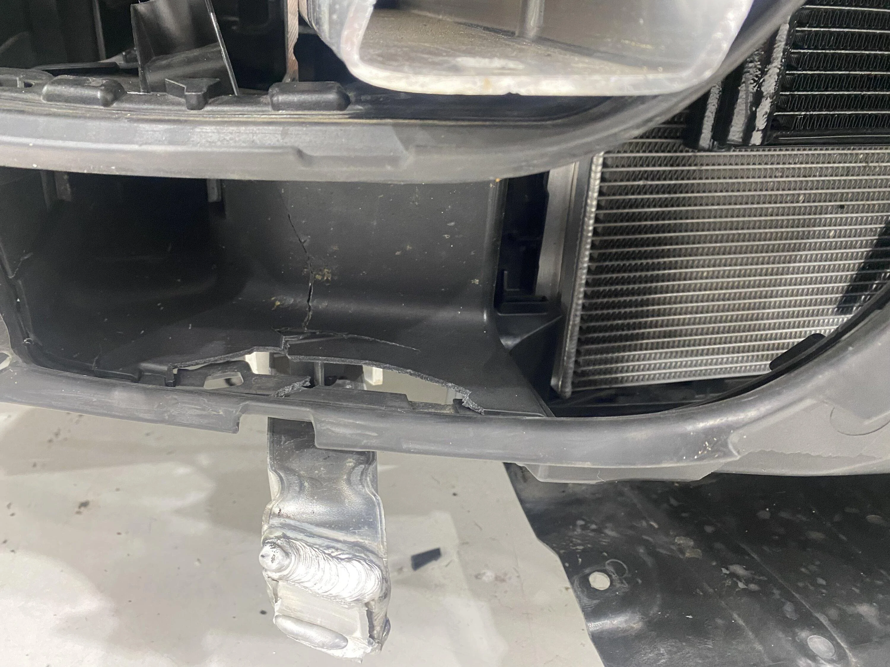

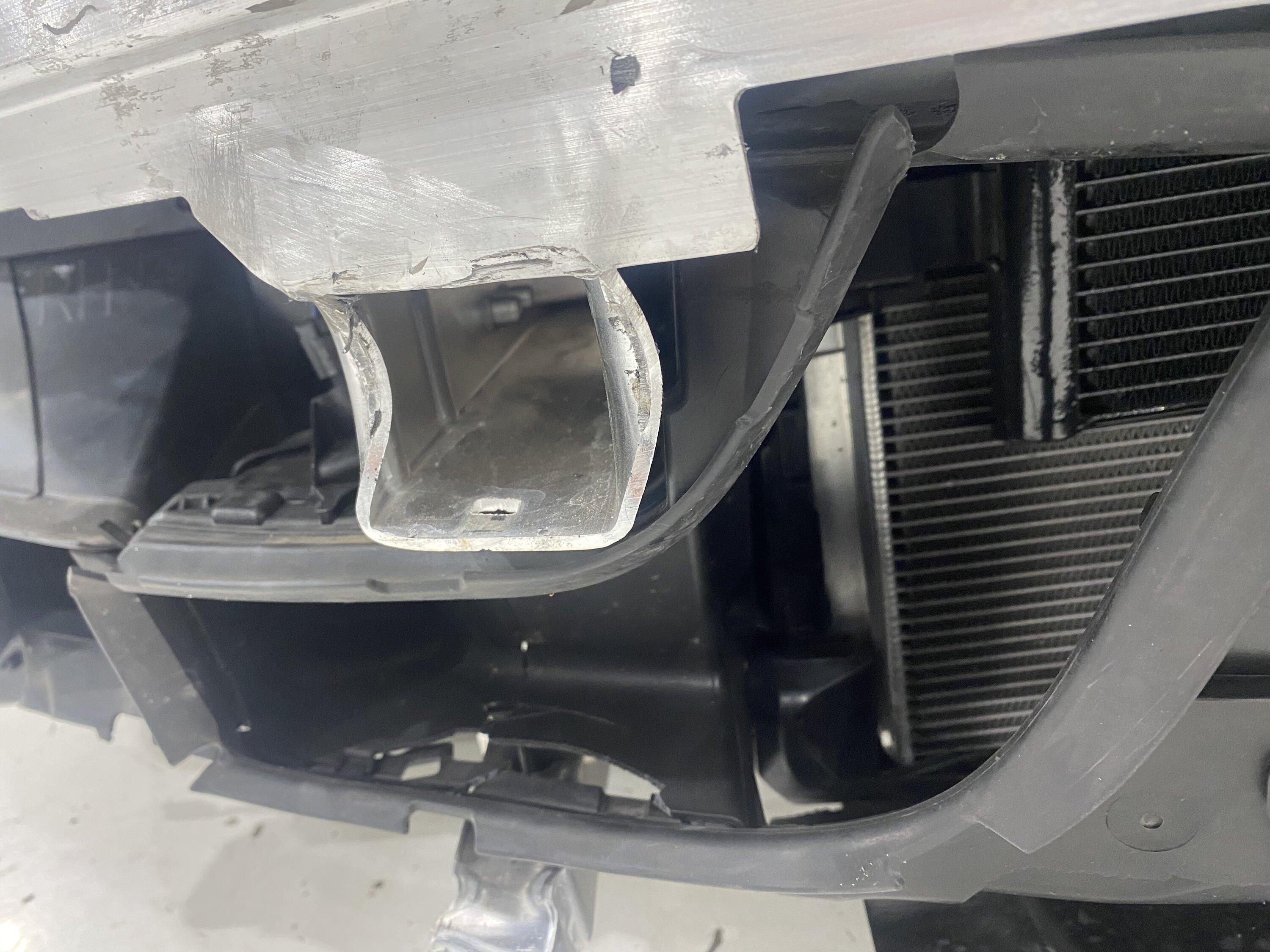

you're telling me those rivetnuts held on for longer than the crash bar? would have not guessed that mode of failure. i wonder if a jabroc splitter would have held up better than the 2 part tegris that verus uses
are you running any reinforcements there now?
kyle9
Kyle
May 19, 2022
426
574
The rivnuts held well enough to destroy the splitter blade and tear the crash bar in half, as seen in the pic.
There isn’t really any way to reinforce things in the sense that ultimately something has to give.
I am running the lower crash bar to upper crash reinforcement from Verus now though and personally would not recommend anybody stand on the splitter blade for any reason.
