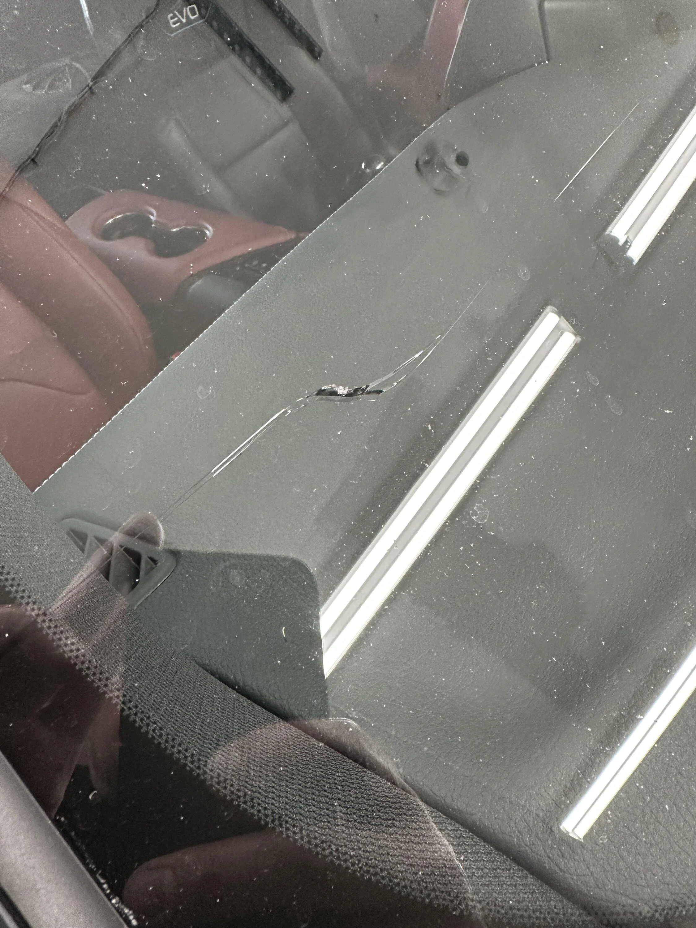

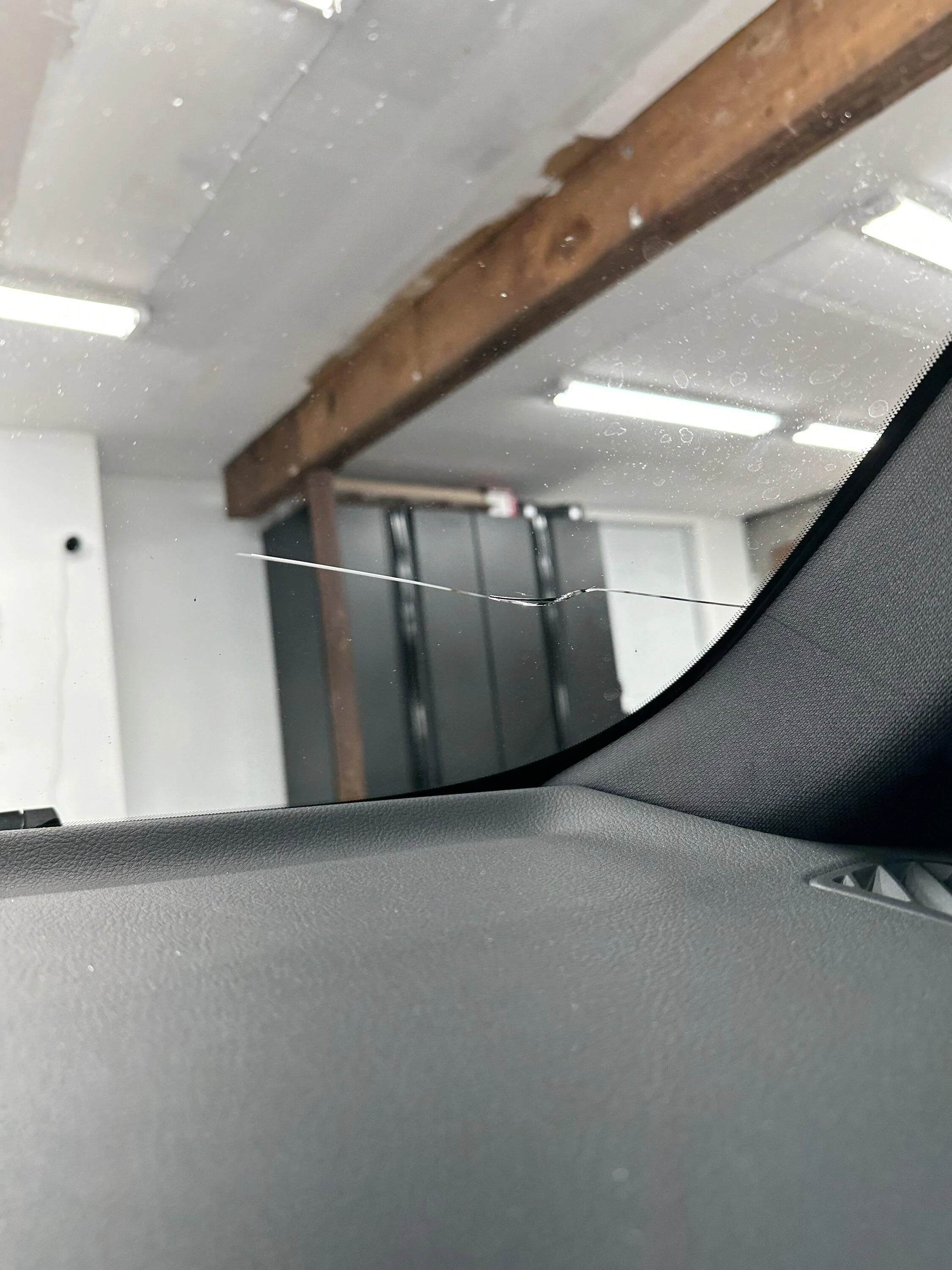

Finally joined the cracked windshield club. Which is fine because the windshield itself is pitted to hell, time for a new one, just hope safelite here doesn't suck.
I never heard this happen but I imagine it was a small chip from my track day this weekend or drive home. It was not like this on the way home, I came out to the car this morning and saw it. The temp change in the garage over night must have made it start cracking.
Dang you did her good son! That’s some mega flex crack right there. You must be hauling ass on track ? This is my 3rd windshield and reminds me to bug my PPF guy who wants to try a solution he and a UV manufacturer came up with. I’ll let y’all know how it turns out.
I just got my first chip on my way home from Maine on Monday on 95. Asshats leaving piles of gravel in the middle of the interstate. My chip is not yet a crack so hopefully I can put off replacement until the end of the Summer.
Why not fix the chip before it turns into a crack?
