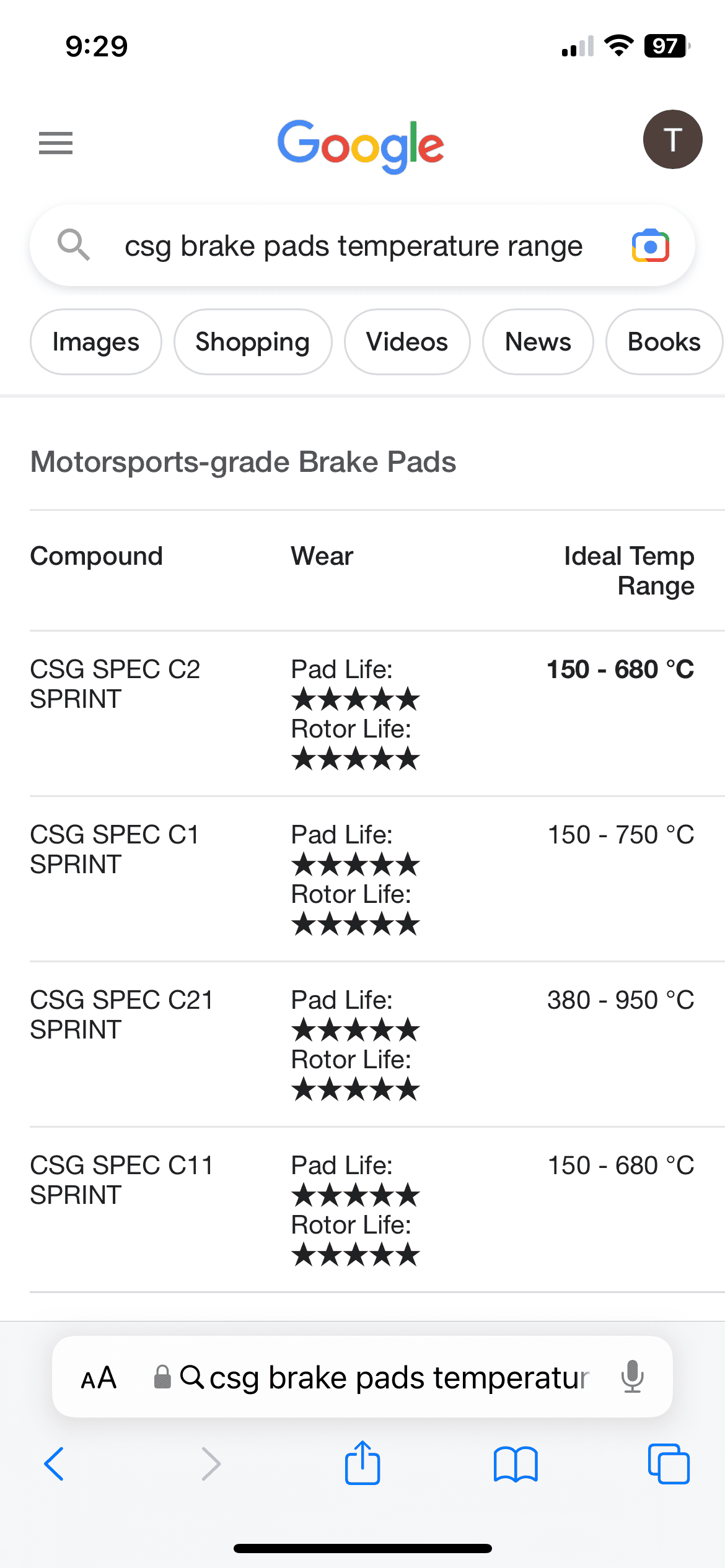

In my case they were new but bedded CSG C21 Front/CP Rear that had been bedded. Rotors were old but now are new fronts, rears I think are fine because the shudder is from the front but might replace the rear rotors and pads (going to CSG C11). It's really weird because the car stops just fine otherwise.

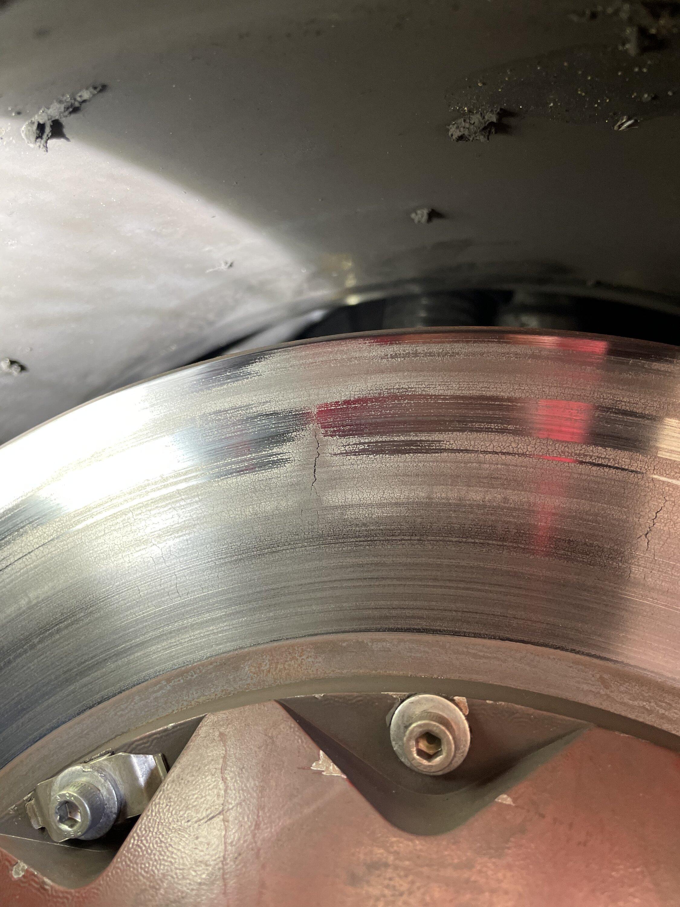

I still expect it is rotors and the pads. If the pads are aggressive and then depending on heat levels can warp them. Even a new set depending how they are bedded in. You can take and get them turned an watch when they do it. It will tell you if they a not flat. I am still dealing with heat issues on the front and am cracking rotors from heat stress. I have versus brake duct and vented fender. So as your speeds increase you will have more issues with brakes/ pads trying to manage heat.

I expect the fronts are warped. My heat range is 1300 to 1400 and Jayne even higher as it us at 1400+ color on the paint guide. They come off at 800 to 900 . So are definitely running in the 1000+ mark. Which is above both of these pad ratings. So I would get heat paint and find out what you are running and can match pads to operate in that range. This is why I have landed on hawk dtc70 or 60 both are in the range. Go get fronts turned and you will find out. I gave trashed a set if rotors in a 3 day weekend. So still trying to figure out brakes.
