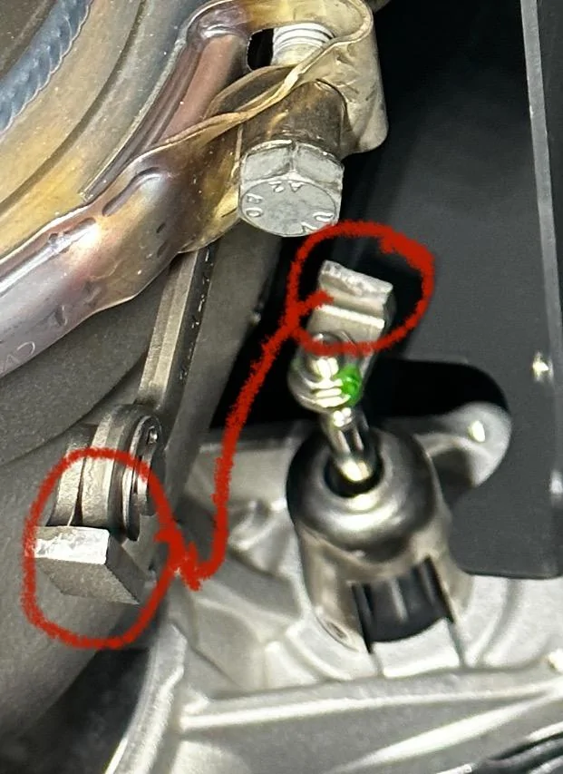

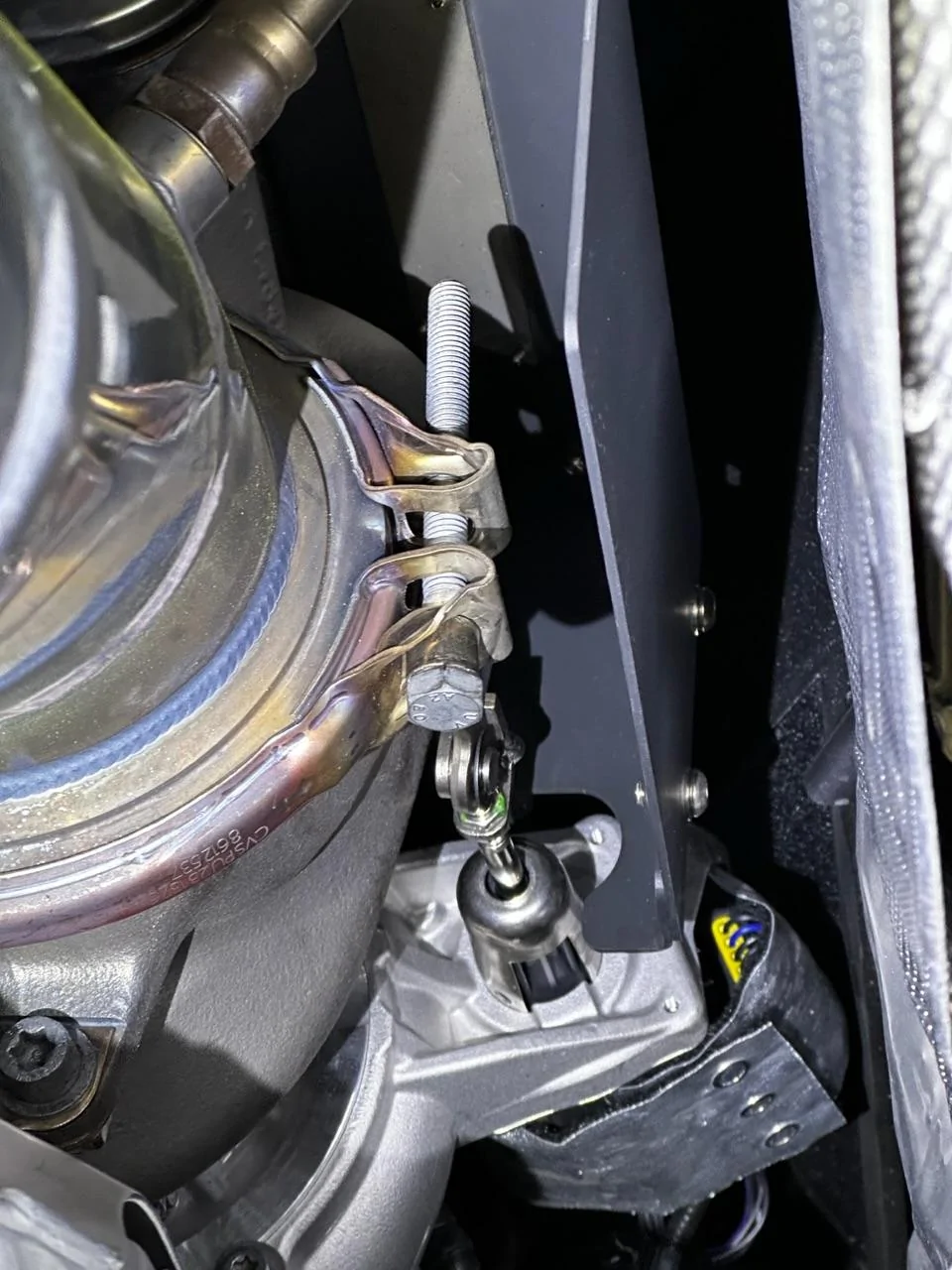

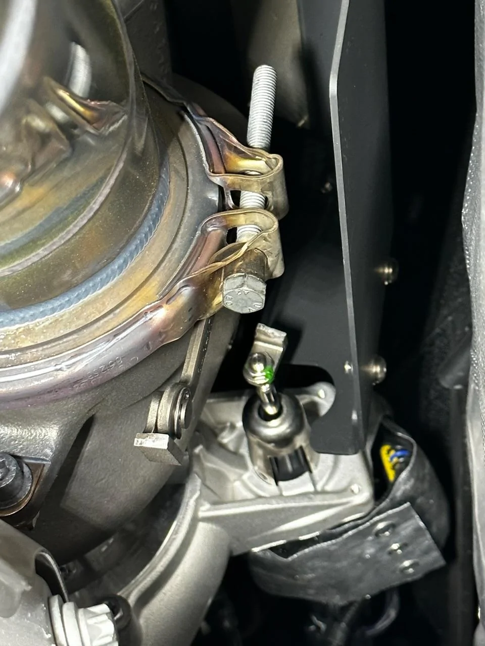

Was thinking where to post this, and thought it fits our group the best. Doubt this will ever happen to y’all but… I could feel my turbo was out or the car was in some kind of safety mode. Turns out it was the turbo.
My wastegate actuator rod bracket snapped (the one that joins the vacuum rod to the wastegate door arm). Definitely not a part Toyota sells. I’d have to buy the entire wastegate on parts.toyota.com (great website btw).
Luckily my awesome independent mechanic made the part beefier ?
It was likely faulty, or just couldn’t take the heat ?‍♂. Regardless, highly recommended finding a good mechanic you trust in your area. The fix was way cheaper than the part would have cost me. And less than one day in the shop. I wouldn’t even want to guess how long my car would have been down and out at my local dealer, waiting for a “Supra” tech, and finally hear it’s not covered by warranty ?
Told my wife and she said it’s a track car, what do you expect? Damn I love ❤ her!
Edit: only @zrk might see something like this with extra boost or hp? But I’m thinking it was likely just mega random.
That part broke because your downpipe v-band is installed incorrectly and the arm is hitting it. Surprised you get full boost. Clock the v-band so that the bolt isn’t in the path of the waste gate articulation.
