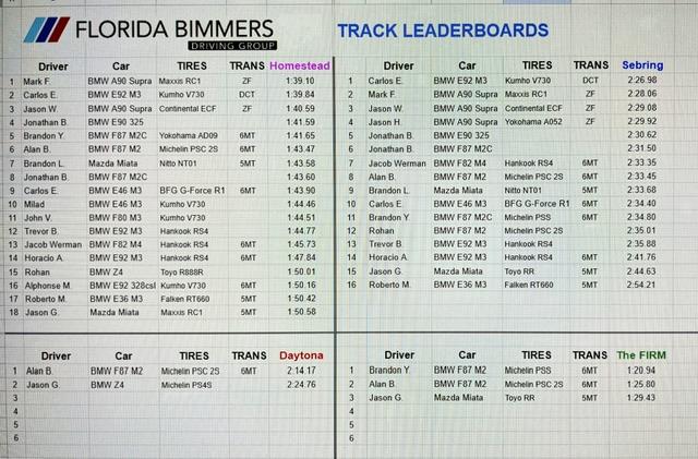

@kaj or anyone else, any further thoughts on putting up a track times spreadsheet? A BMW buddy threw us Supras up on his group list. They do some time trial stuff. Would be fun to give it a go, push her even more, if I had the time. That was just one weekend at Sebring post Ohlins. I’m sure I can get both times down even further. The Garmin has some great suggestions now too ? Awesome tool for the money, imo.
@1slow_mk5 has the fastest times, btw. Need to put him up there.
