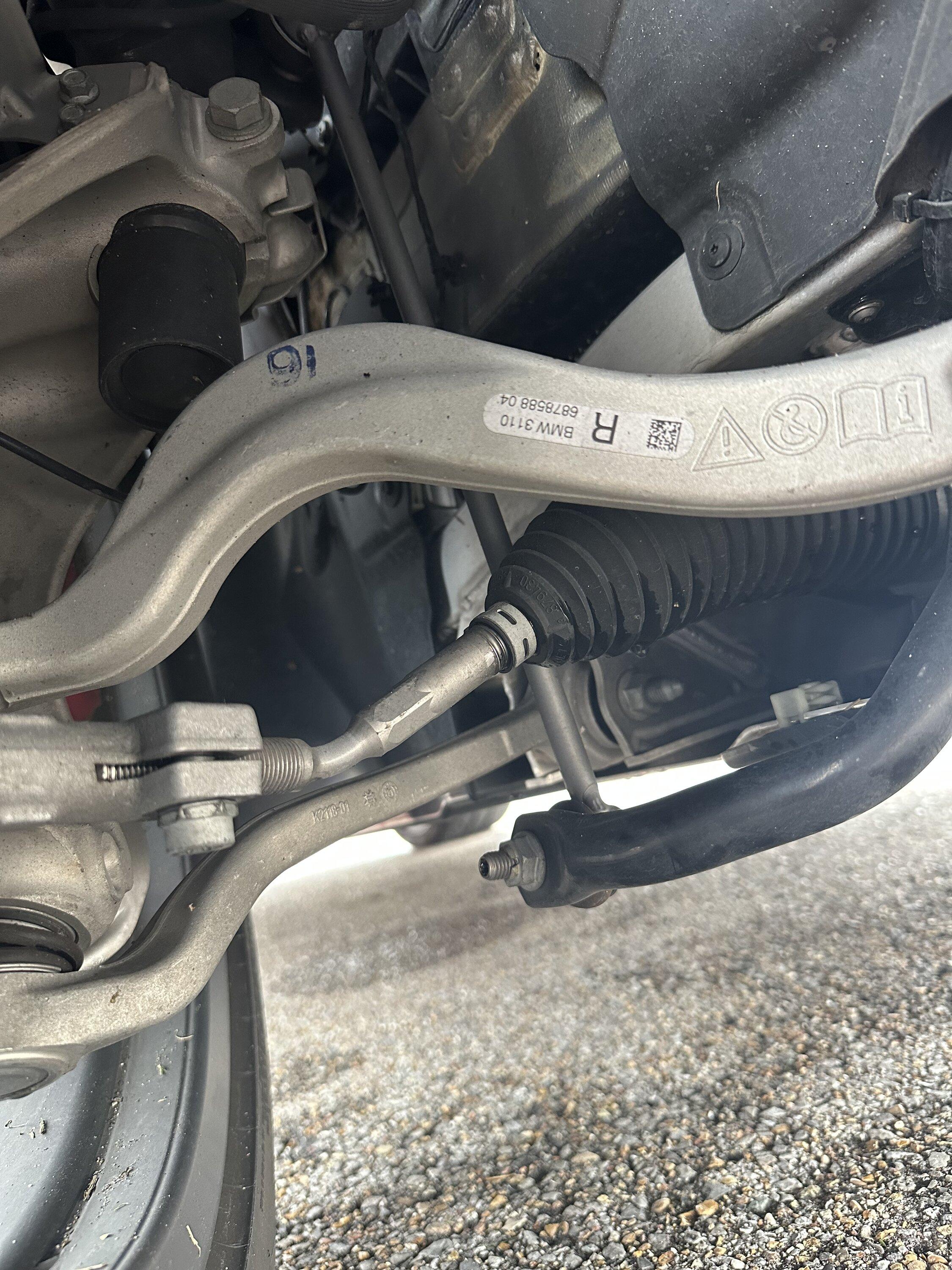

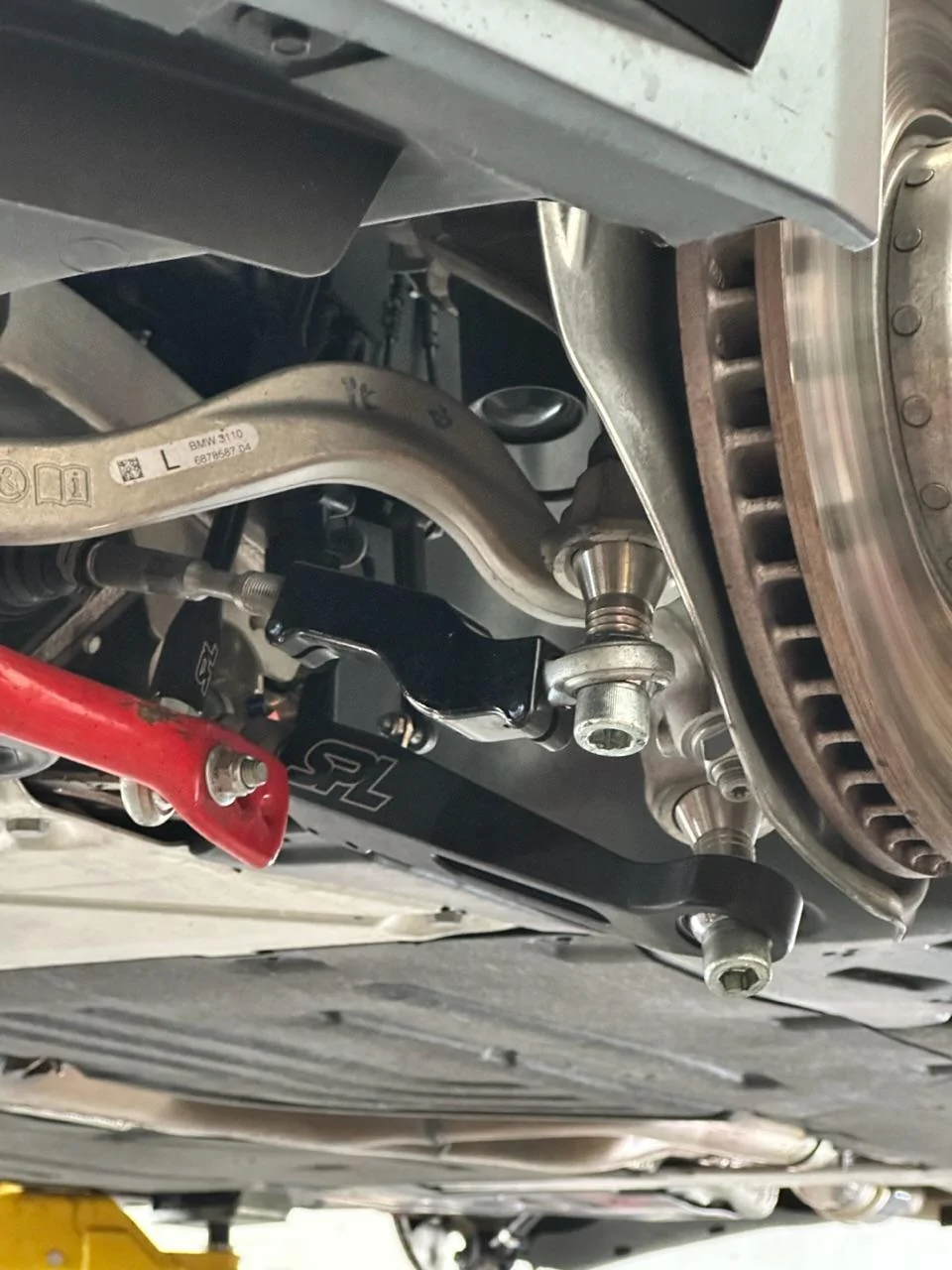

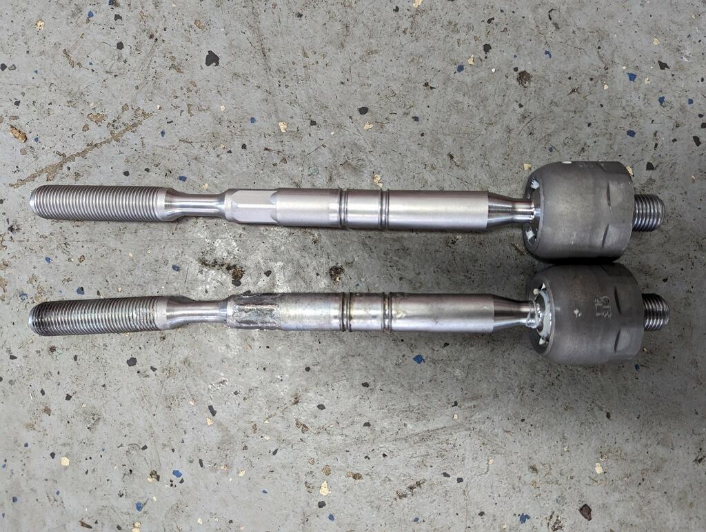

So I bent my tie rod end when I spun off track at NOLA Motor Park, I didn’t even hit anything it just bent when I went off into the green. I’m lowered on H&R springs with about -2 degrees of camber. Can the SPL tie rod ends be my fix? Some other Supra guys there said they’ve had this happen to them too…
garudathree
Jun 9, 2021
293
345
ny
none
do you have a pic of the other side of the lca? are there witness marks? do you have bumpstops installed after swapping to lowering springs? it's possible your suspension ran out of articulation, and the lca bent the tierod at max compression due to increased compression travel from bumpstop changes. the spl tierod kit allows you to space the knuckle end lower (fixes bumpsteer angles as well), giving you some more room.
I did this not once but twice until some thread, somewhere, a few peeps mentioned to remove some of the “spacers” (forgive me if the terms are wrong) on the SPL endlinks so there was less stress on the tie rods. And viola! No more bent tie rods. This did fix my issue. But I went a step further and removed my really slammed down lower than stock street/sport springs. Now I’m on Ohlins coilovers & springs with increased height. Stock springs should be fine as well, if you don‘t want to mess with SPL parts.

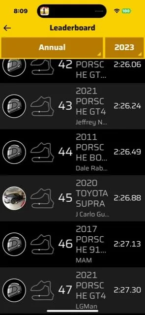

This past weekend was my 1st at Sebring on my new Ohlins. My track times went down by ~ 3 seconds (confidence up by 3 seconds) ?. When I use to run my ND MX5 there, lowering spring and sway bars were all I needed to feel more confident. So I assumed my Supra needed the same things. However, this Supra really is quite capable without a ton of mods. My “optimal lap” from the Catalyst is now in the 2:25s, if & when I can piece all those sectors together. I’m really loving the Catalyst for ease of use and track analysis/feedback.
My fastest time was 2:28.06 and I’m running lots of 2:28s, but wanted to show y’all @1slow_mk5 and his stock Supra running 2:26.88 at Sebring. He is on 200tw tires and Hawk DTC pads. But that’s it ?. Gotta love it!!!! More proof seat time and professional instruction = best mod ever, for us track rats ?
In addition, Carlo’s 2020 Supra (no. 45 below) has less power than the newer Supras and he’s completely stock. Food for thought ? . However, I still enjoy spending money on mine and pretending that will make me faster on track ?
For reference the fastest BRZ/GR86s was 2:43-2:45 seconds at Sebring. Any newer driver typically runs over 3 minutes (regardless of the car they are driving). The track is over 4 miles. So these BRZ/GR86s are really cool cars for the $$$. But this Supra is way way up there with much higher priced cars, time wise on track.
Good comments, I need to examine the other side. From what I’ve seen the brief time I had it up was just the the end link itself was bent and nothing else. I do have the bump stops installed that came with the H&R springs. The end link comes as either an assembly or just the end link knuckle end by itself. I’m assuming I’ll need the assembly so I get the actual shaft that is bent coming out of the steering rack correct? Does the SPL one come with the shaft or is it just the knuckle?
8,615
16,896
SPL is just the toe link.
