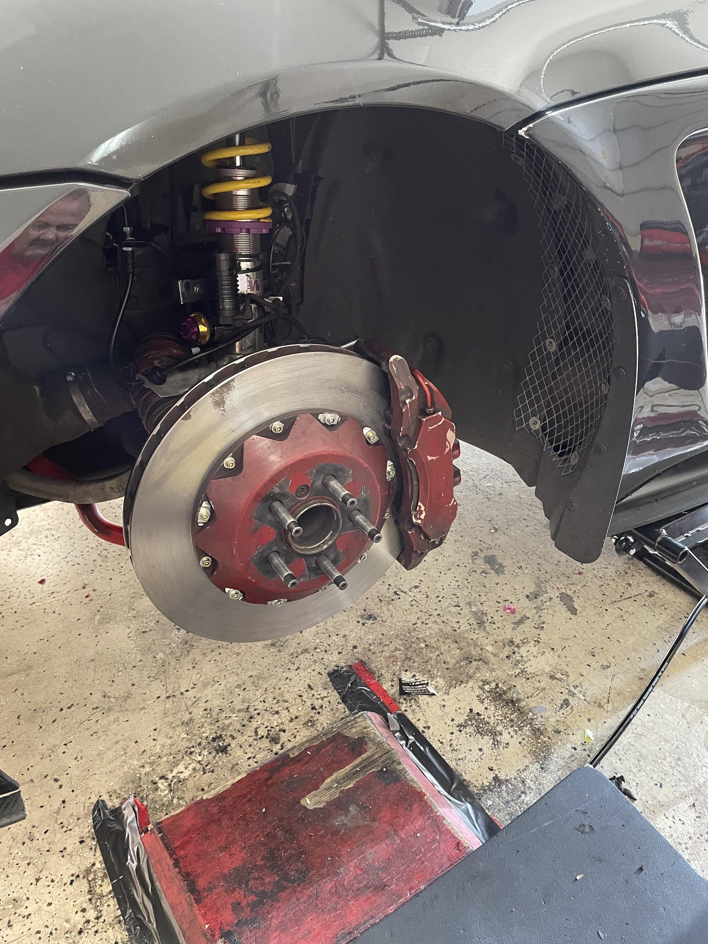

What vents are those in the top of the fender. In bought a set from Saber design but they seem too flimsy so was looking around for some that are stronger. I also plan to screen the hole over the liner so will not take out the liner completely.
i use sayber vents as well, no issues.
They are sayber fender/hood vents above the wheels.
They are flimsy junk. When the engine bay gets hot they crack and lose what little structural rigidity they had.
I would sell them to someone that street drives their car and not put them on a track car at all.
That was kind of what I thought. I have verus hood vent and that is much better. So I did not want to cut hood with them so are sitting on the shelf. I have their vented fenders and I cut liner but screened it with a pretty thick screen and have been surprised how dented the screen is. If I had just took out liner I expect it would have destroyed the fiberglass fenders if you look at the fender well you can see how I did it
Nice. I’ve got the same fenders and did not install any mesh over that opening, which was probably a mistake.
Although the fenders are holding up okay, I’ve got a tremendous amount of rubber and junk built up in the cavity on the inside of the fender (between the sayber fender and the body of the car).
The fender should really sit flush with the wheel well liner but that huge gap makes things a mess.
For others that are thinking about the sayber fenders, I would once again say that they are not designed or intended for use on a track car unfortunately.
