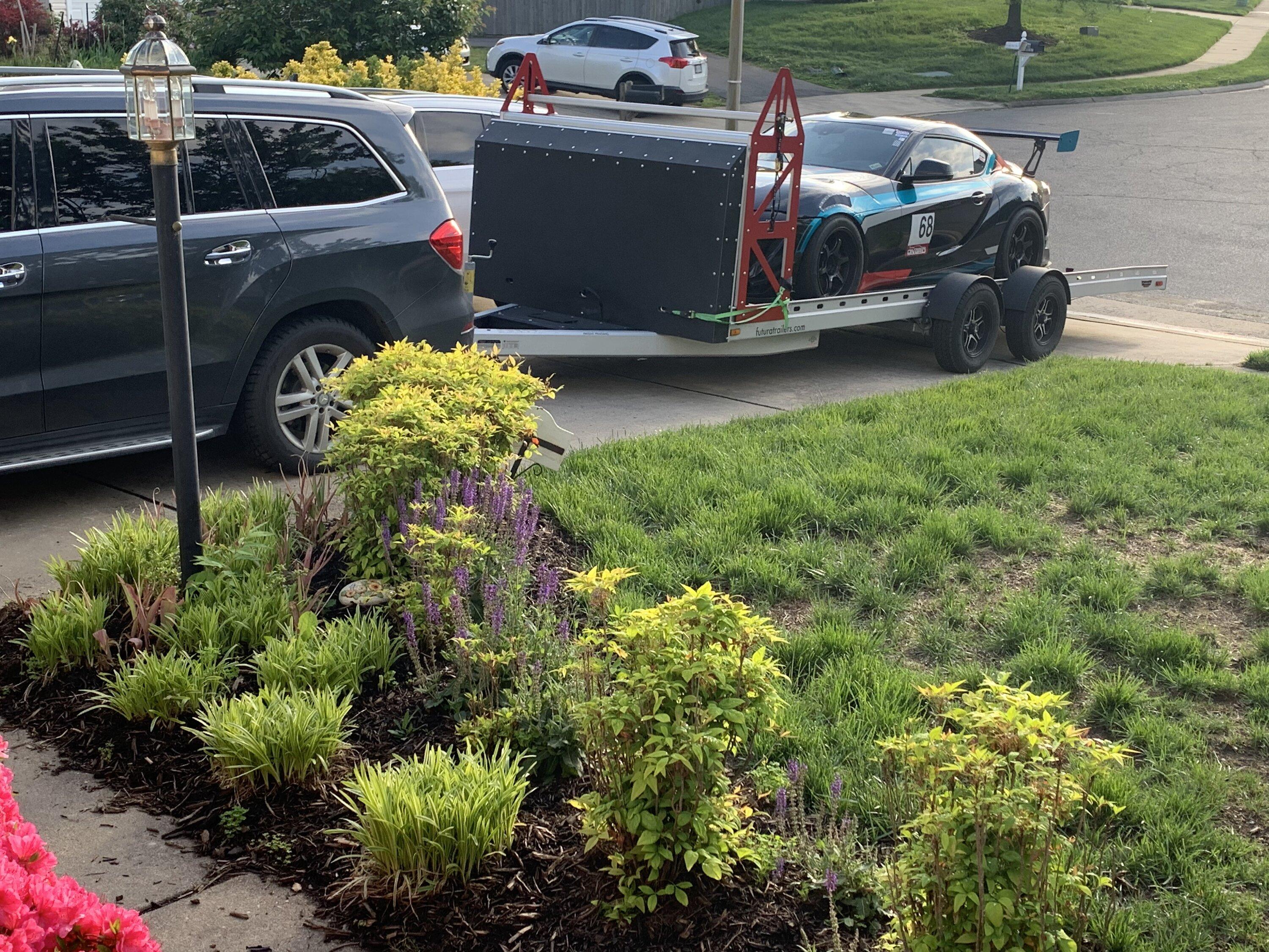

I tie down using wheel straps. Why are you wanting to immobilize the car's suspension?
Why have it working over bumps for thousands of miles if it doesn’t have too?
And I take it you cross your straps? If so, aren’t you putting a bunch of lateral load on your suspension? Do you use any specific straps to avoid scratching the wheels?
Rocksandblues
Bob
Sep 21, 2020
2,556
4,717
Virginia
Do not cross straps. Actually a big no no
Cloth straps go through wheels. They don’t mark
