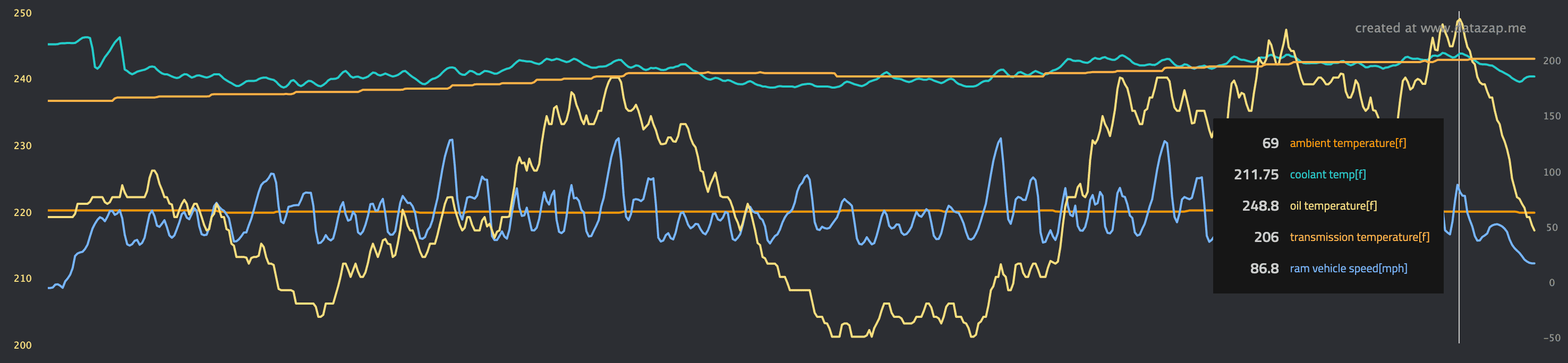

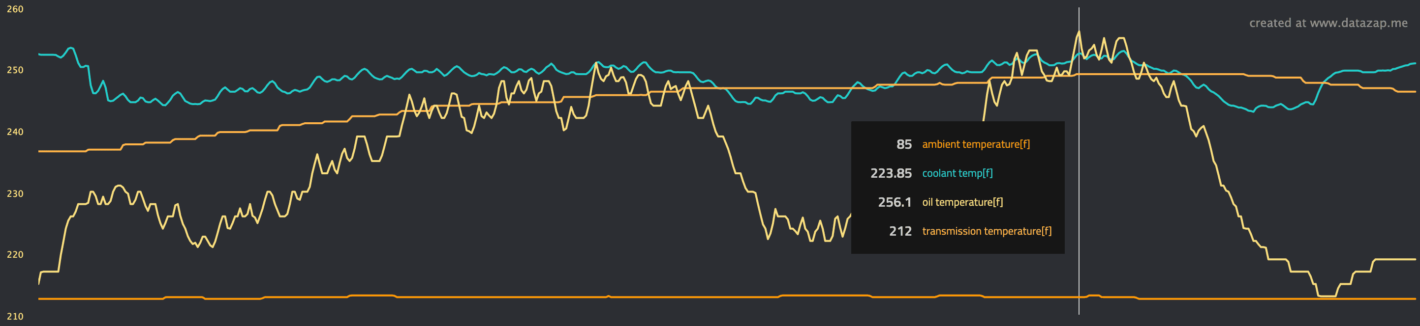

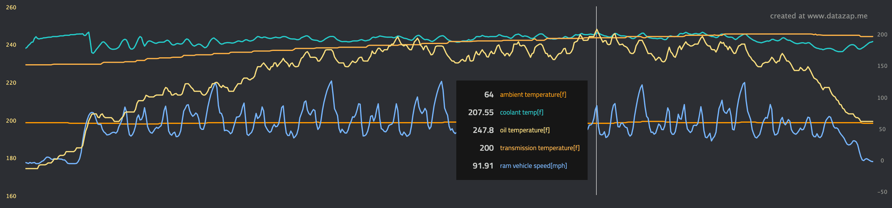

My last three track days:
Ahh thanks for that data! Ok seems about right then I guess. South Course is fairly technical and doesn't have the 2 long straights that the full course has, so I assume that doesn't help.
Thanks!

What sort of oil temps is everyone seeing on average while on track? I was at Pitt race south course the other day and noticed my temps creep up into 250-260 after a couple consecutive hotlaps according to Bimmerlink. It was high 70s to mid 80°F out. I typically see 220s in normal driving sometimes it dips into 230 and I've touched 250 a couple times on track but this was rhe first time I've seen it get much higher.
Also I'm running liquimoly 6600 0w-20 with ceratec if that counts for anything.
I'd have to go back to check my recent post, but these cars run hot. @razorlab posted the above info in that thread, putting my mind at ease. My old race car ran up to 280 before I built an oil pan for it and upgraded the oil cooler. It did fine. I'd imagine these engines will do plenty well at the higher temps, too. So far so good. That was all with OEM 20w oil. I've swapped to a heavier weight, so we'll see if it runs warmer. Fingers crossed.
Yeah I've heard multiple times that our cars run hot. I figured I'd see some sort of limp mode before it gets bad but still worrying when I see it creep up haha. I'm on 0w-20 as well, thought about going to Liqui-Moly's 5w-30 but I'm still on rhe fence. I know many people do just fine but idk. I'm curious if/when some sort of aftermarket oil cooler will be released in the market. I know we have one already but I'd imagine there would be a market for one with more capacity.
