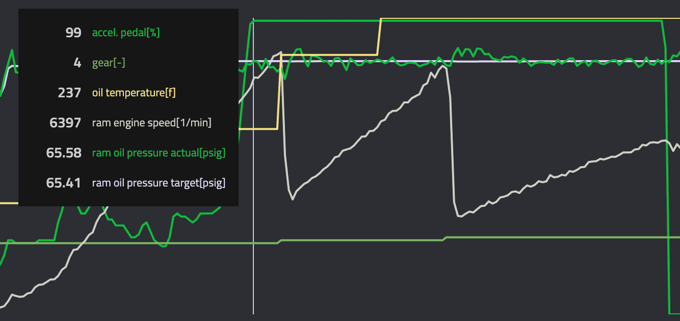

Is anyone logging oil pressure on track? I've had this interesting thing that at the beginning of the year, I logged 78-80psi or so at WOT on the street. Now for the last couple months I see mid 60's, but the target oil pressure is the same. I didn't log target oil pressure earlier in the year so wasn't sure if it was higher because of the oil additive I used for the turbo install or not.
Since target is the same as actual i'm not too worried but that data point that it was 10-15psi higher before has me slightly concerned.
WOT:

Meanwhile, I’m still looking at Bryan’s picture above trying to figure out what the difference between those two oil temp pics/graphs ?
8,707
17,057
ahah oops, I accidentally put the exact same screenshot for both. lolz
